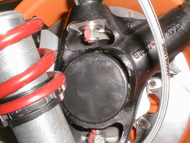

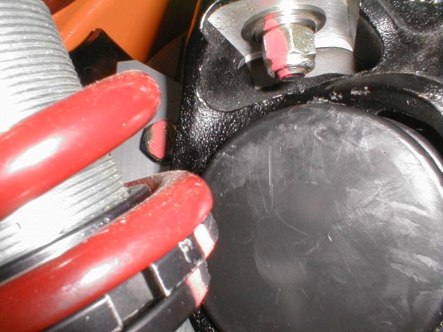

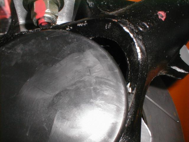

Workng on a seal for the SPF GT40 front inner hub. The issue is that the "tunnel" for the nut on the tie rod end intersects the void that we are trying to seal. I have a moulded plastic cap retained by an "O" ring. This still leaves a 1/4" or so by 3/4" open into the hub area. The cap would keep most water and grit out of the bearing area but it is not water tight. One could use some waterproof tape and seal off the small area that the cover does not seal. Pictures follow.
What do you guys think? Would this help or is it not worth it?

re the Hub Seals: Would it be possible to seal the gap with RTV or silicon after the cap is installed? If so would probably be OK, no?

That will work, I just assumed some people wouldn't want to do that. If there is interest in the hub seal I will continue. We will use them on our chassis and use a "low adhesion" RTV to seal the gap.
I already have that.....made by Caplug. Steve, the 'tunnel' is the opening I described earlier, and the only way to enclose this area is to make a mold and produce them. The cost to mold the part is small in comparison to making the mold. Guessing at what I've paid before ~ $1400-$2000. I haven't been able to get a firm quote because I still need a drawing to be quoted. I feel this 'fix' should fall back to Superformance because of the cost. Meanwhile keep them dry.
