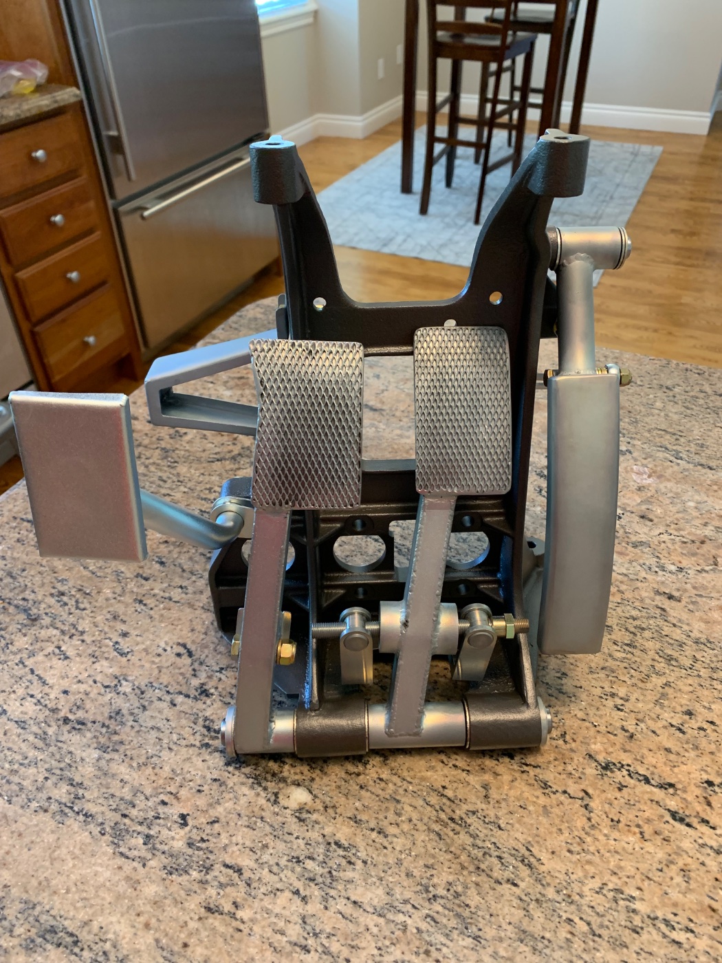

Sorry Billy, I'm pretty sure Rick is right.
Rick, are the LHD SPF tunnels offset to the left (same as RHD)?
If so, this would put the footrest into the kick panel on LHD.

Yes, the LHD cars have the tunnel offset to the right to allow a wider driver's seat, but even then, the sponson interferes with a dead pedal so a no-go.
