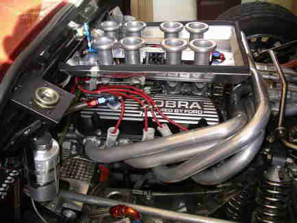

Attched: what it look's like. I have K&N filters in each body duct a-la Bill Bayard. So far so good.

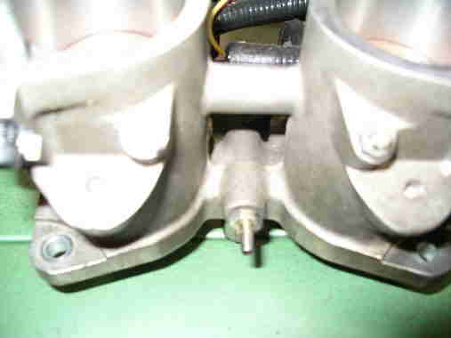

Lynn, (and Jim C) you're right about the MAP. I have a vacuum pipe running from each of the 4 twin throat throttle bodies to a plenum chamber in the valley. The IAC is also connected to this plenum, and closed loop idle works great (butterflies are fully closed). Vacuum hoses from this plenum also connect to the fuel pressure regulators for their reference (nominal 44 psi).
I ran in TPS mode before, and MAP provides much more consistent and cleaner running. I can't say I notice any improvement in throttle response at the higher rev ranges, but the slow 'putz around town' and idle performance is noticeably better.

That is really cool. The lines I have seen previously that were used to provide a manifold pressure reading for the EMS didn't look large enough to supply enough air even for idle. What size lines are they? Do you have any pictures of the setup? I'd love to take a look at it. I wondered about losing the (accurate) manifold pressure input when the IAC was open, but it dawned on me, "who cares, you're in idle mode on closed loop."

Lynn, I use 1/4" vacuum hose to the plenum, MAP etc. Attch. is the only picture I have, not very good but it gives the idea. I also use 1/4" steel pipe (inside) that connects to the IAC motor with it's own neat little air cleaner, all hidden inside/under the rails/throttle bodies.
