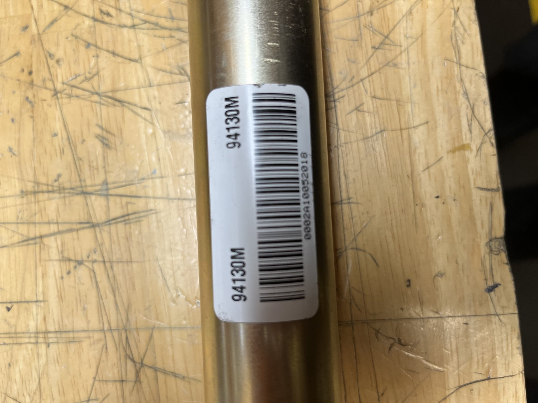

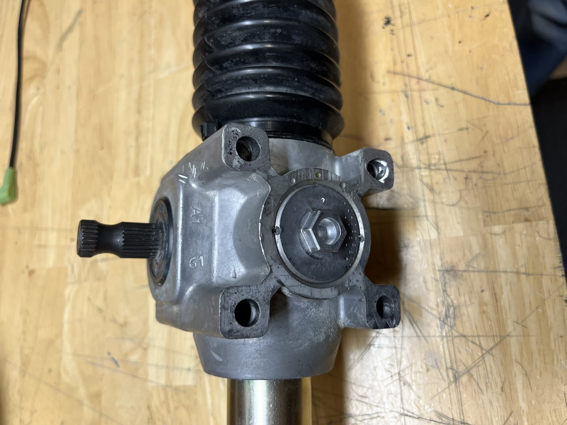

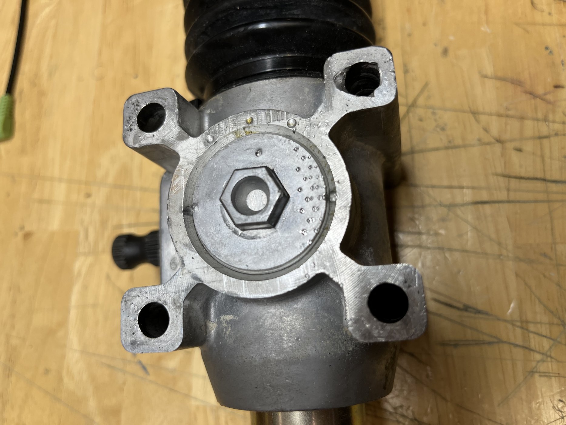

One issue noted was the steering rack was very tight making steering inputs jerky due to the tremendous effort required to turn. Issue was traced to the rack itself after disconnecting everything else connect to it.
Does anyone know what rack this is that is supplied by RCR and whether the effort is adjustable? There is an adjustment bolt underneath with factory punch marks but perhaps it was overly tightened?
