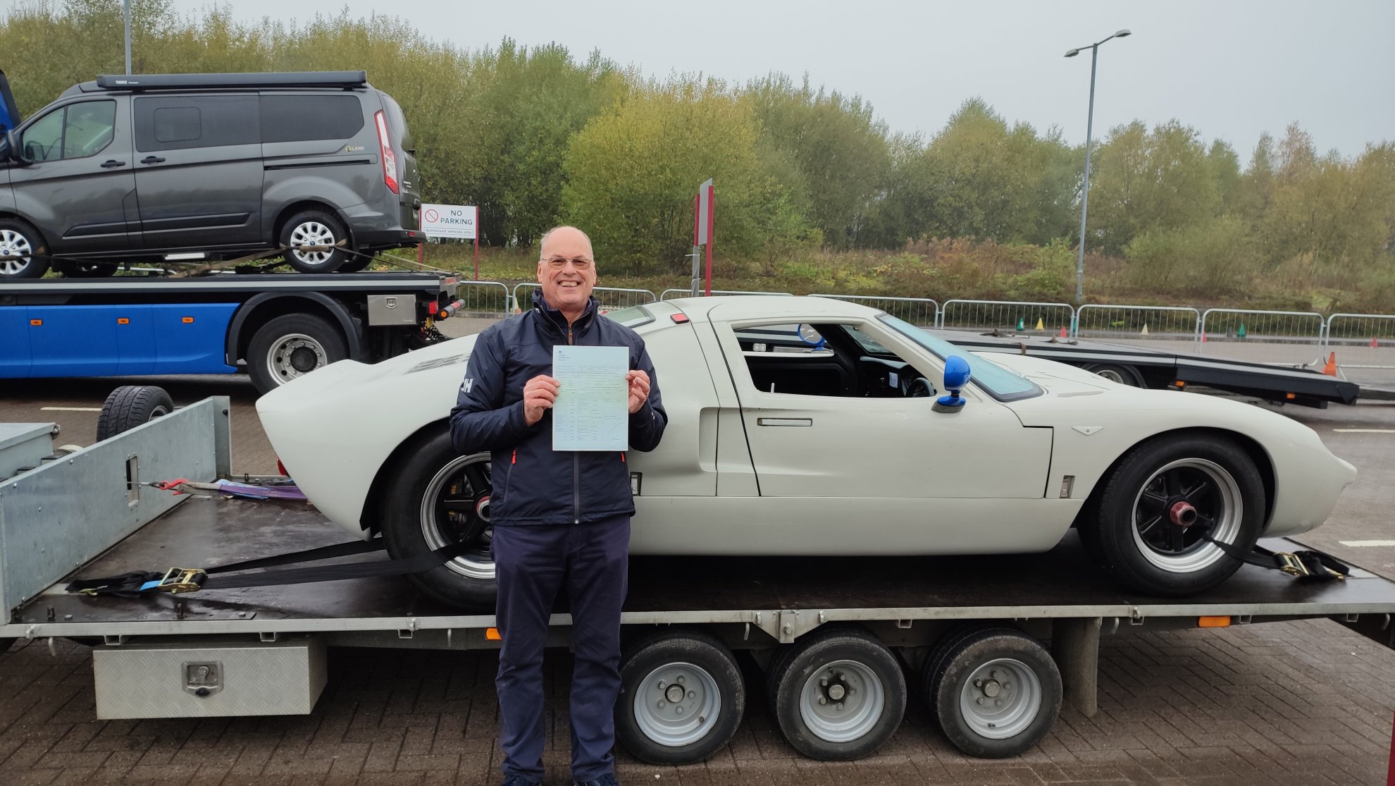

Just got back from the Oldham VOSA Centre. After a few hiccups Don Anderson jumped the last two hurdles to get his SGT through the IVA test. A final check of emissions and handbrake and his car passed, Here is a pic of a very happy Don holding aloft his certificate with a major milestone completed.

Very well done though, a great feeling isn’t it.
look forward to seeing it finished.
Thanks guys, it was a bit of a squeaky bum time waiting for the emissions to sort themselves out, but we got there in the end. Now on to get it painted, first three guys I phoned said could not do it till next June at the earliest!!!! Will see what else is about.
