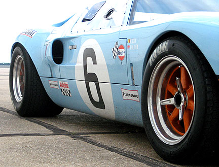

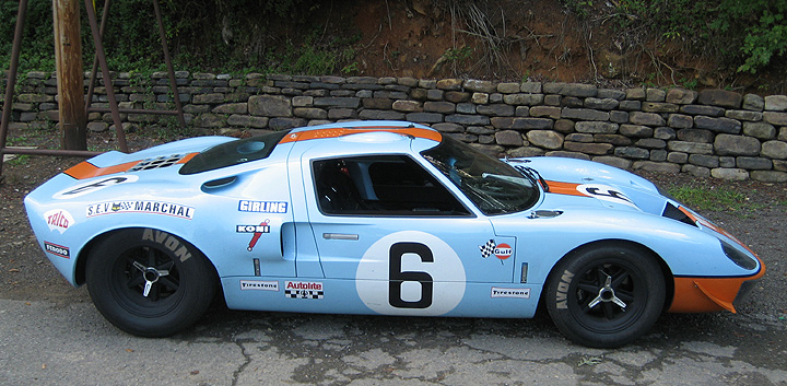

I have used Goodyear Billboards, Hoosier TD's, Avons and currently old treadeded blue streaks. They all pick up and through stuff. The Avons were by far my favorite as the ride was as true and smooth as my M3. If you have the option and the $, especially on an SPF, go with the Avons!
My wide body SPF is 76" wide across rear flares, and I run Avons on 15" x 13" rears for the track and Michelins on 17" x 13" for street. The Avons really do pick up and throw a lot of rocks, comparatively speaking.

I too love the wider rear. I have three sets of wheels...the 15x14" and 15x10"for running full race Avon tires. The second set is the stock set running Avon DOT tires and then the last is a stock set with a 2" offset so I can run the Avon DOT yet still fill out the rear flares.
Even with the stock rears (15x12) and standard offset it does not look too bad with the wider rear flares.

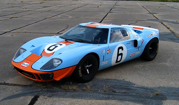

I am quite certain that Superformance has molds for three separate tail clips. The standard size is most typical and is included in the base price. There are two wider versions. The subject becomes unnecessarily confusing because of the names they assigned to them. There is no name for the standard, the slightly wider version is called narrow body, which most would assume is the standard - but no - it's the smaller of the two wide bodies available. The third body clip, or more specifically, the second wide-body is called extra wide-body. This information is provided with a high certainty of accuracy since it originated from the mouth of the president of the company and conveyed to me directly. The occasion and purpose of that conversation was due to the fact that I just purchased a GT40 with extra wide-body. I am concerned about the wheel, tire sizes, and limited tire choices available in the 15" size. However, there are several individuals gathering viable options, and I feel confident of a satisfactory resolution. For those who may wonder, I was driven to wide-body for these reasons only: mean, nasty, menacing, and bad as# appearance. I was less concerned with the other possible down sides mentioned on this forum, and had heard most of them from others.

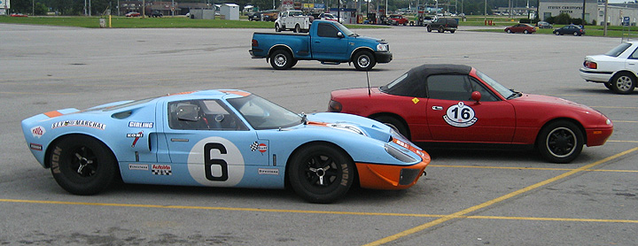

The standard Superformance rear MK I clip is the "wide" (i.e. 1967 style) with the option of the later "Gulf" (wider) style clip. The second option is the early 1965 type "narrow" clip with the stacked taillamps.
Some photos make it hard to determine if the rear is the standard or "wide" type. The standard rear uses 10.5" width wheels, the "wide" uses the 12-14" type of wheel.
The quickest way to tell is how flaired the sill covers are. The standard sills flare out about 1.5", the "wide" is over 3"
I am quite certain that Superformance has molds for three separate tail clips. The standard size is most typical and is included in the base price. There are two wider versions. The subject becomes unnecessarily confusing because of the names they assigned to them. There is no name for the standard, the slightly wider version is called narrow body, which most would assume is the standard - but no - it's the smaller of the two wide bodies available...
The standard body is the medium-width of the three available. The wide one is wider, and the narrow one is, you guessed it, narrower. :laugh:
