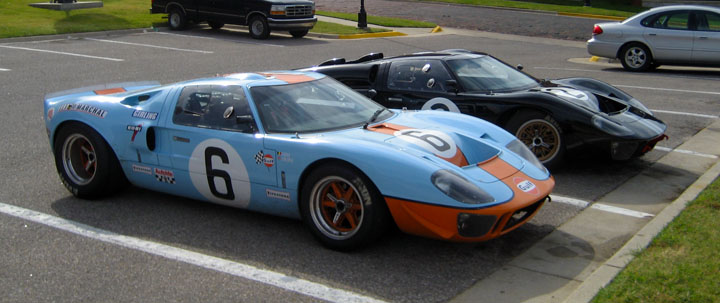

Wide body MKI with MKII...
15x14" wheels on rear.
