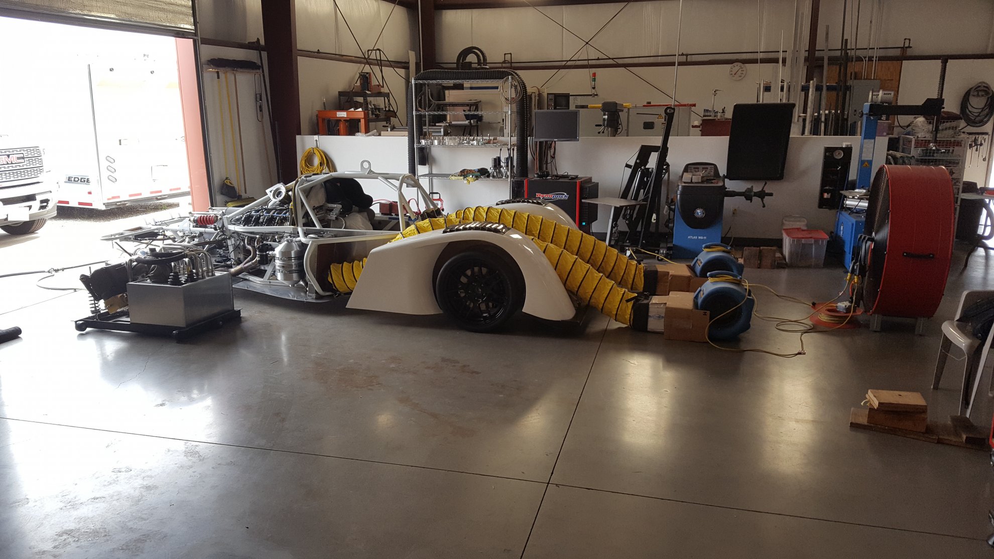

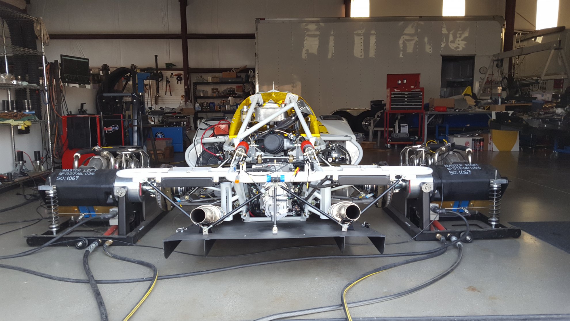

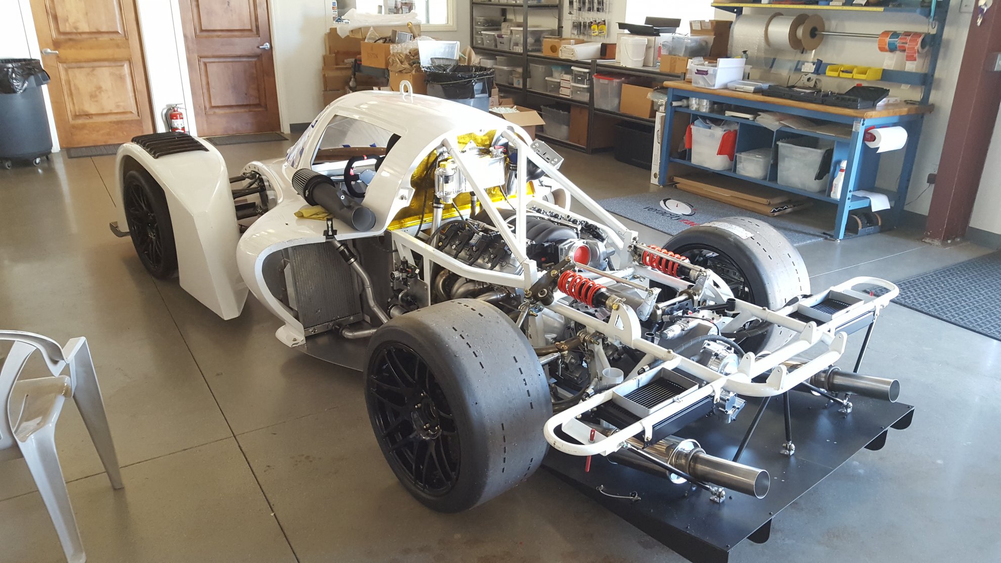

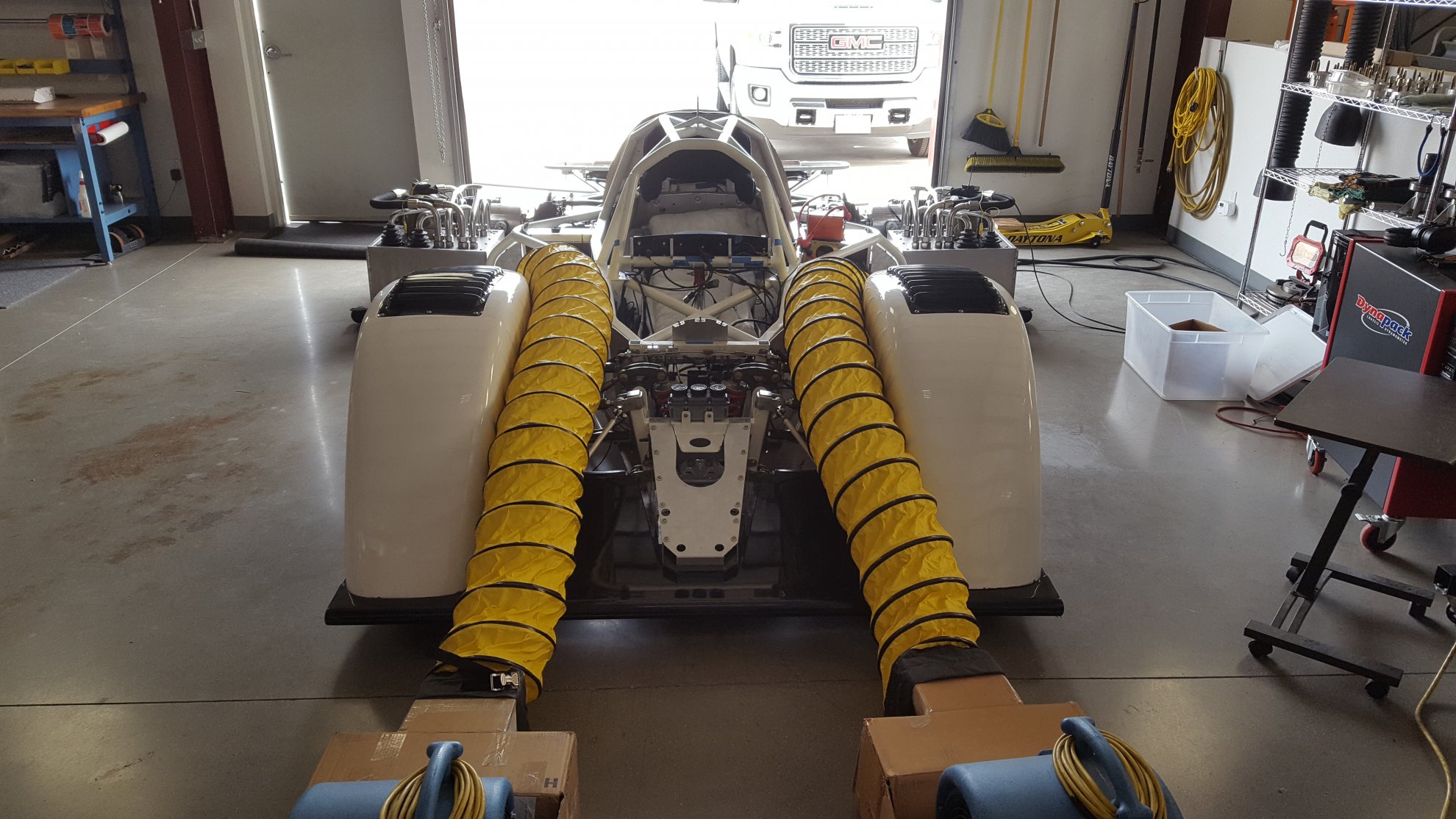

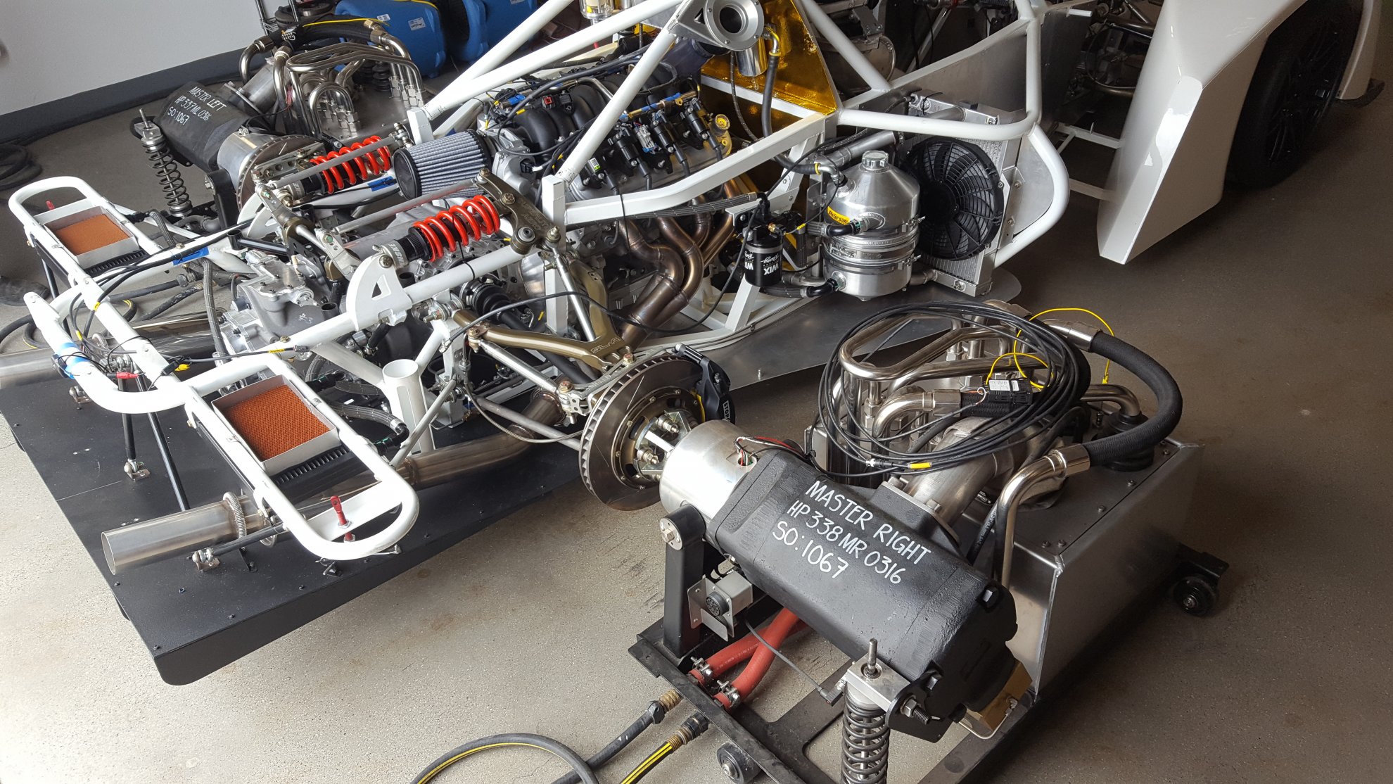

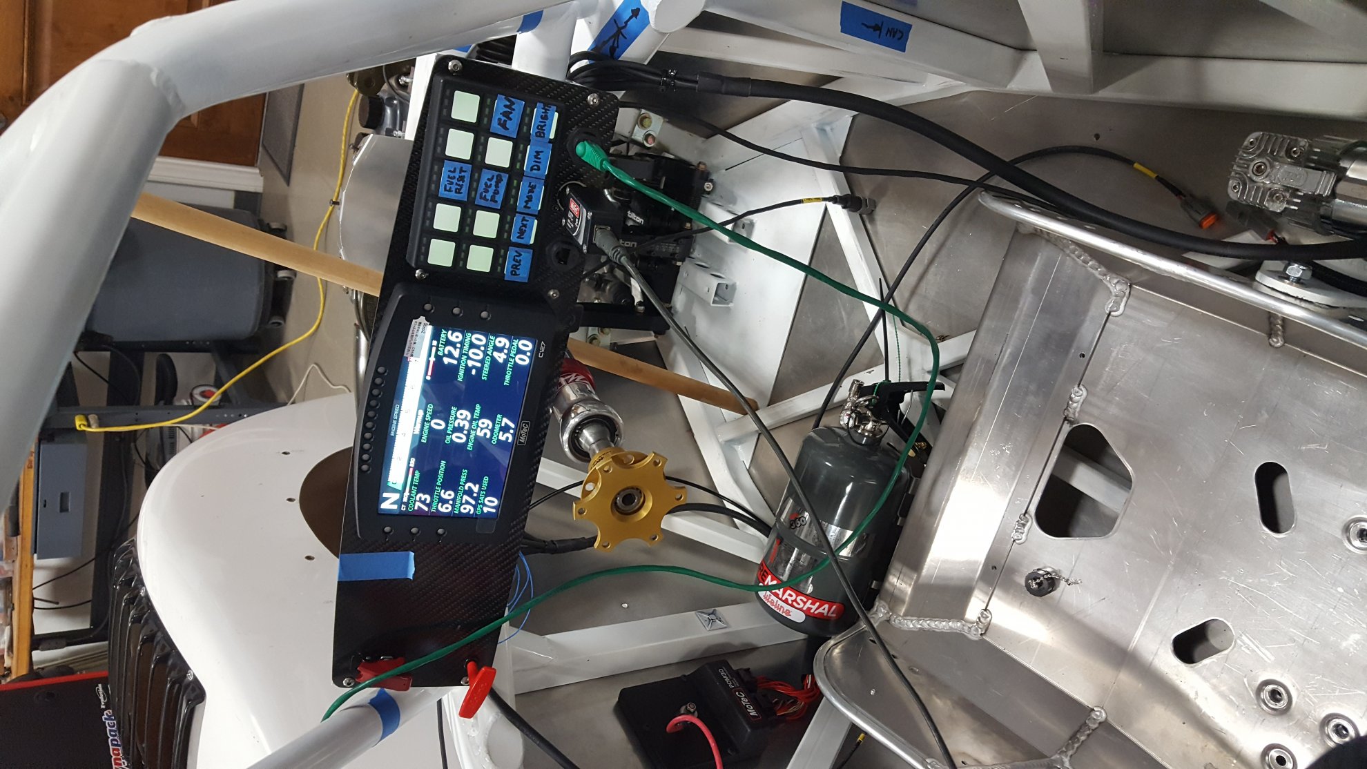

Hey everyone. My Aero is almost ready for the track! It has a stock GM Performance Hot Cammed LS3 (now broken in) mated to an Albins ST6-M. I am using all Motec for the electronics (C127 Dash, M150 ECU, PDM30). We should have the shakedown day in the next 3 weeks out at Buttonwillow Raceway. I'm sure there will be some teething issues but we look forward to them. Here's a few pics of the car in the shop before the wiring harness was done and then on the dyno for break-in. This car is going to be a hoot!
