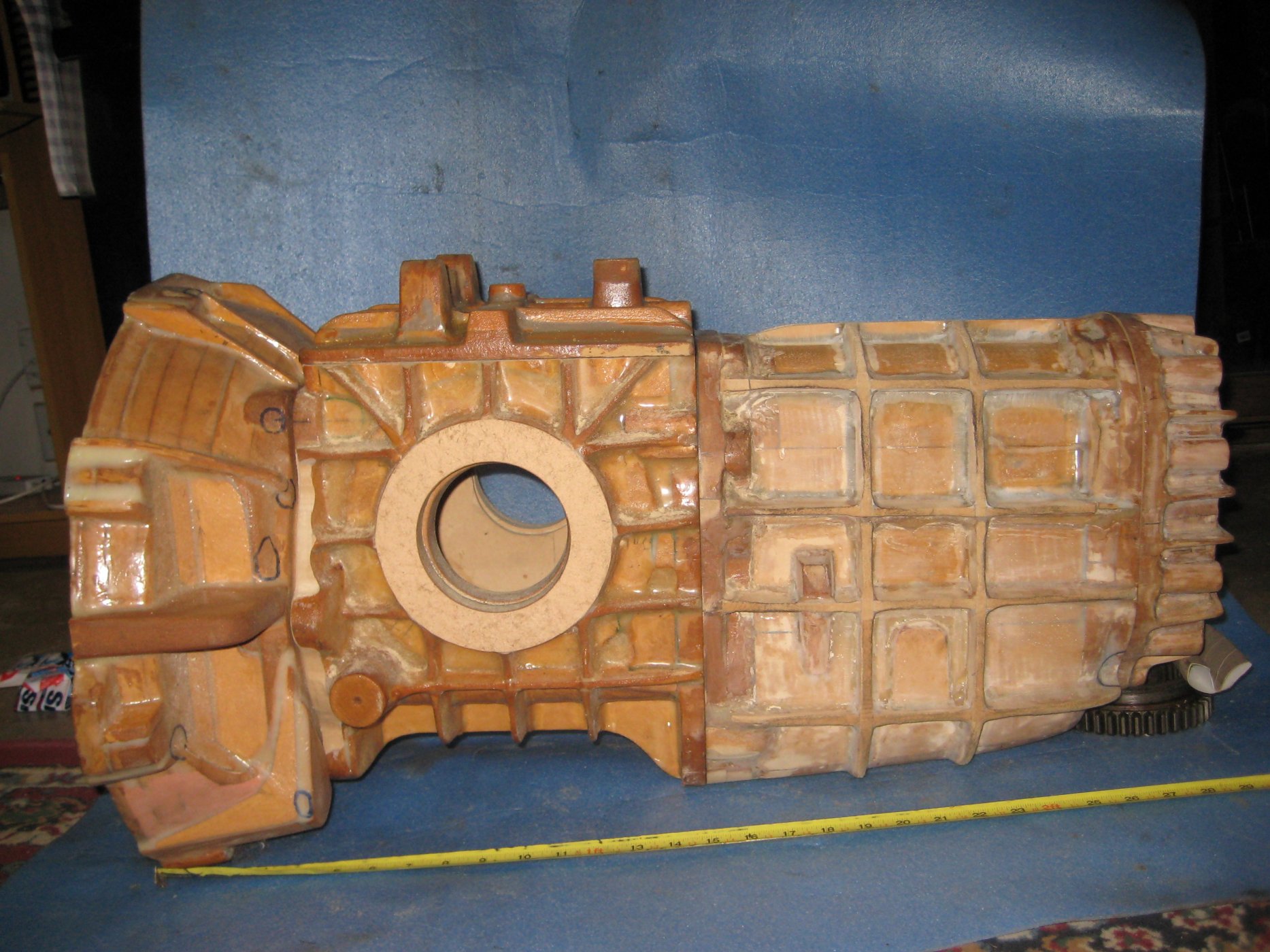

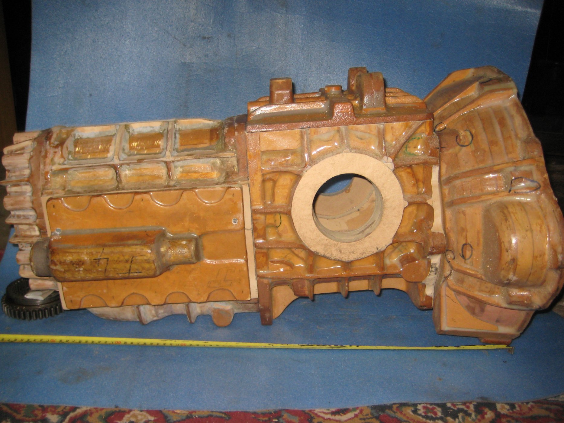

I think I have an unmachined transmission case, and also a differential case if you are interested. I believe I still have all of the blueprints also. You can PM me.
