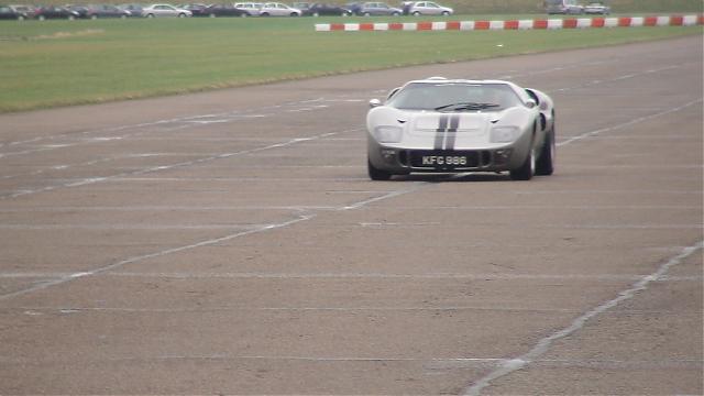

spent all day testing on Bruntingthorpe proving grounds today, with Chris and Martin and the new ZFQ gear box fitted to a MK 2 GT 40. we had a good 5 hrs on the track. speeds in excess of 150 mph.
the new box is super smooth. changes up and down the box like silk. gear changing is slick fast and positive.
gear ratio are spot on for fast cornering and final drive was fantastic for the 2 mile straight at Bruntingthorpe. Chris and Martin thanks for the drive and over to you Chris and Martin

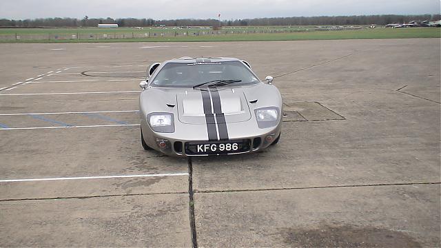

sorry, I do not know what the HP or torque of the car is,I was just there for the drive, but their was a lot of it .Chris or Martin will come up with all that later i hope

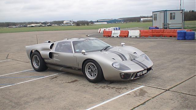

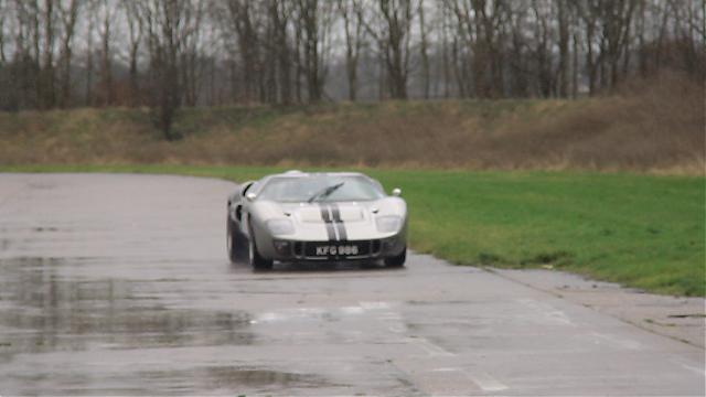

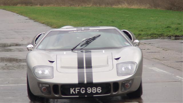

more pics
