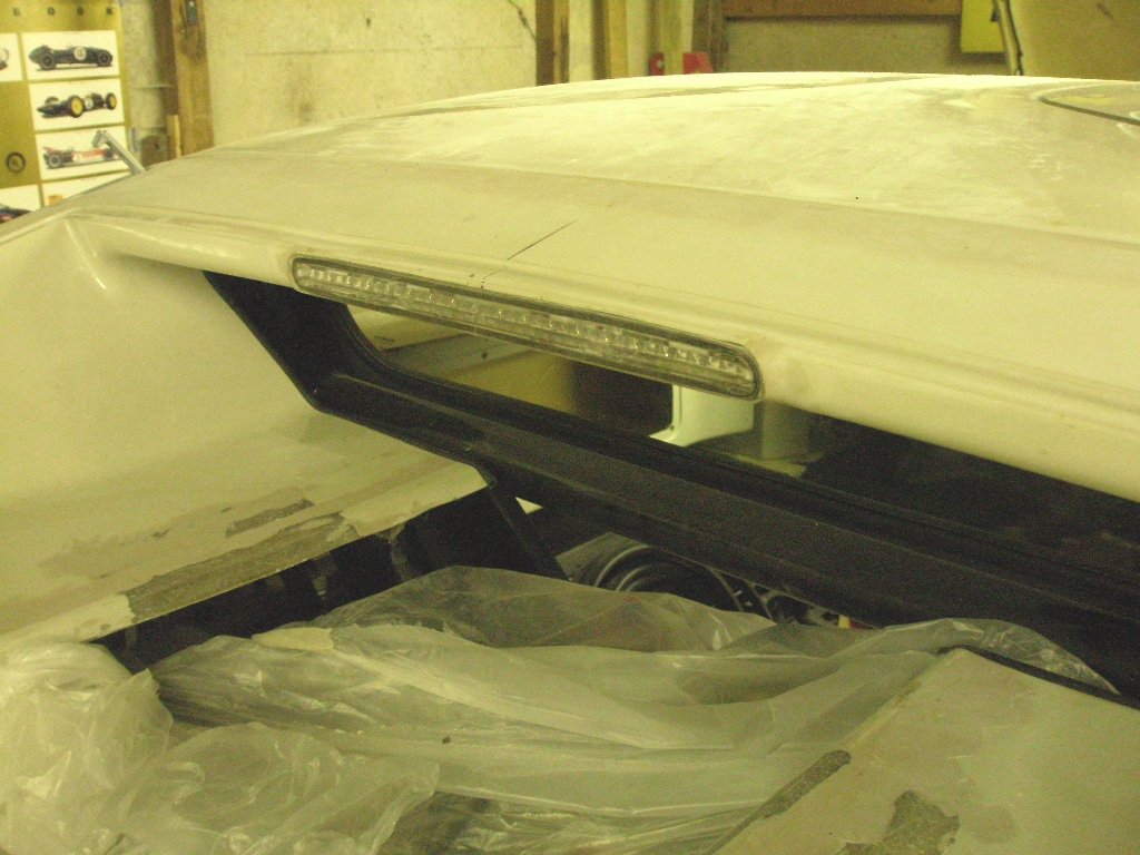

you mean something like this...
Further details on page 14 of my build log, but it's an LED unit off a late V/hall Vectra
Andy
Andy

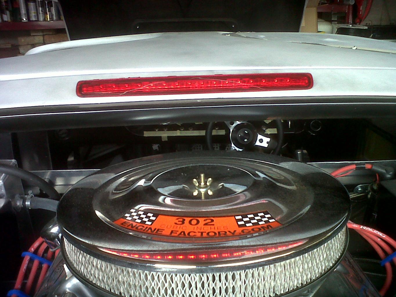

Hi Guys
I did exactly this with mine using a Narva spoiler LED brake light strip.
I cut an opening in the top section under the window and fit it into the recess.
Dimi

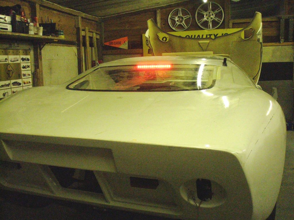

Hi Andy
Got my Vectra brake light today, but not attempted to 'hack' the bodywork,.... just yet, how did you make the hole for the light, did you grind it out from the front, that is, where the light will enter the body (actually to the rear of the car)? That part of the body is a 'c' shape in section.
the pic just shows the brake light sitting on the roof, the location of the hole will be in the black part below.
regards
keith

Hi Keith,
I opened the hole from the outside until the light unit would just fit. If I remember correctly I had to take a couple of mm of the top edge of the lens to clear the rear screen
The following sketch shows how I retained the light. The M5 screw can glued onto the light unit using an epoxy adhesive, but I prefer to use a windscreen sealant such as Upol Tigerseal (available on Ebay), as it also great for glueing brackets direct to fibreglass.
When you make the retaining bracket, I would make it as longer than the light unit, as there is a loss of stiffness in this area when you cut the hole for the light. I actually added a foam beam to this area, about 600mm long. Without it, it was a 2 person job to open the rear clam, as the clam would distort if only lifted from one side. Now I can do it on my own.
