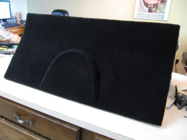

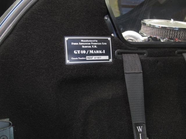

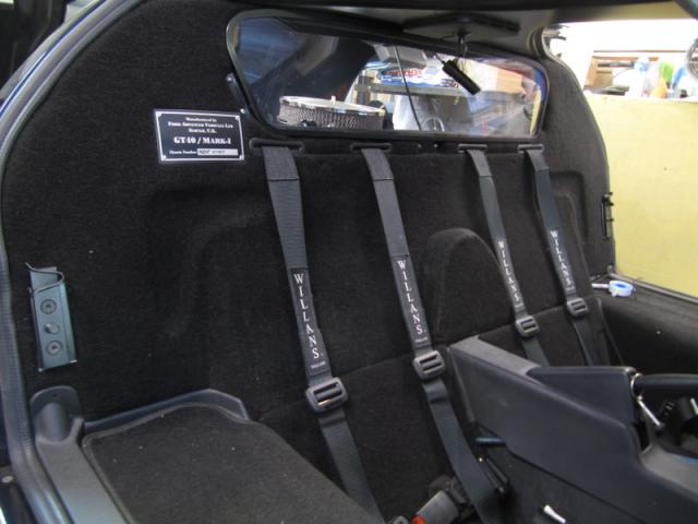

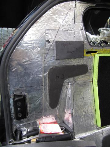

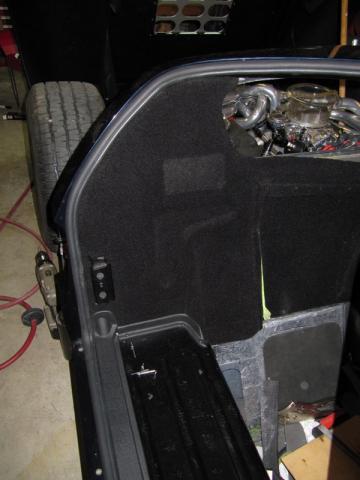

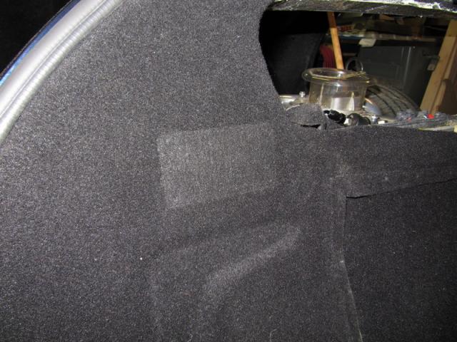

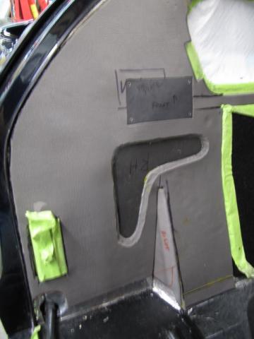

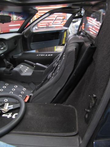

I used the products from Second Skin and I'm very happy with the outcome. Sound is such a subjective thing that I'm hoping some day to compare two similar cars, mine and an unmodified car with a sound meter.
After removing the original carpet I applied their Damplifer Pro (like DynaMat) to most surfaces on the interior side of the car, I then glued their Luxury Liner Pro on top of that. Then I glued new carpet that was at least twice a heavy as the original onto the Luxury Liner. On the motor side of the firewall I added a piece of their Motor Mat Pro (heat and noise insulation) I painted the aluminum (the side facing the engine) black. It’s amazing I don’t notice it at all.
The Luxury Liner Pro has two layers. The thin part (1/8”) is heavy and reminds me of vinyl tile except more pliable the second layer (1/4”) is a heavy closed cell foam. In all I maybe added 50lbs. to the car but for me it is well worth it.
Some day the sound meter may make a liar out of me but until then I’m happy. One big thing for me was that I wanted to keep the kidney shaped indentation in the firewall. Because of this I had to learn how to mold (form) carpet. I not only did the indentation but the edges as well.

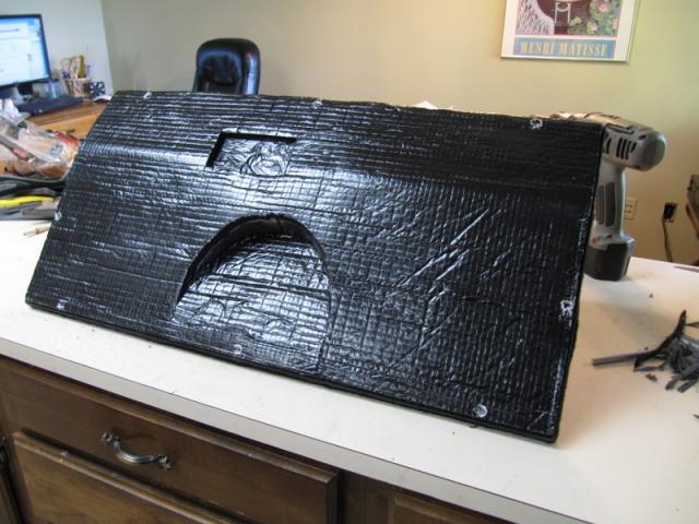

I used the dynamat on all of the interior surfaces.
I have even attached it to the roof section under trim. Additionally on all interior door panels to stop the drum..:idea:
Guessing I would say that I have reduced interior noise by about 40%...:idea:
Cost in total was just over $200

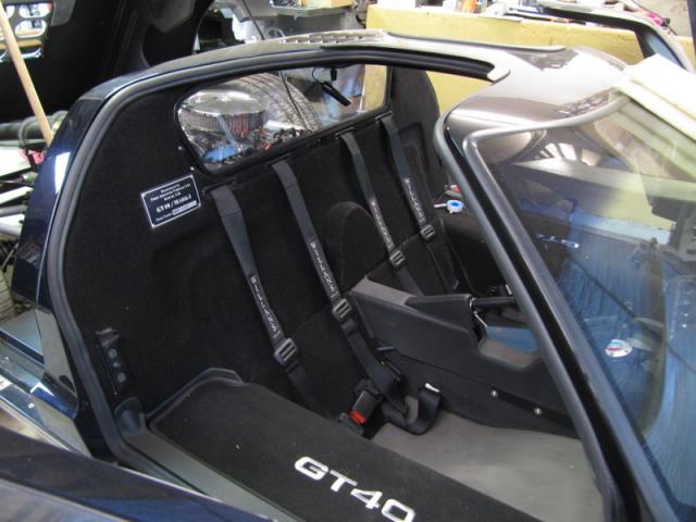

Thought I would post a few more pics now that the interior is almost done. I made a quick 2" piece of foam that sits in back of me so that me reach is correct. The only problem now my knees hit the bottom of the dash. Might have to make it more of a wedge shape, 2” at the top 1” at the bottom. I also added over an inch under my butt but it’s tapered as it goes forward and is gone by the time it gets to the highest point.
