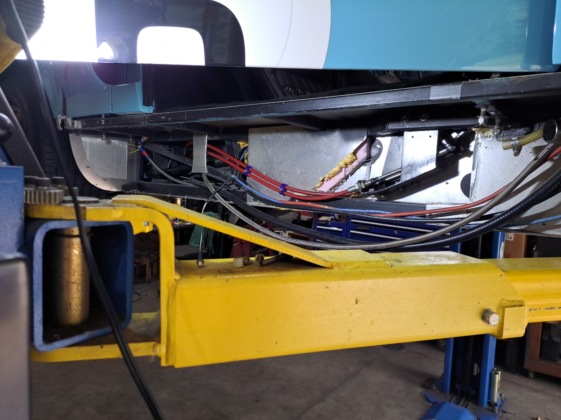

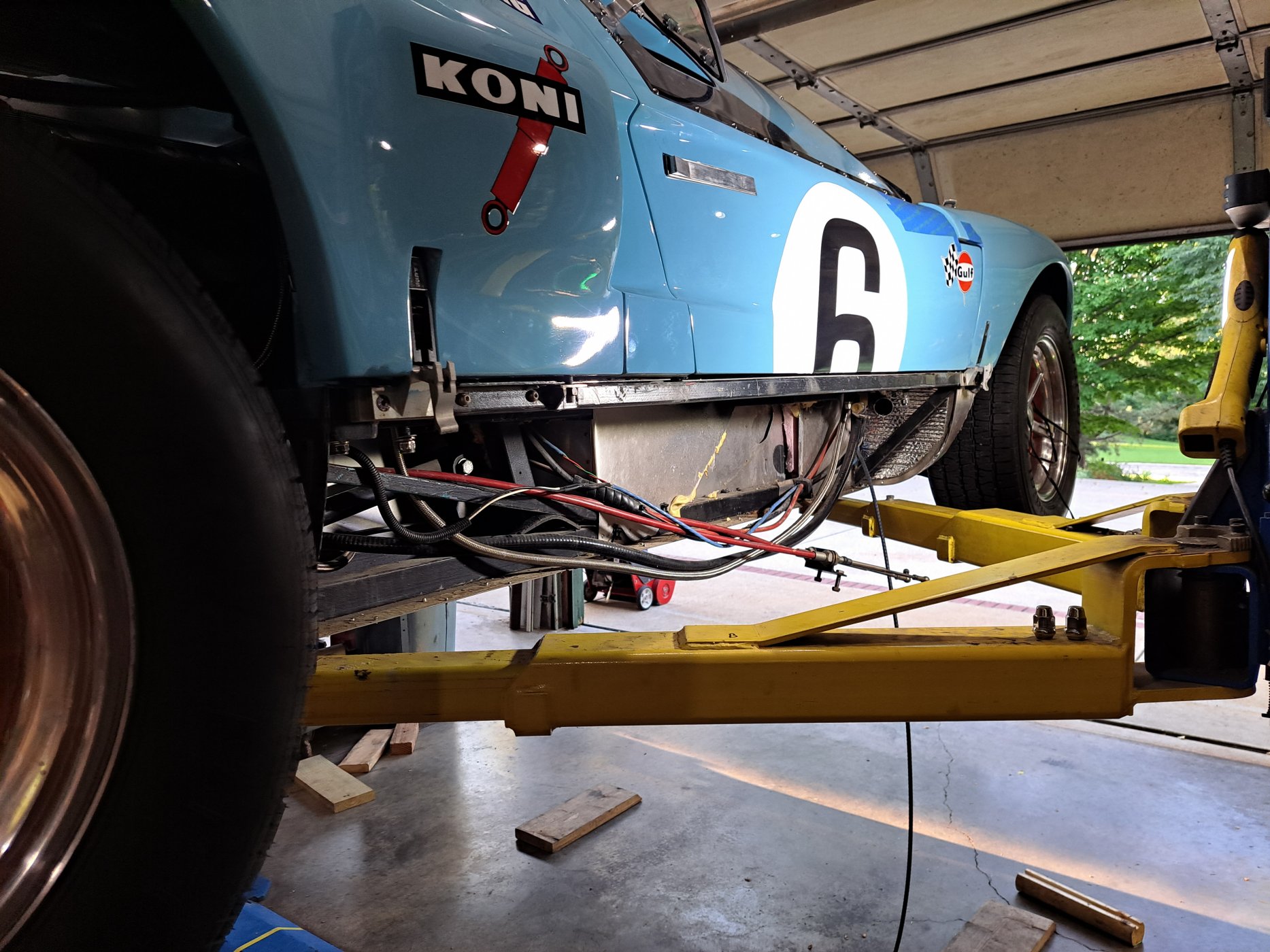

If changing the throttle cable, use the old cable to pull the new cable through the side panel else you will definitely have to remove the side panel! Hope that made sense!
These my help if you need to replace the hole cable which I recommend, you need to go to this point to get to it . This is a GTD RHD !
