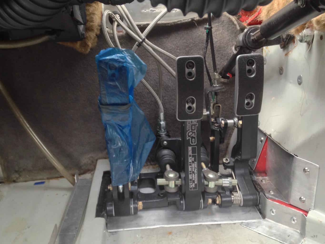

Hi, I read the thread regarding stiff throttle recently and my GTD is also pretty stiff throttle which is somehow OK for track days as only on/off but not comfortable for street. Extremely stiff at the beginning to open the throttle, so not really smooth.
Although I'be changed the std. GTD pedals to Tilton box as attached, but no improvement so far. Now I need to look into the replacement of the throttle cable.

Measure the cable and order a custom cable from Pegasus Racing. They usually ship the same day or the next day at the latest.
Yuji, I would check the return springs on the throttle. If they are too stiff, then the pedal will be hard to push. The problem would not be fixed with another cable. This is the problem I have with my Borla 8 stack fuel injection.
The second issue that I would check is the motion or lever ratios. You want to have the pedal have a full motion to get the throttles wide open. If the pedal only moves a small amount to get full throttle then the pedal will feel stiff.
Another consideration is the bend radius of the cable in different locations. A tight bend radius will cause increased friction and make the pedal seem hard. Be sure to get Teflon lined cables.
Simply replacing the cable with a new one with the same throttle springs, motion ratios, and bend radii won't solve your problem if the above are not correct.
Bob Woods
Tornado GT40 in Texas
I agree with Bob ,springs can be to heavy because the TB are not as good as they should be to come home on their own.
Change the bellcrank that the cable is attached to.
Longer arm rolling on the back of the pedal and short arm attached to the cable.
It will increase your throw which makes it easier to drive in lower gears.
But you will have to work out the bell crank, place to start is how much cable travel from closed to full throttle, this is how far the short lever on the bellcrank has to travel then work back.
My bellcrank is maybe 2:1. it made a difference.
you will need to remake cable bracket if you change the bellcrank.
Model it with cardboard and pins if you don't have cad.

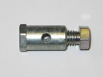

Be very careful how you route the cable in regard to the exhaust pipes and cover this section of the cable with heat resistant reflective covering. I also carry a spare inner cable in my car and a couple of solderless nipples in case the end of the cable comes off. I put two nipples at each end of the cable in case one slips.
I got my cables and spare solderless nipples from Venhill.
