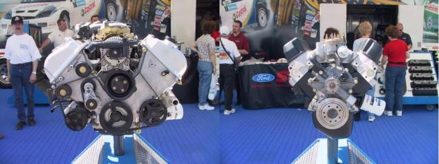

One of my favorite diagrams. There is one that has the 385 on there too but I didn't turn it up with a quick search. The modular engine is the largest of all of them and the little 289/302 is the winner for compactness.
The current Ford Motorsports catalog has some dimensions of the SB series, the 385, and the mod motor. Look on page 58-59 for lots of interesting stuff on the Ford engines.
http://www.fordracingparts.com/2010-catalog/default.asp
The mod motor is 30 inches wide - four inches wider than the 385 series engine which is 26" wide. The 351 motor is 21 inches wide, so the 385 is "only" 3" wider. The 385 is 4.5" longer than the 351 though. Mod motor wins the pig award for sure.
Ford Racing Performance Parts [2010 Catalog]
Oh but what horsepower that can be made with the Supercharged MOD (5.4 L) engine...so easily. However with the lightweight cars we are talking about here, I'll keep the 450-600 Hp and trade the 700-1000 Hp for awesome breaking, suspension, and big low end torque. I know placing a 5.4L in a SPF car is next to impossible, but someone would come up with a way to do just that. The dream is to go fast (200), but the reality for the most of us is slower. Great Diagram!

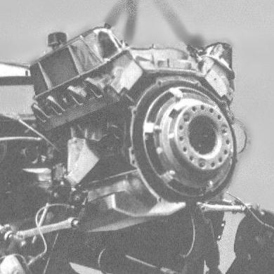

Looking at the diagram makes me wonder what determined ground clearance in the Mk II. What size and type of clutch did they use? And what was the flywheel diameter?

Bellhousing tied to cast dry sump oil pan , bellhousing had clutch slave attached to it...Internals different, T44 tranny to bellhousing different. Dry sump had pump built into the front cover to minimize oil lines and external pump (why I told you last night to do w/o original dry sump will cause problems with sump pump and lines ect and why I chose route I did.
Take a look at the ERA website for some pics that better show.

The sump in that pic doesn't look right to me.
Look as I suggested in the ERA site and see te FE there.
If your concern is bellhousing clearance to ground using the small bellhousing from Olthoff (see my pics) won't cause a problem. It even has slots to allow tranny removal w/o removing bellhousing from engine.
Steve
PS: Where did you gt the pic?
Photo is correct, first 'FE' cars were 'wet' sump, not converted to dry sump by E&F until after 1966 Daytona debacle....have the same pic here in several publications..
