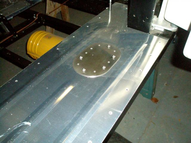

a little bit of work done today. Still waiting for the chassis to go off to the coaters so thought I'd try and patch up the gap in the floor in between my lowered seating areas have been welded in by Tornado.
I start making a cardboard template but quickly realised that the 2 rails that the panel will sit on are very narrow and the head of my rivet gun is too big to be able to rivet along the rails.
Any suggestions on another way of patching over this area?
Trev
I can probably get 2 or 3 rivets in at the top and bottom of the section along the wider chassis rails and then use glue/sealant along the centre narrow rails
Do you think this would hold ok?
Trev
Trev, I think what you have drawn will hold it very well. There should be no pressure on it.
However, as Andy has said, you could grind the head down on the riveter. They are quite cheap to replace.

....the head of my rivet gun is too big to be able to rivet along the rails.
If it will leave the gun with enough purchase on the rivet mandrel, perhaps you could extend the nose of the rivet gun with a short piece of metal tubing, ID =~ mandrel diameter, OD =~ rivet head diameter. Or a combination of that and grinding the nose of the gun.
Trevor,
not sure how deep the obstruction is to your rivet gun but I have got 'round similar situations by stacking small nuts (3/16 or similar ) over the rivet shaft. You can use as many as you need so long as the gun grips the shaft. Worked for me !
Mike.
The seating area means that I'd need to find another 3cm's or so in height to clear it. I like the idea of using something like a stack of nuts but would this ensure the rivets are set properly?
I don't mind grinding the nose of the gun down. There seems to be enough metal casing around the nose that I can get rid of to make it fit if that's the easiest option?
Trev
Made the additional piece of floor aluminium floor tonight which looks much better. I also spent some time grinding down the nose of the rivet gun. I am very pleased with the result, gun works like normal but can now get into the gap to fit the rivets along the narrow rails.
Thanks for the tip guys
Trev

Plan at the moment it to get this floor piece drilled and cleco'd. Then to remove it and get the chassis off to the coaters with the front floor section in situ. Andy is confident that the sealant won't reach any kind of melting point so will stay in place and the coaters said they will do the best job they can to make up for the original mistake.
Hopefully the chassis should be sent in the next week and will take a few days to recoat. Once it's back I am then going to rivet in the wheel arches, new floor section and rear bulkhead and start fitting the cooling pipes that arrived at the end of last week.

Finally the extra floor piece is drilled onto the chassis. Initially this looked like a pretty straight forward job but the bars along which the new panel had to be drilled into proved to be a real pain in the backside.
However a couple of nights work and 5 drill bits later all the holes are drilled and the chassis is now ready to be sent back to the coaters to be redone.
