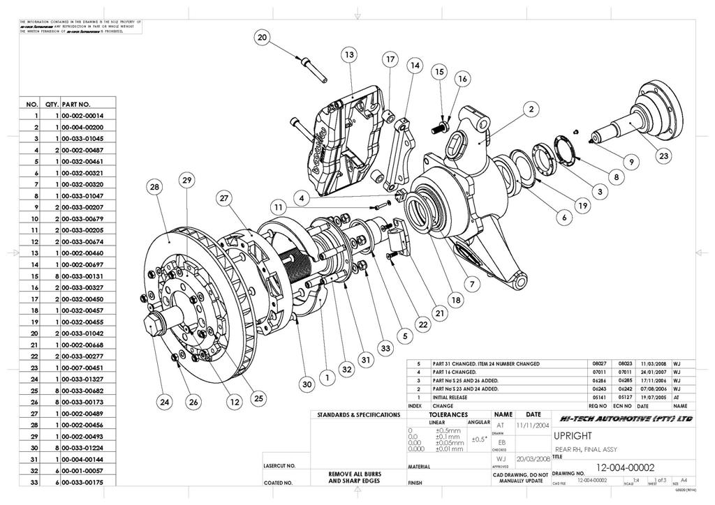

Hi,
if you need to be as per"original" why not using the spf option who have integrated in rear upright hand brake system?
seems to be based on Mercedes- Volvo corvette hand brake , would be manual operate by cable, or you could use electric hand brake cable motor.
Paul
