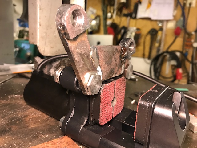

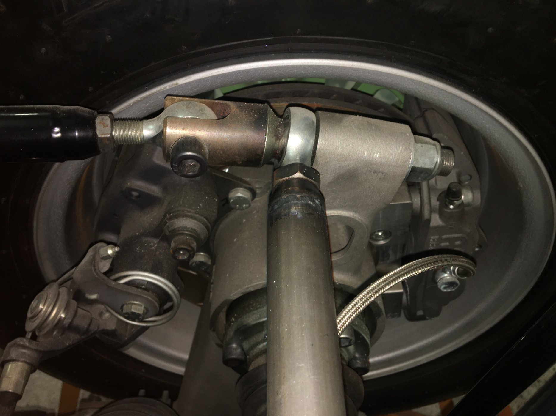

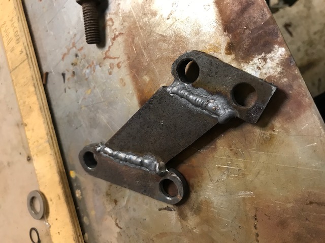

Here are some pictures from my innstallation, the bracket in the making and so on. It was a bit tricky to fit the bracket had to be build piece for piece and lot of grinding in the end but it work fine now

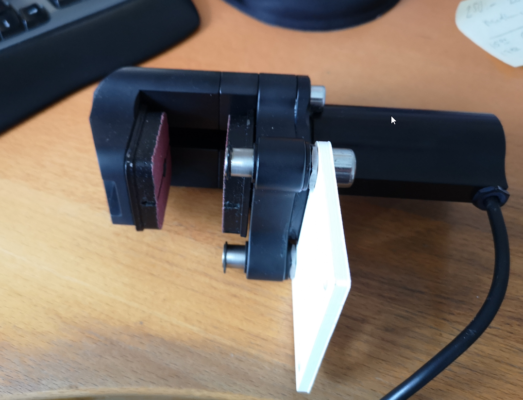

Hi @bune
I have the same handbrake calipers but still not mounted. I have printed some mock-brackets (the real will be thicker).
You have the mounting brackets on the other side than I have on the picture below.
How have you reasoned about that?
Rune
I saw it as a good way to do it . no other reason it was practical for me. you might get the bracket thicker your way. I do not know if it is needed.

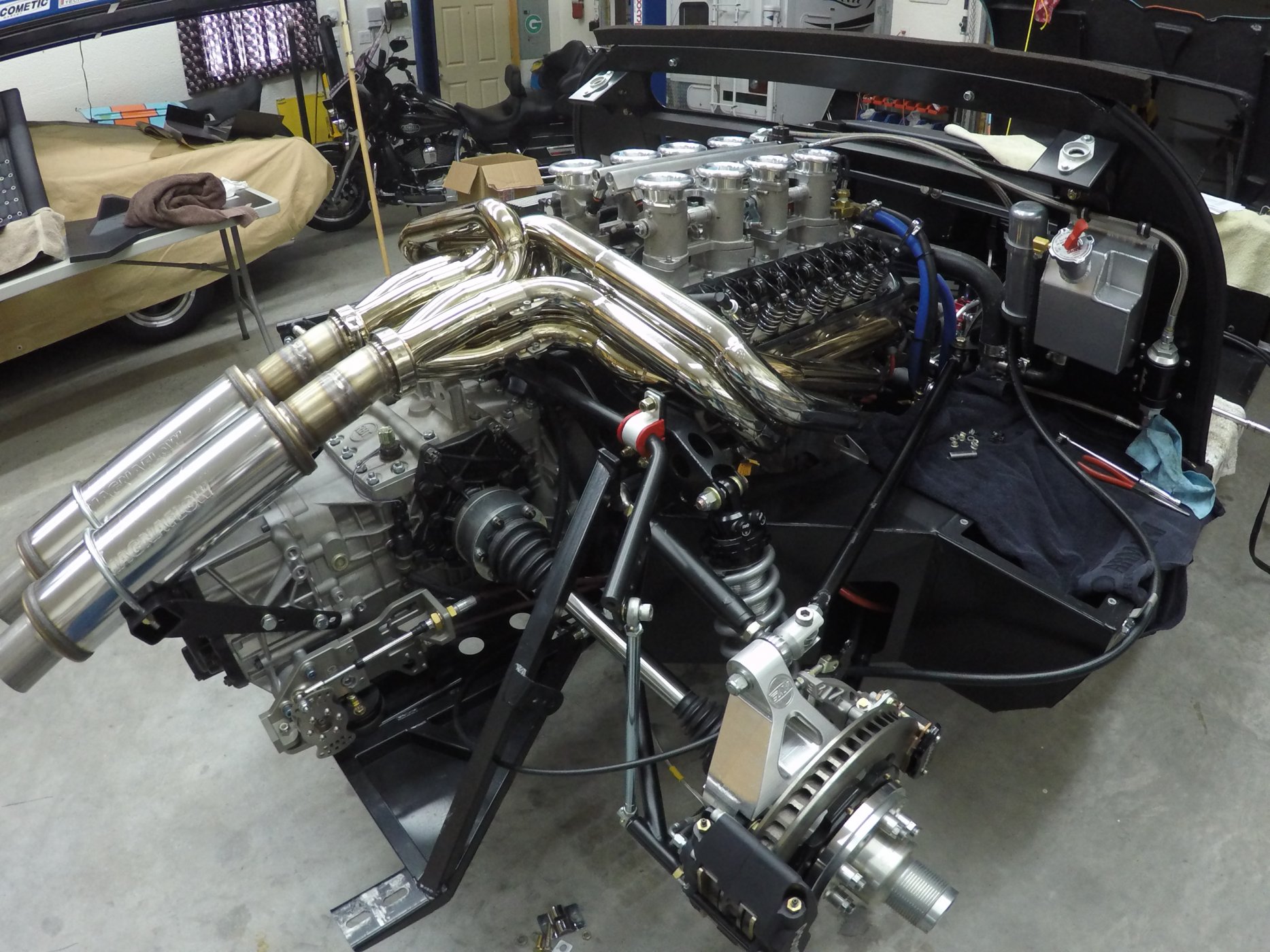

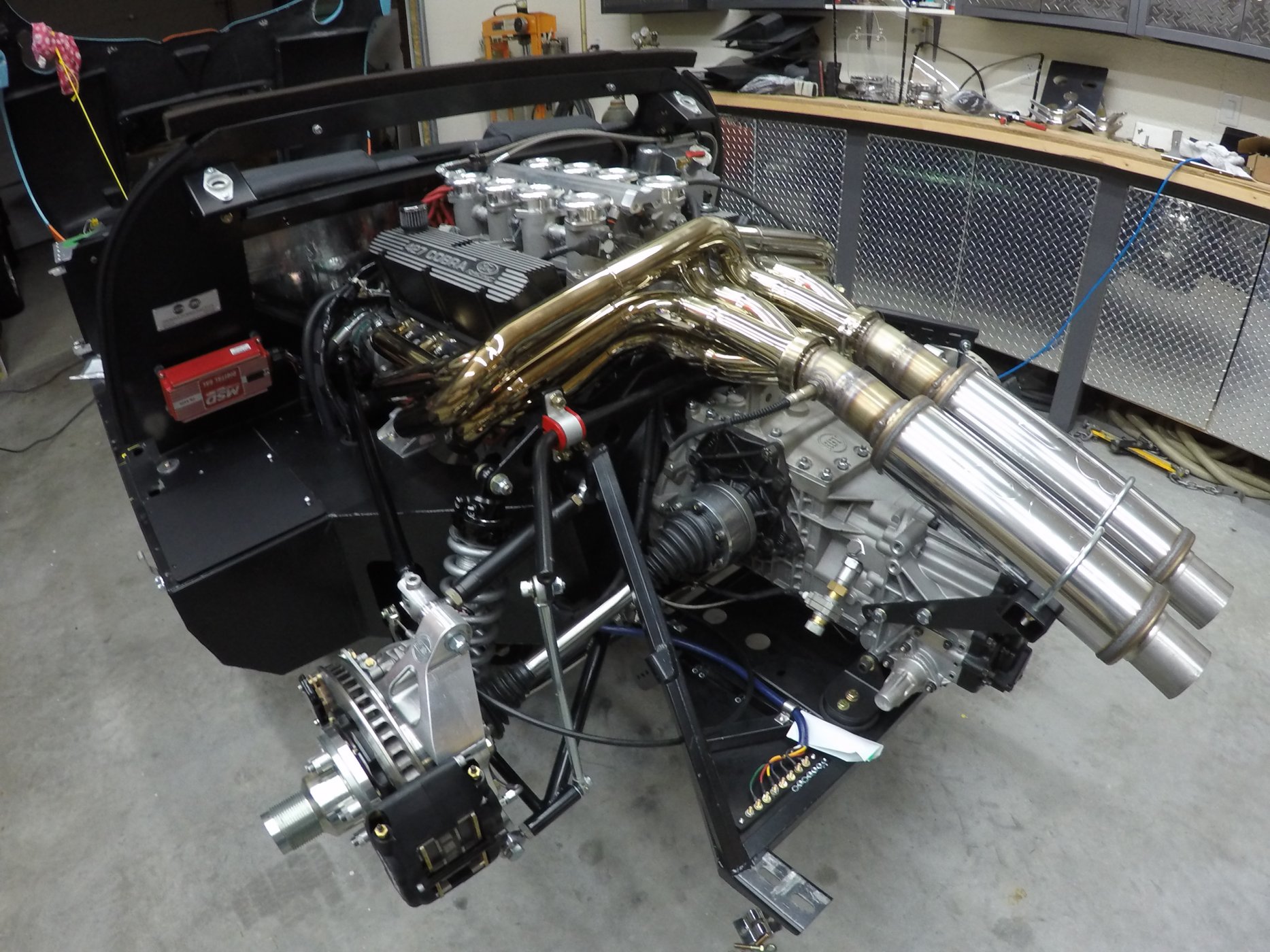

I believe it's the MC 4 by Willwood I used. It works very well it was easy to fabricate brackets and run cables. The pics aren't a real close up but I think you will see that there is lots of room. The profile is smaller than that of the main caliper.
