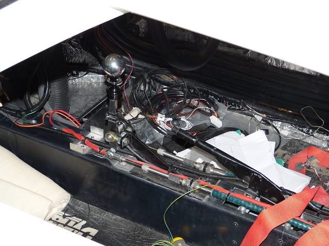

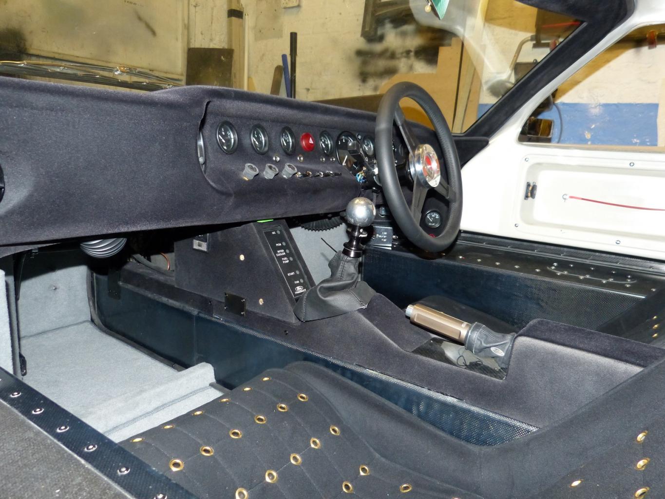

hi all
bit of an update got some more pics to upload

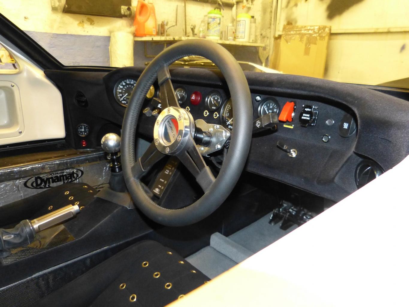

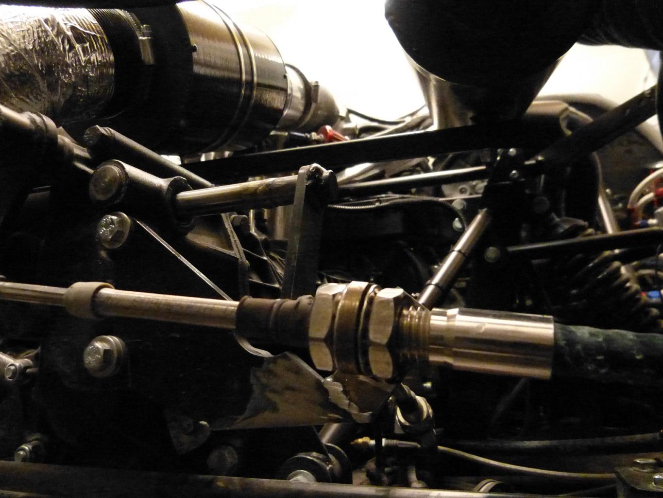

these are pics of my custom gear knob with lift up reverse
i also repositioned the bracket for the cross gate cable so it doesnt
stick out the bottom of the rear clip any more and got some heat shielding on

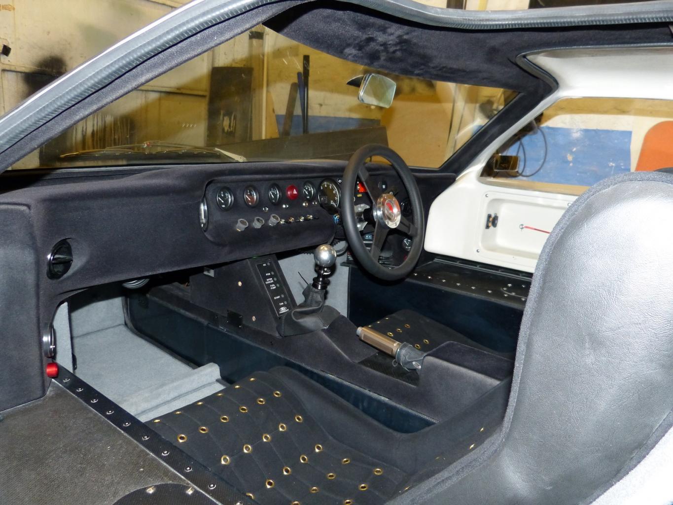

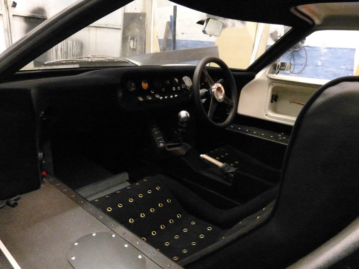

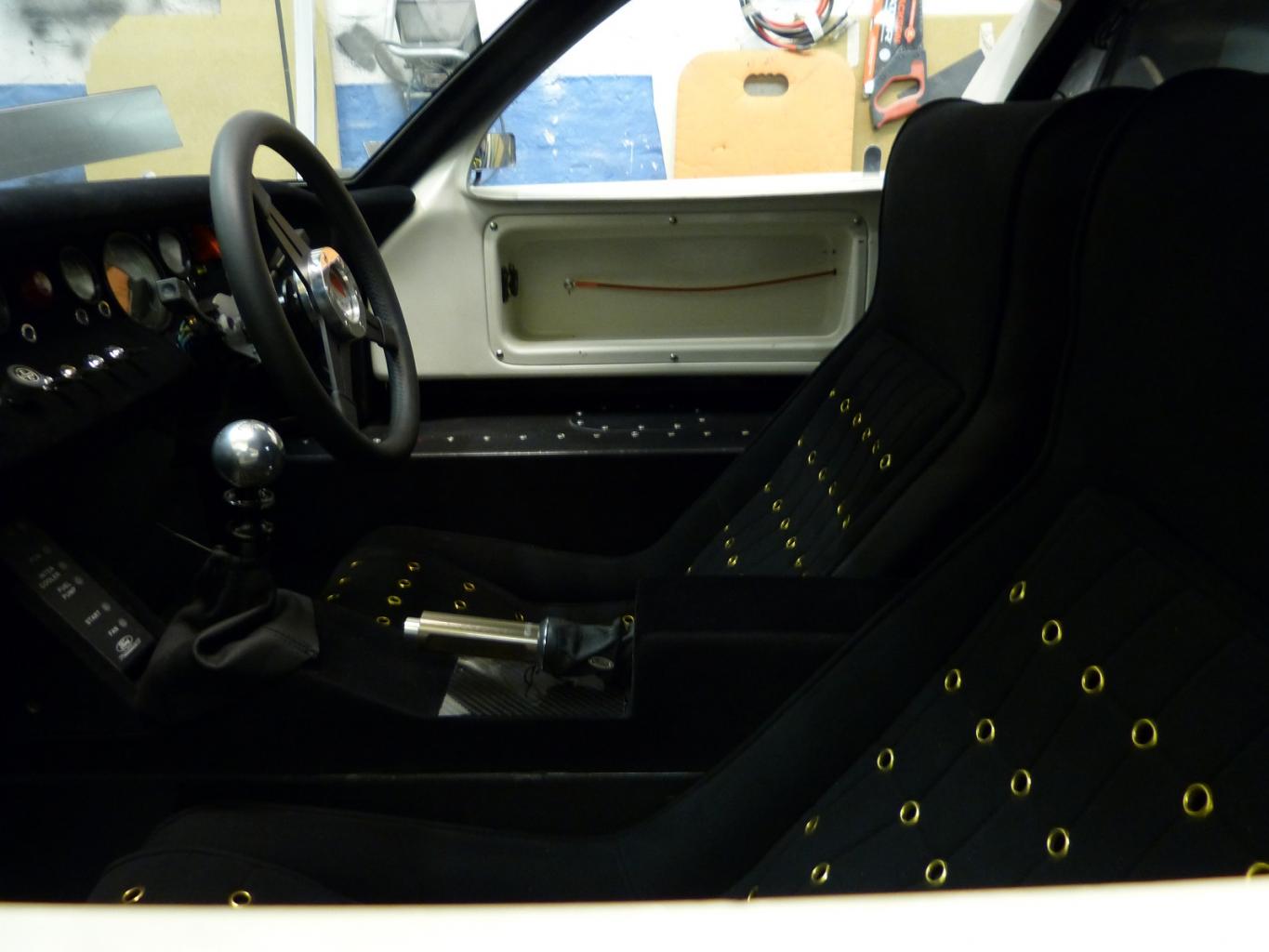

more pics

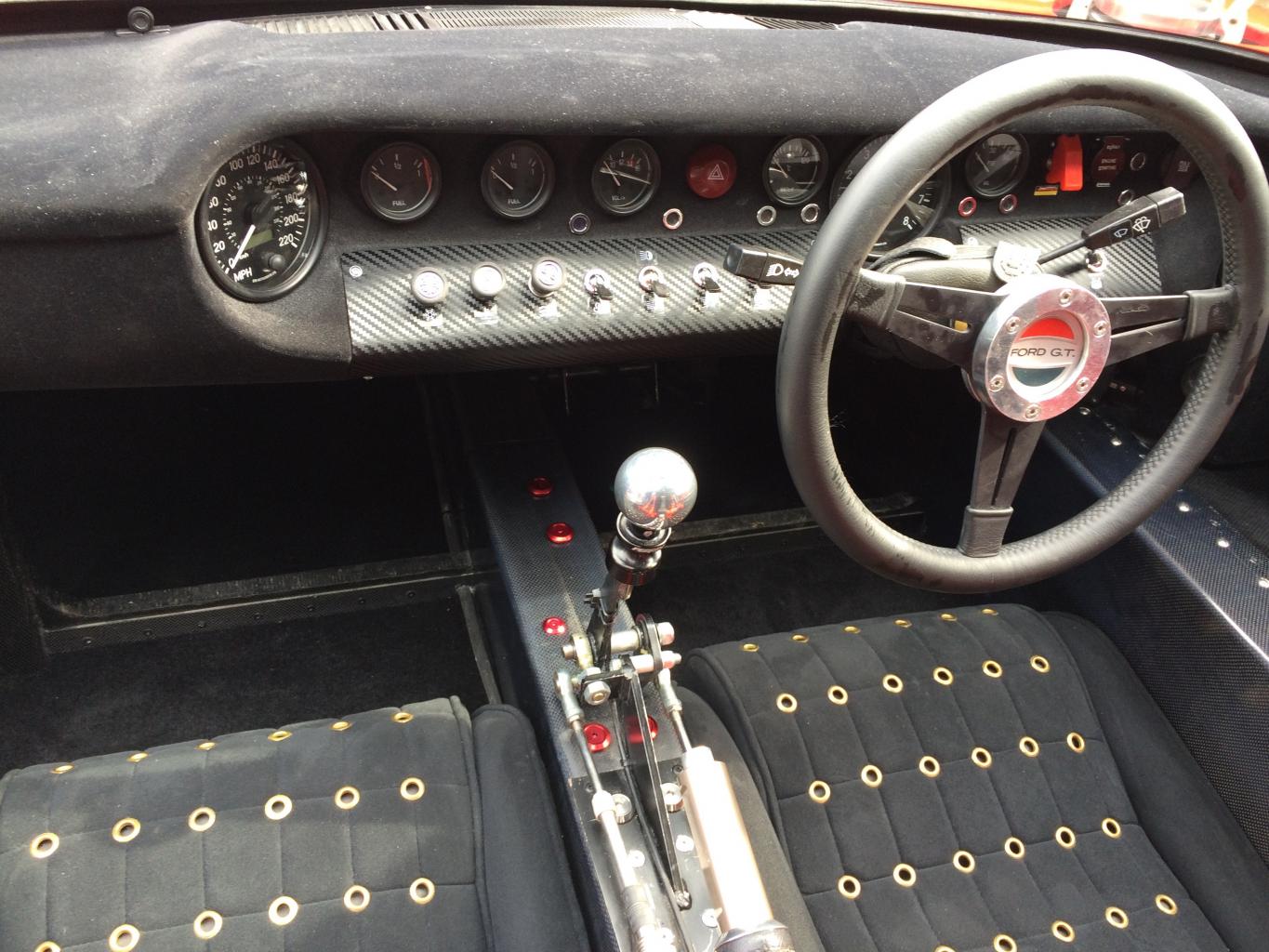

fitted a fog and reverse light got wiring completed
got the dash and roof flocked put the carpets in
build a center console over the center tunnel

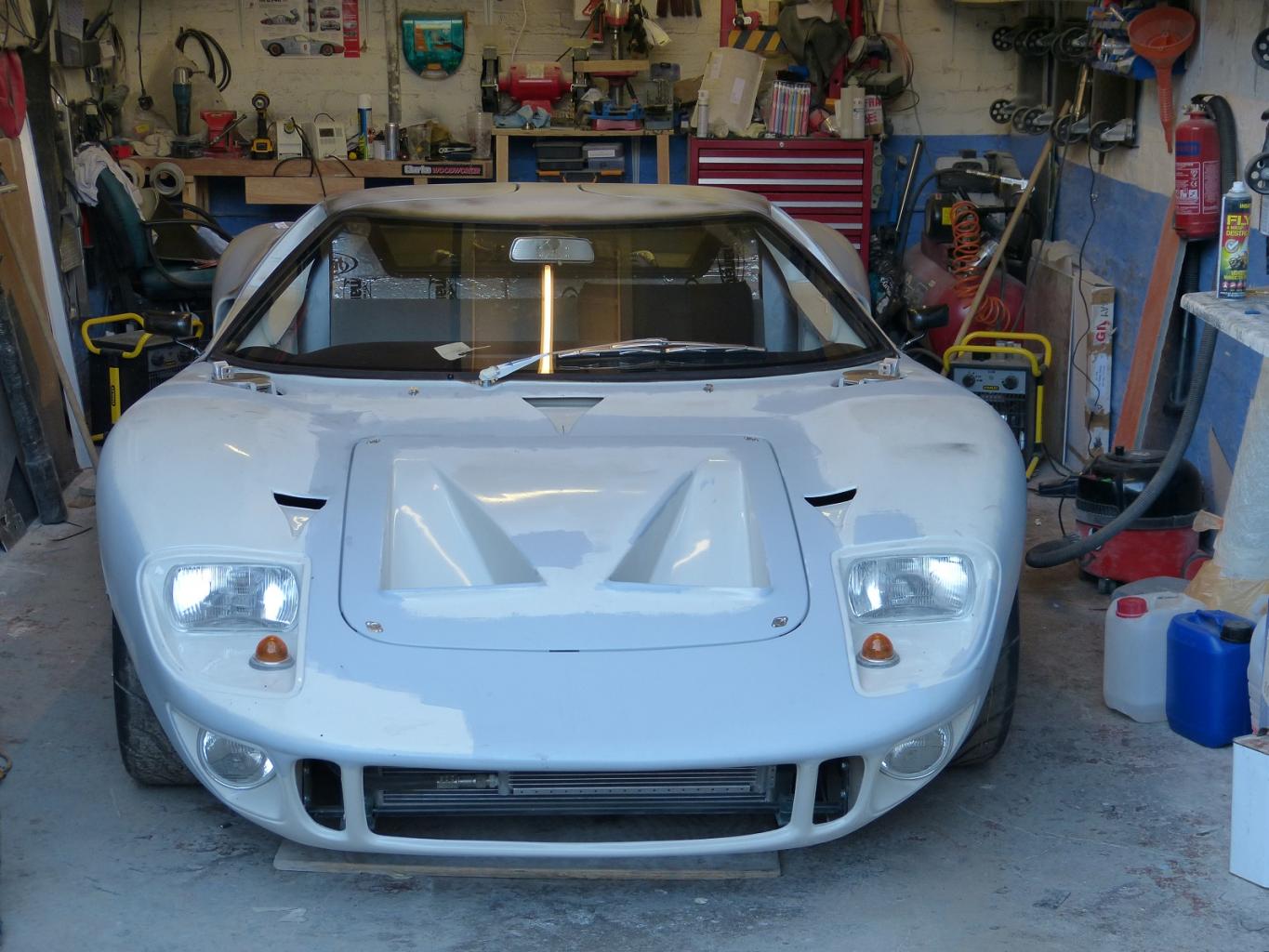

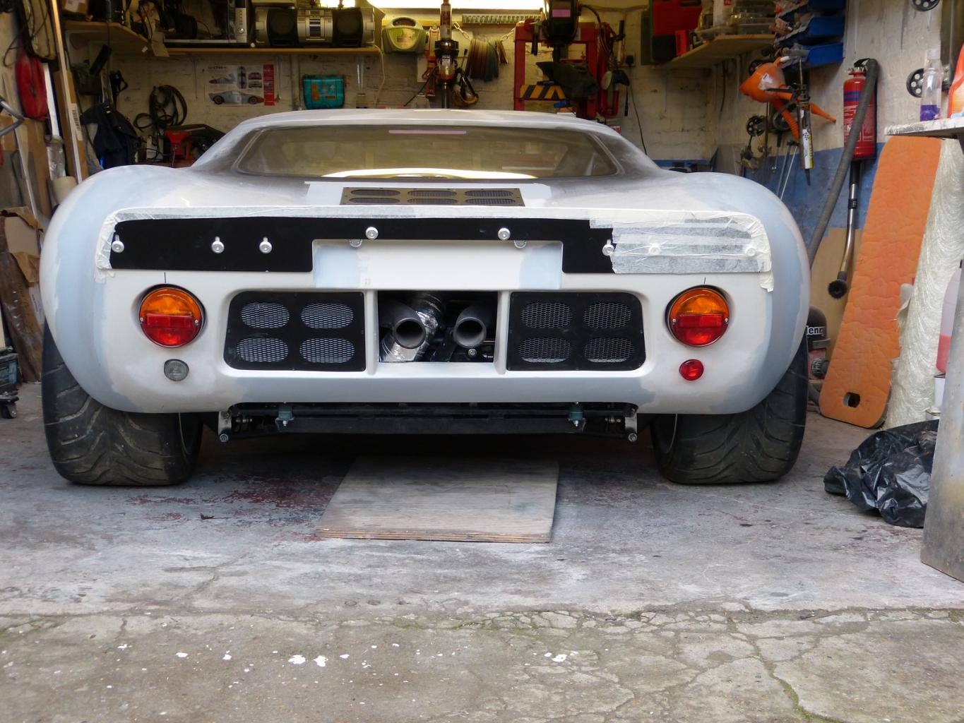

Hi Abraham,
Looking good. Having had to ‘adjust’ the position of my front indicators during the IVA test, looking at the position of yours, it worth re-checking them. They have to be a maximum of 400mm from the side of the car. Note the rear is wider than the front , which I’d overlooked this when I did my checking. Also the size of the indicators used, may give you issues in masking the headlamp beam

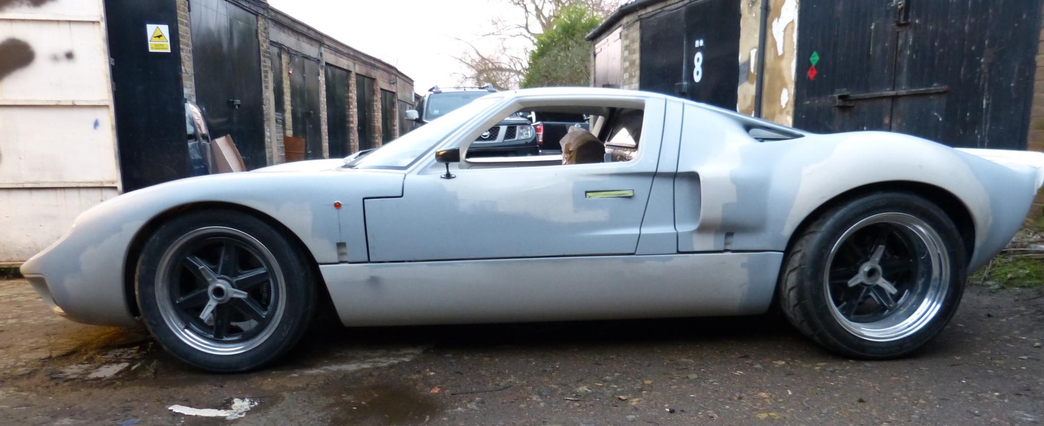

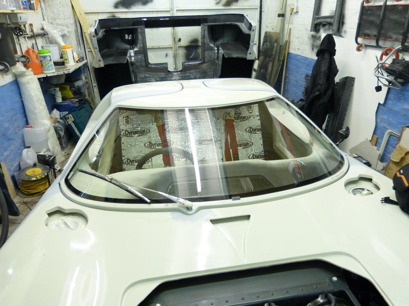

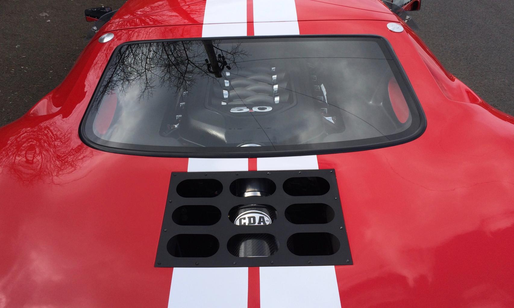

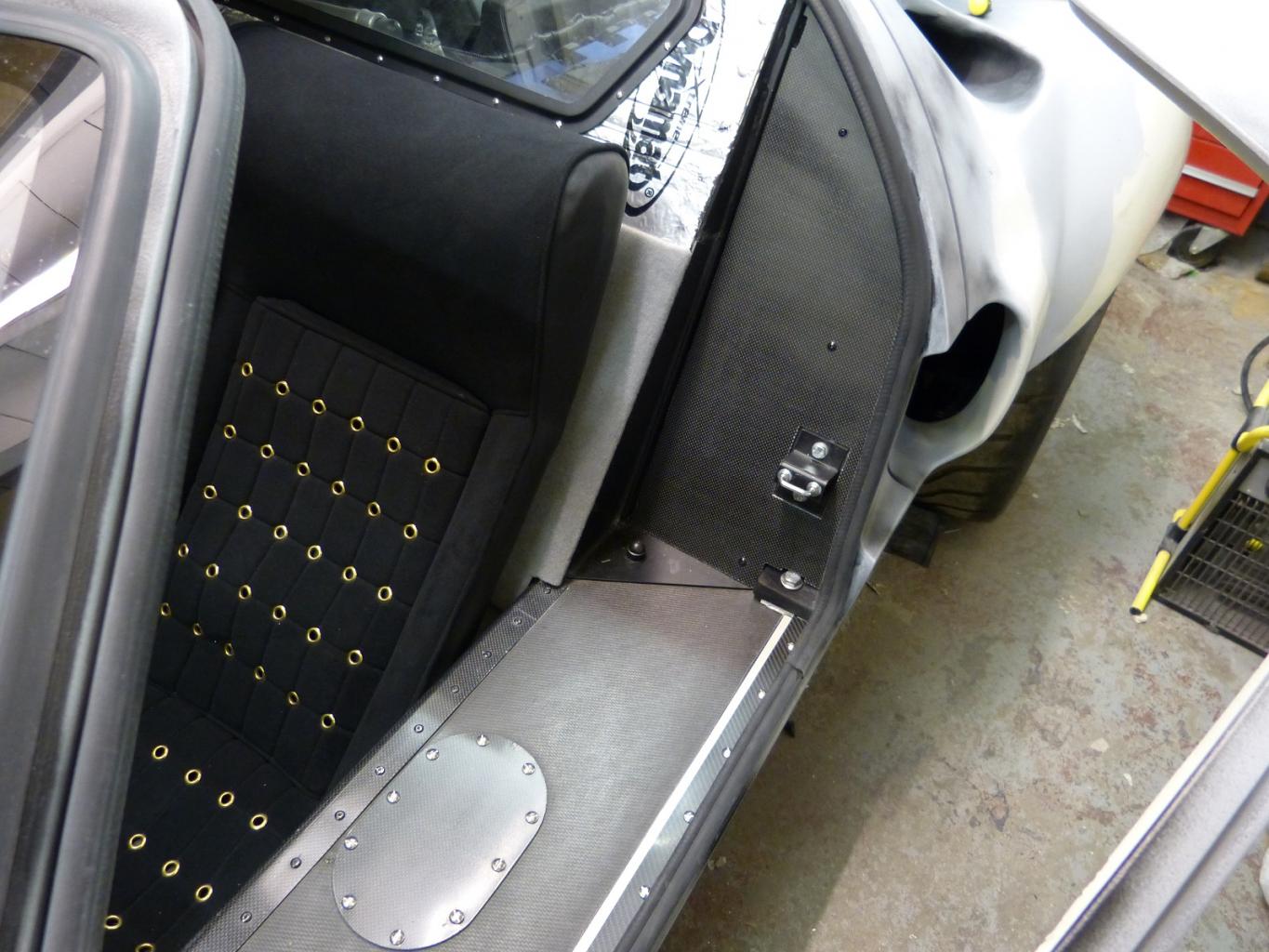

over due update
car vent off for its iva in june 2014 and passed
made a few changes to exterior and interior
swapped the lower round lights for square ones
got rid of the centre console that covered the gear shift and wiring loom

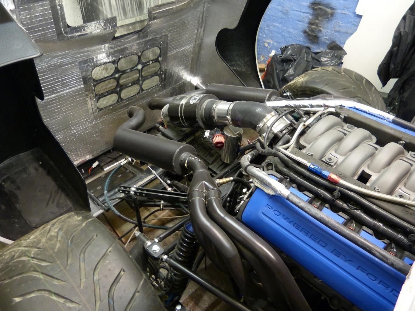

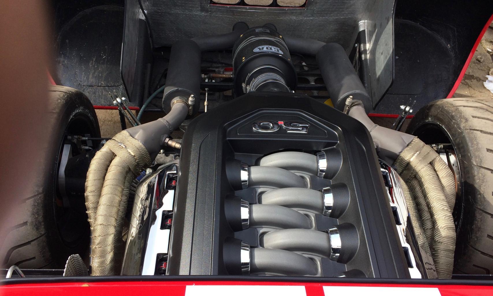

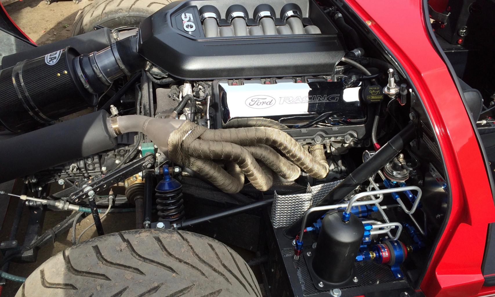

added an engine cover

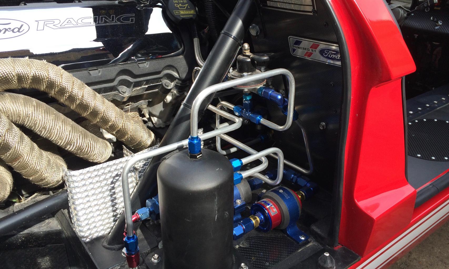

and relocated the primary fuel pumps closer to the tanks
then car went off for in for painting
more pics
