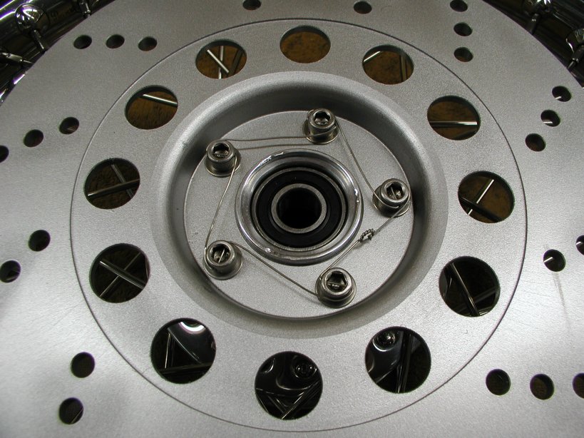

Have you thought about safety-wiring them? There's a couple of different methods to do it, drill straight through the nut and bolt, then you can just drill through a portion of the nut and safety wire them all together in kind of a criss-cross pattern. Let me see if I can find a picture...
http://www.oldbritts.com/image/52_130202b.jpg
http://www.tpub.com/content/aviation/14014/img/14014_116_1.jpg
I'm sure you all know what I'm talking about though. LOL

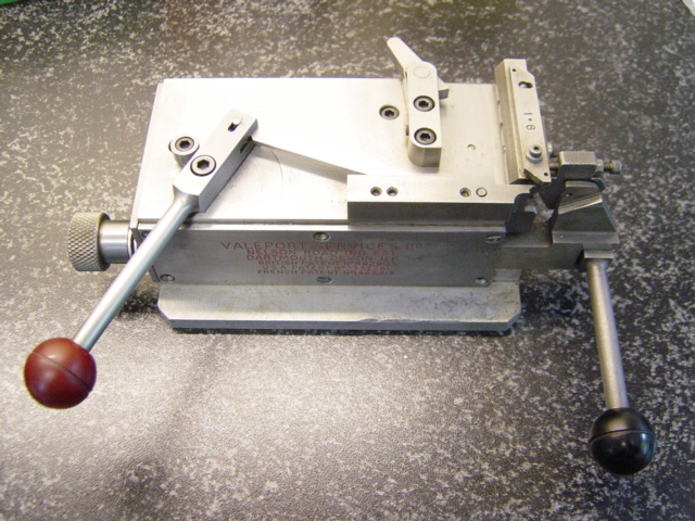

I use many safety wired or pinned fasteners and drill my own set screws and bolts using this jig for accuracy.
