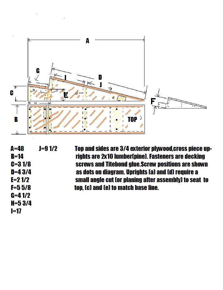

I will be 'defrosting' the car and ramps from their New England 'igloo' this week and moving it to a larger working area. At that time I will take some photos to include with the plans and send them on to you or any other interested party. These are simple to construct and lighter than you would suspect. They will hold anything you can put on a 16-18' trailer. The only variable is the resting angle of the trailer which depends on the hitch height. I set mine up with the trailer bed level, as you can see from the photo. Also, if you are concerned with trailer sway, which will be more apparent with a shorter wheelbase tow vehicle, you should arrange for the center of the load to be just a bit ahead of the center between the axles on a double axle unit or similar for a single. That's why my car is loaded tail-end-first. A.J.
For those do-it-yourselfers, here's the plan for homemade ramp extensions. If the pic is too small, import it and expand it. These will work well with a standard 16/18 foot car trailer (with pull out steel ramps) set up to tow with the deck relatively level. Cut the sides and top, check dimensions and make any slight adjustments to upright cross pieces,then assemble sides and uprights. Then add top plates. Fasteners are 2" decking screws and Titebond glue.Finally,coat the small ends with JB weld epoxy on the plywood 'end grain' to prevent chipping or fraying and follow with a coat of paint. Check previous post #30 to see actual ramps in use. There's more info to go with this, PM me if you're inerested.

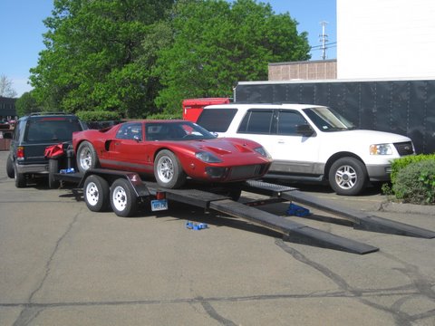

To continue to document my progress I have:
1. bought and installed the B&M Transcooler ($75)
2. bought and installed a Curt Mfg Class 3 hitch and 7 pin RV plug wiring (about $200 total)
3. bought a steel decked dove tail trailer that weighs 1300 lbs and has dual electric brakes with emergency break away switch and battery ($2395)
4. bought and installed a Tekonsha Primus IQ brake controller ($75)
5. bought a Superwinch 4500 Winch ($209)
6. paid a fabricator ($250) to modify the trailer to use hitch part for a winch quick disconnect. That way I can pull the winch and store it while the trailer is left outside, or I can plug the winch into the Jeep hitch to pull my field mower when it gets stuck.
I still need to:
1. install tranny temp gauge
2. make ramp extensions
3. make a battery box mount for the battery, solenoid, circuit breaker that is moveable from the trailer to storage to the Jeep.
more to follow!
oh, and I need to install the buy the ETrack and the tire web straps.
Here are some pictures of the progress to date.
