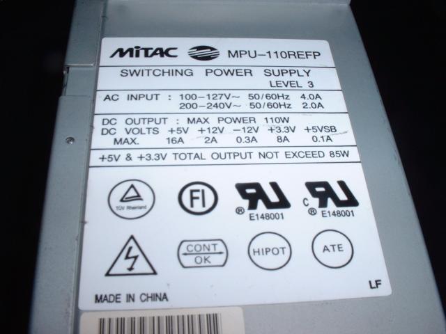

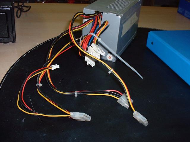

The question now is... what cables shall I use as switch on/off for such power unit?.
I just know the group of 4 wires coming outside power units shall be yellow=5v, black is ground, and red should be 12v, correct?
I connected it to electric in the wall, but of course it misses signal to startup.
I add some pics of the power unit, would be nice to make another external switch,coming from an old light.

With a nut friend we discover the power unit is burned inside.It also had anyway a very very low powerage of 110W, so now..we retry with a better and newer ATX 230w unit, and it works perfectly (when I trash pc I always try to save what I can...cause there is always a modellistic use for everything..including wires inside, they are perfect for engines in scale..:)
I just will use yellow and red cables (of course the black ground too..).

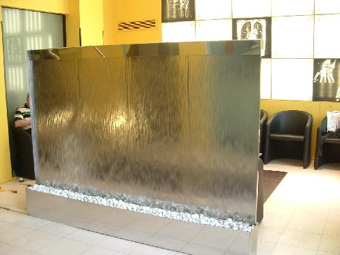

Next nut project will be...a waterwall side where I can paint with airbrush..surely some will laugh, but all body painters probably know what I mean...
Will be cool to have something similar to the picture down here, also if this is fashion stuff..for about 5000 dollars...and comes a little pricey :)
