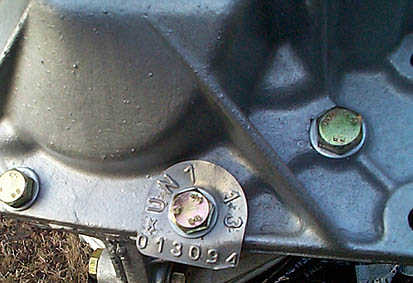

This is a picture of the correct UN-1 tag commonly found on the 5th gear cover at the rear of the gearbox. I can't find a number on mine like the one you have posted. This doesn't mean it's not a UN1 i just don't know what is in reference to. $400 would be a fair price here in the USA for a used/working gearbox. Maybe a little better than good considering the value of the pound and shipping costs from the UK. Expect to spend $500 to ship one here from England. Each way I might add.

Yes, check the tag on the gearbox. If its not there, pull the bellhousing off and have a look at the back of the crownwheel. Every model has its identity engraved here.
The term 'UN1' is loosely describing the 'style' of gearbox, as like saying 'Toyota' - but there are so many different versions. The 369 is virtually identical on the outside except it was the forerunner to the UN series, and in a few ways, a stronger box.
Joz, get back to us here when you've found the number and we can tell you exactly what you have. (with reference to the internals.)
He is likely looking at the number cast into the case just ahead of the right hand drive flange. It may be a serial number???my R-21 from Mach I in the Uk has the number 700599238 on it in addition to the tag mentioned above.
