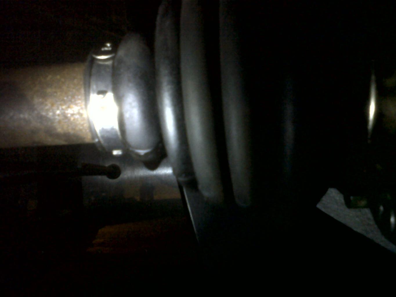

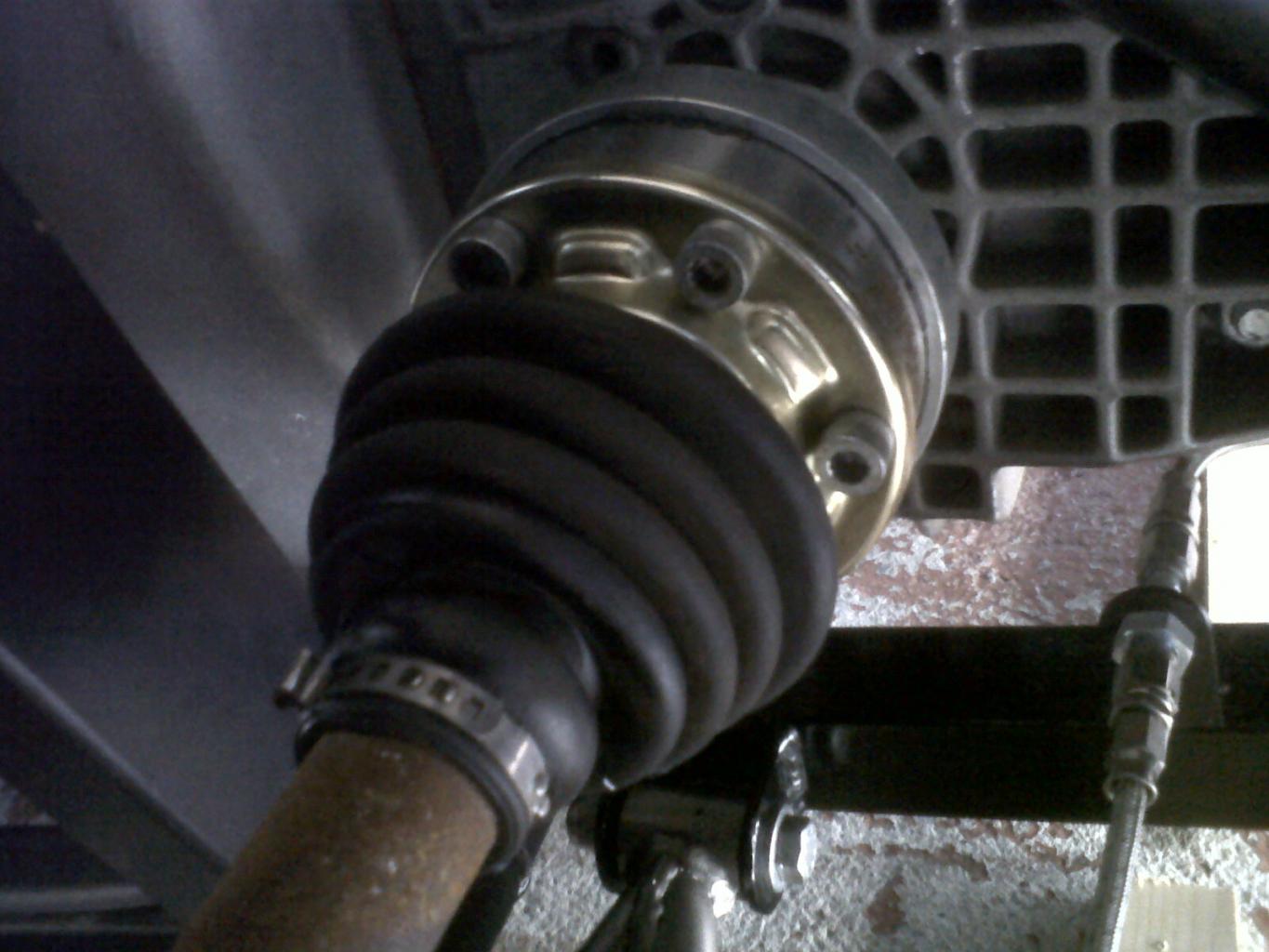

I am in the process of finishing a Tornado TS40, which I bought recently, I've noticed bright red fluid coming out of the VC boots on the inboard couplings (plural) on the UN1. Not sure what colour the recommended oil for the box is, but guess it is the oil. Can the oil make it way out of the box, via the coupling and into the CV coupling boots? I read somewhere that when coupling the CV joint to the coupling on the g/box to use a sealant,.... as i did not make this joint, I do not know how it was done. Can anyone suggest a course of action, the leak forms a drip in about 3 hours, the drip forms on the outermost fold on the boot, where the boot is clamped to the shaft with a jubilee clip, so it is probably seeping out between the boot and the shaft.
You can just see the shadow of the drip on the attached image.
Should I drain the box decouple the CV joints from the box, clean and seal?

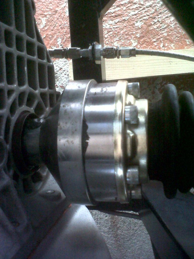

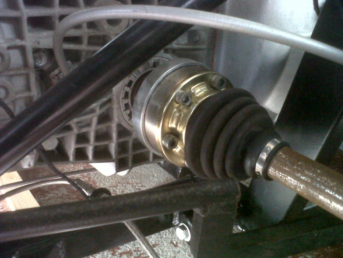

HI guys
I attach more photos, it seems to be coming out the boot and some (less) coming out from the shaft out of the box. The inboard 'adapter' does have a blob of sealant on the shaft, but I don't think it is leaking from there, i will need to check more thoroughly. Sorry for the bad pix last night, is was getting dark and couldn't find either of my 2 inspection lamps,.... think the wife is hiding stuff.

Hi Keith,
I'd split the CV joint off the adapter and see if it's been weeping down the spline. If it has, dry it out and seal it with silicone. Also check it hasn't contaminated the CV grease
Andy
Thanks Andy et al,.... out of interest, can the ouput shaft be taken out of the box without having to remove or disassemble the box? My fear is that it is weeping out from the main box/outout shaft (brown) seals as well as via the CV joint and boot. Trans oil is in both boots, give them a squeeze and a wee bit of red/amber oil squirts out.
I'll decouple the joints and see, ta for now.

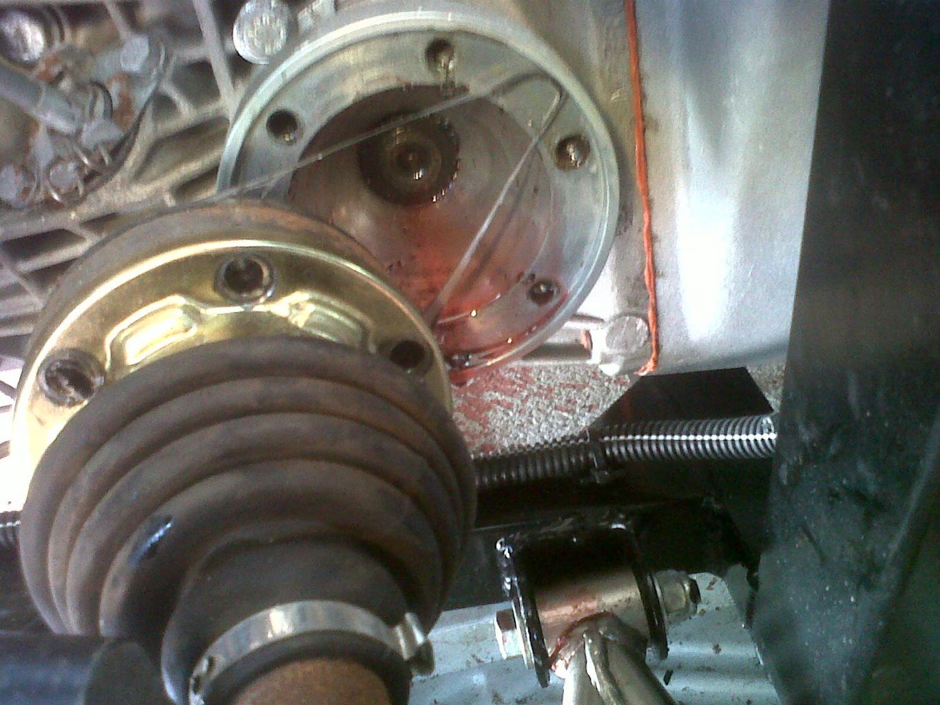

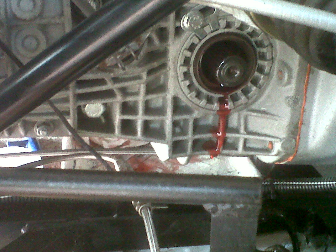

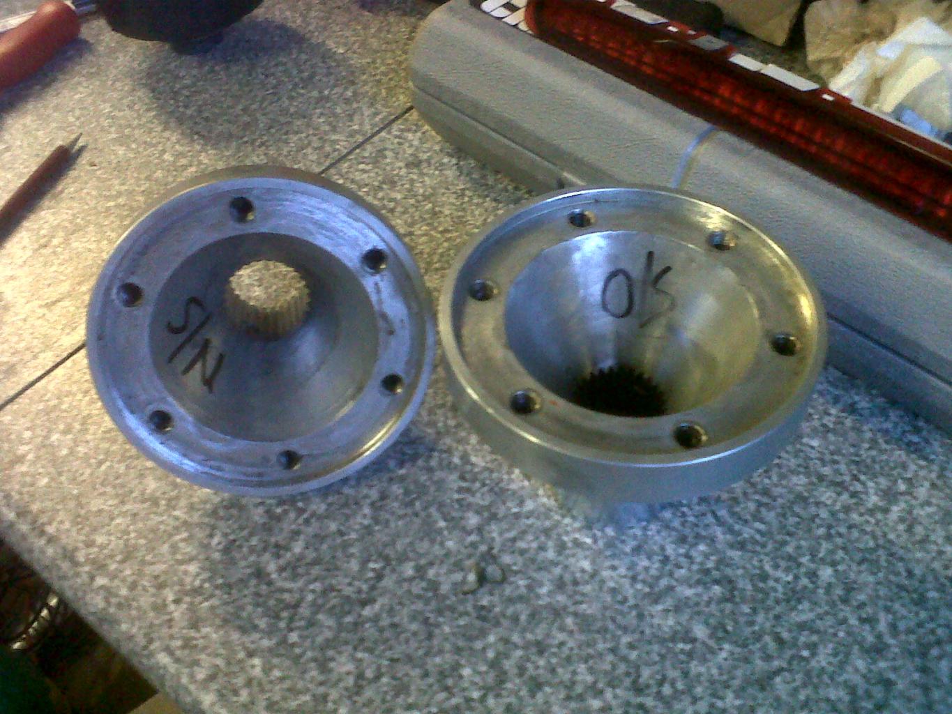

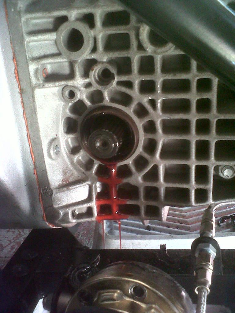

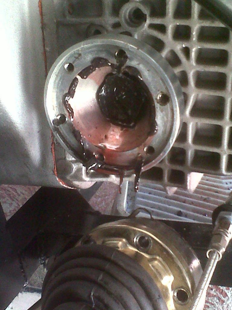

As you know I had a few drops of gearbox oil dripping from the couplings to the gearbox and the CV boot. I dropped both couplings to the gearbox and on the offside there was some g/box oil inside the CV joint, boot and coupling, when i took off the adapter there was a bit of a flood, prob about 250ml, half a pint came out, so if there is a seal on the output shaft of the gearbox, then it needs replaced. Same for the nearside, both leaking fluid to the CV joint down the splines.
The first two pix show the oil in the adapter, 3 & 4 show the flow when the adapter was removed.
I believe eBay has these seals for ~£15. I may also see if I can get the adapters modified to accept a disc (with an interference fit) to seal the pathway?
Has anyone any advice or experience on this? Are there inner seals (on the output shafts) and do they fail often? I welcome any comments.

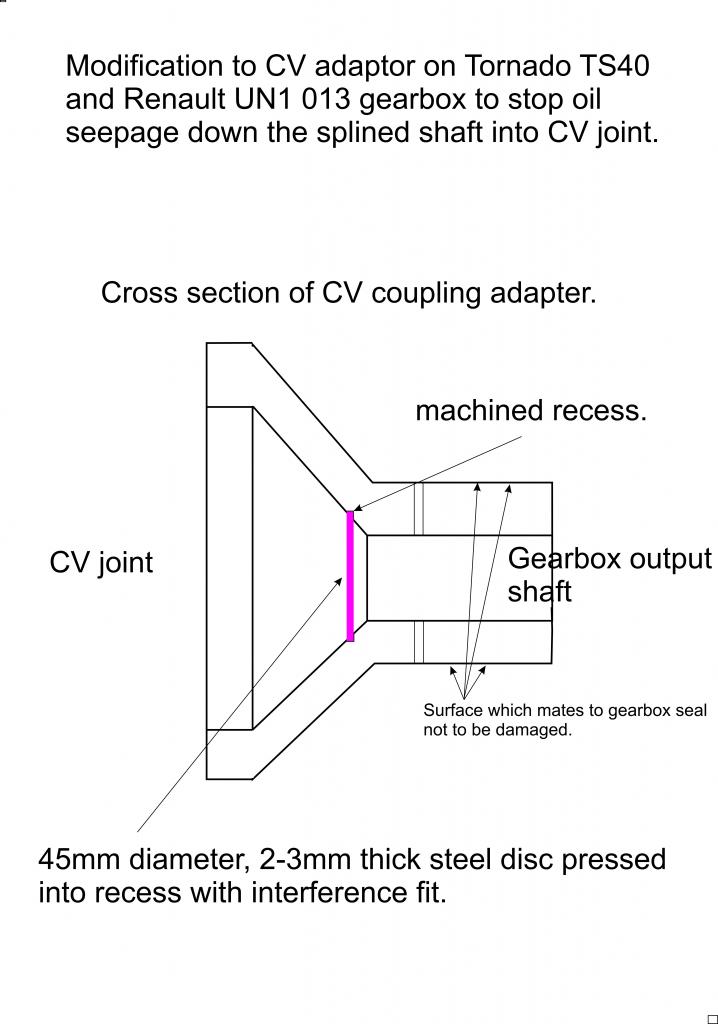

I've taken the plunge, both CV adapters are off and sent to the machine shop, see the attached (rough) design, going to get a metal disc inserted so I never have to deal with this issue again!
I'll keep you posted.

Errrrm, wouldnt it be easier just to put the 'O' rings on the inside of the shafts, if its -13 box, the shafts are even machined for them. When you slide the CV adapters on the shaft, they seal up against the 'O' rings inside and stop the oil coming down the splines.
+1
This is how the UN1 is made. I believe your orings to be missing or damaged. You should start from there.
Also, if I understand your oiloproof concept, then you will have to add sealant to the top and bottom of the rollpin too. In your concept, with no orings or worn ones, the oil will still be allowed to go through the splines and grooves and then reach the hole of the rollpin, thus sealant here.
With 5 usd spent to buy a set of 2 orings you can solve this....and then your concept can be an over imporvment in case of...but not the solution.
