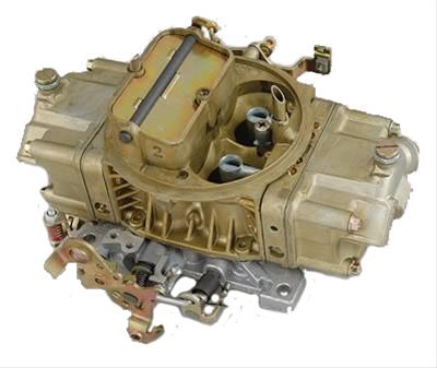

Howard Jones
Yeah, Howard, I know. The trouble with that, and me, is a combination of aesthetics and fear. The TWM looks like Webers. Replacing the TWM with Webers makes me think I'd be spending all my time tuning - or tying to.
