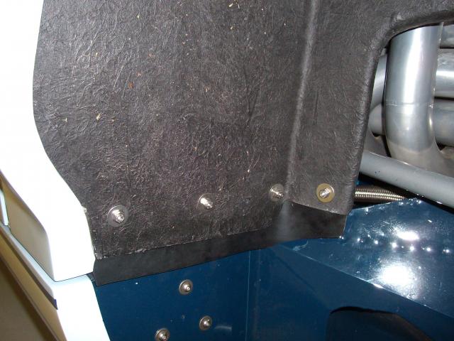

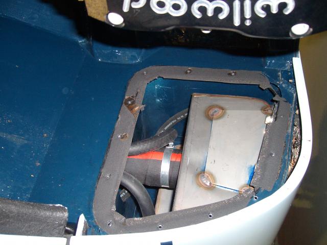

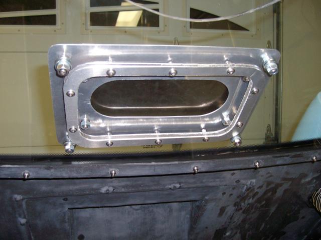

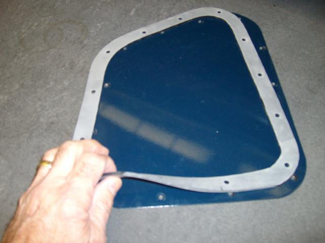

New upgrades to P2125:
Grease fittings added to lower ball joint cover cups.
New gaskets (thicker/more compliant) for fuel tank access plates.
Plexi engine cover plate assembly (to prevent header from melting plexi..1'st plexi cover melted with just a single plate).
Rubber mud flaps (thanks to Chuck and Ryan with the RCR for the idea).
Steve

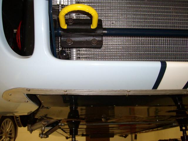

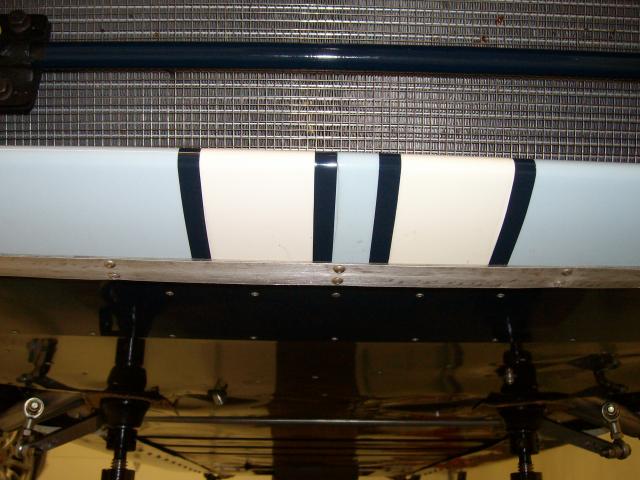

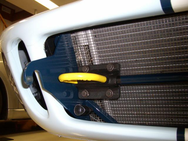

A few more:

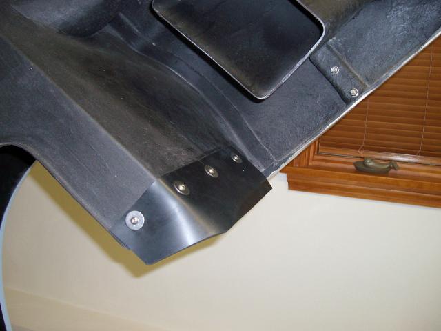

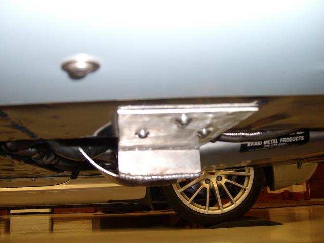

Ali nose skid plate.
Olthoff designed oil pan deflector plate.
Steve

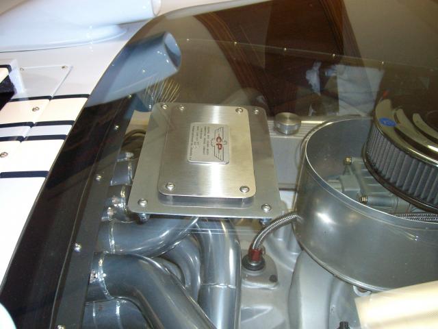

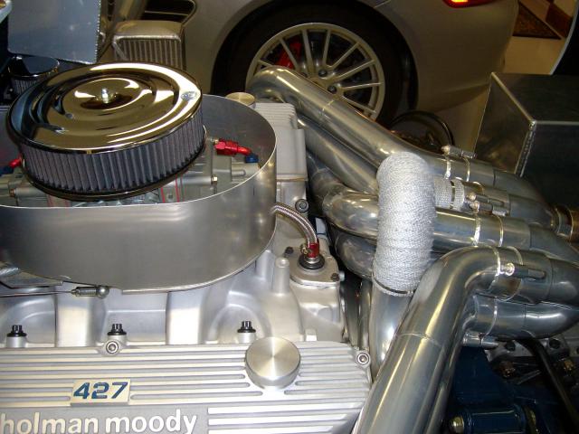

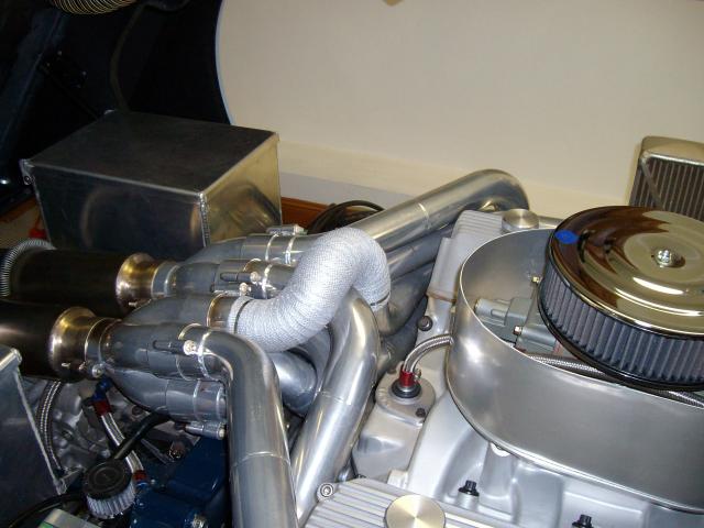

Latest upgrade to P2125.
In order to further reduce possibility of heat warpage of plexi engine cover wrapped the high header and sprayed with high temp aluminum filled silver paint:

Steve,
Have you considered glass? I imagine the cut out might get a little tricky!! I have the high exhaust like yours. If I experience warping, that will be my option.
Steve C
Steve
Bill,
Tempered I presume.
Anyone done this or have idea as to thickness, and cost?
If I still have a deformation problem with the new plexi I made after the revised ali cover plate (see above pic) and wrapped header is tested I will explore either the polycarb or glass approach (I really like the "look into engine compartment look" so want to stay with that look)
Thanks , Steve
Steve, if you decide to replace the engine cover window with lexan (polycarbonate), get hard-coated lexan, also called MR-10. Straight lexan has a somewhat soft surface and scratches when wiped off with a dry cloth. You can just cut it from sheet and it takes the shape of the car when fastened down.
