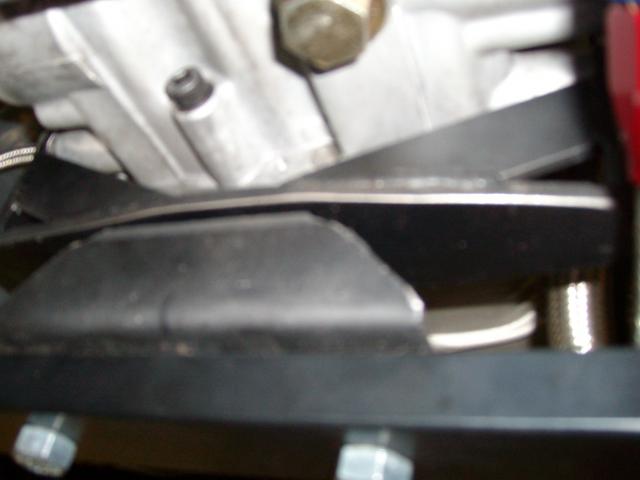

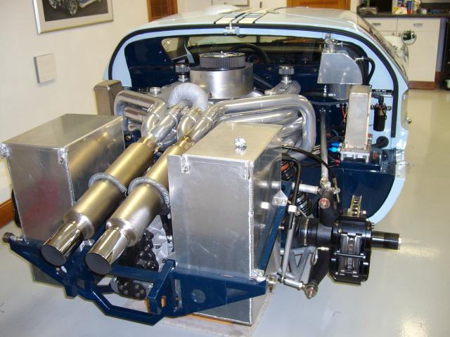

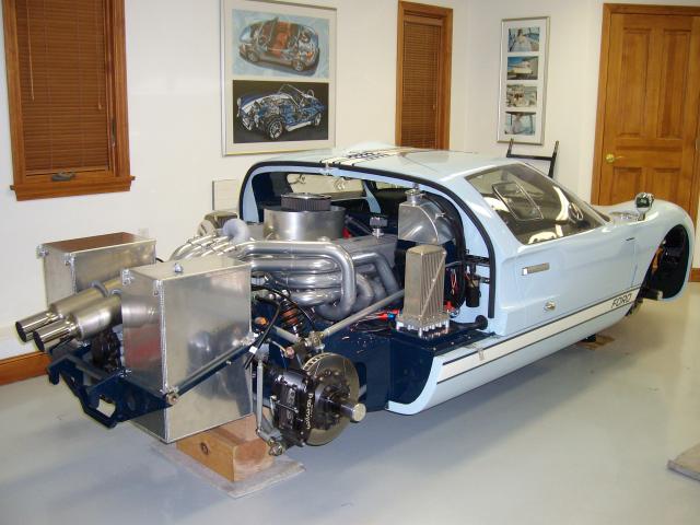

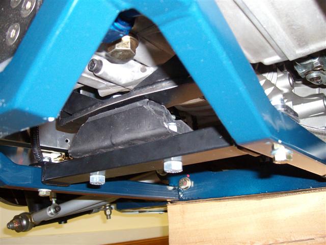

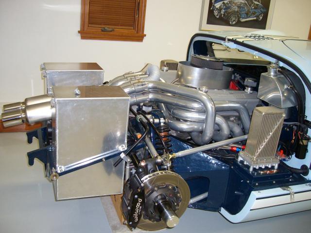

Few new pics:
P2125 with clamshell off
Olthoff designed rear ZF mount I installed last week.

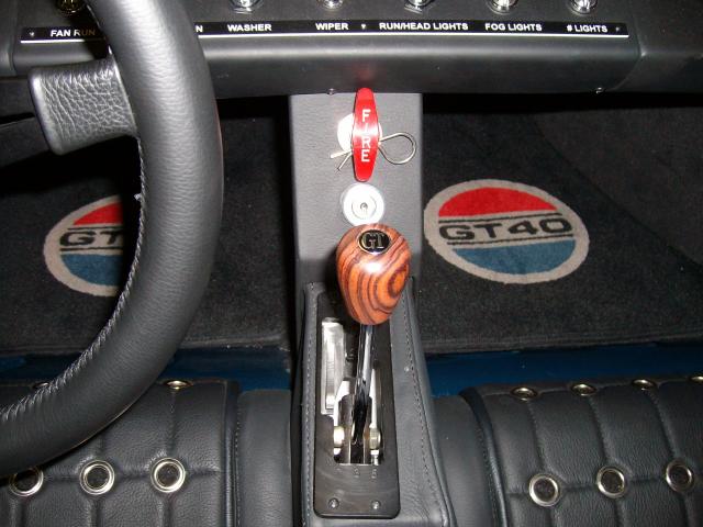

Latest upgrade:
Wood shift knob with GT emblem (thanks to Jimmymac for the emblem).

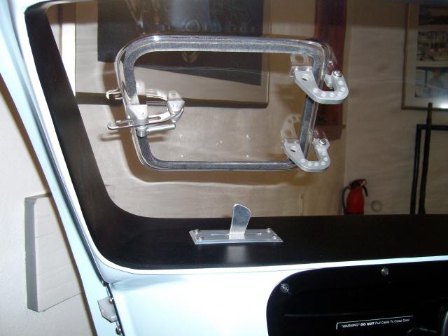

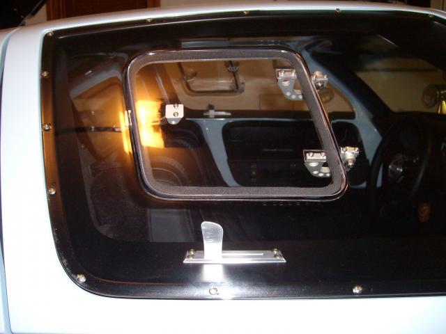

Olthoff door release Lever Kit:
Easy install.

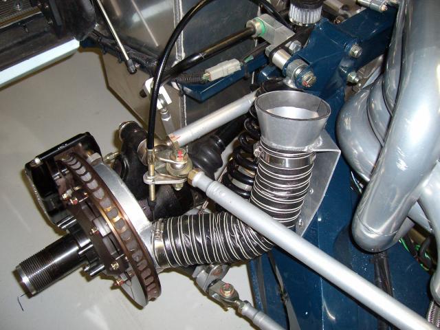

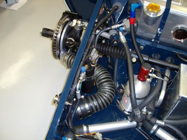

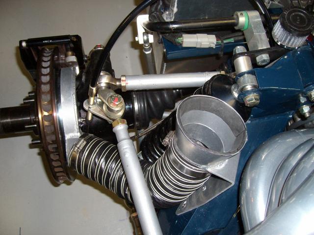

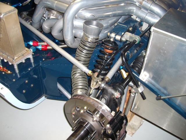

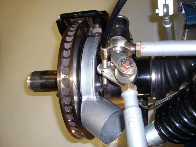

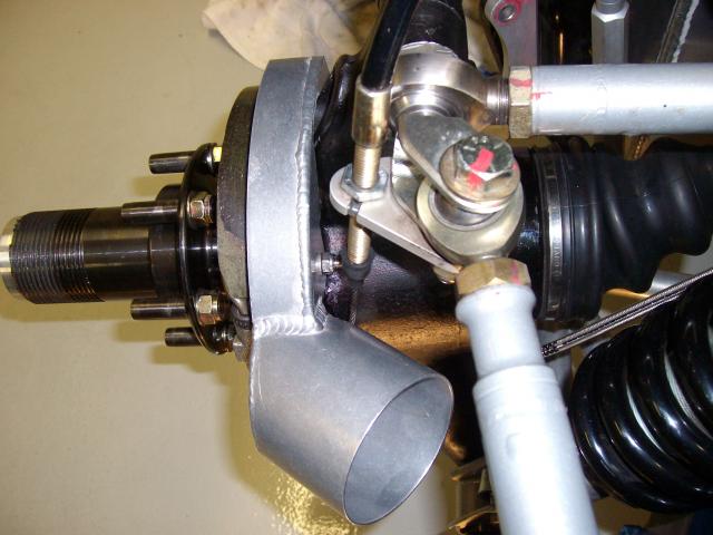

Olthoff Brake Duct Kit:
Installed over weekend.
Front easy (little trimming required). Rears require removal of rotor and a bit of trimming
also good idea to clean and rework the emergency brake fastners as has previously been discussed.
Nice upgrade.
Few more pics on following post.
Steve P2125

Olthoff Brake Duct Kit (few more pics):
Steve P21325

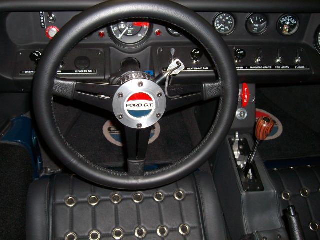

Hi Steve
Not wanting to be too inquisitive but I notice you have a FORD GT emblem in the middle of the steering wheel. I am assuming that it came from the SPF factory with something else and you've changed it? I have poured over and enjoyed your photos and explanations.
Regards
Cam
Auckland, NZ
Steve C
Steve
Cam,
You are correct.
Boss from Frank Catt, badge from Fran Kress
Steve
PS Tx for the compliment.

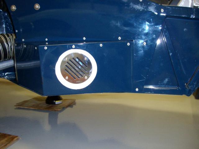

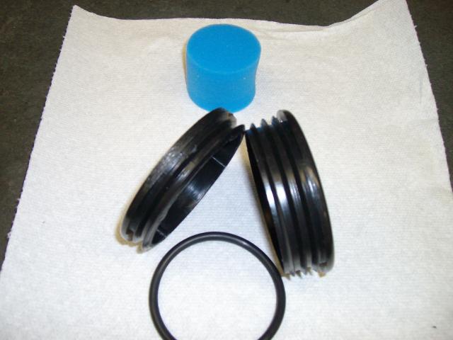

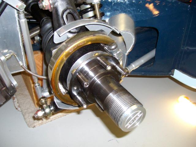

Front wheel bearing cap seal and plug.
Front brake duct slotted and screened plug (see brake duct pics in earlier post)

Steve,
Your car is beautifully clean and tasteful, almost to the point of being obscenely so! :laugh3:
I'm curious about the screen and cover you put over your front brake duct. While I can see the desire to put something there, i.e. a screen, to keep rocks, bugs etc. from traveling through the system, it seems the slotted cover has blanked off the vast majority of your air inlet, essentially defeating the purpose of the whole thing.
Can you explain your line of reasoning with that particular modification? I know that Ford decided that ducting ambient air from the front end directly to the rotors was over-cooling them, and with the Mk II they changed the air source to behind the radiator, so that the brakes were being cooled with heated air. That might make sense at Le Mans, where brake temperatures are truly stratospheric, and the thermal shock of going from surface-of-the-sun hot, to very cold, again and again, would take its toll over time. However, at our levels, I would think that the temperature delta would be considerably less, and ambient air cooling would work just fine (and would be preferable to no cooling at all).
I look forward to hearing your explanation of your decision to blank off most of the cooling duct. :inquisitive:
And please continue sharing as your already-beautiful car continues to improve, day after day! :thumbsup:
Steve C
Steve
Hi Mike,
Thanks for the kudos.
Re your question on the "screen and cover":
For every day driving the ducting isn't needed and I was concerned about picking up road junk but, with the rotors being partially shrouded I think some air is a good idea.
White plug/screen just pops in and out so can easily be removed if full race ducting is needed.
