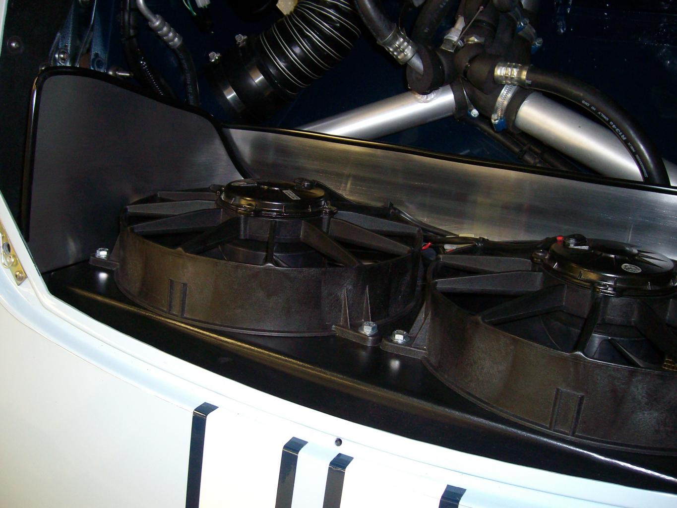

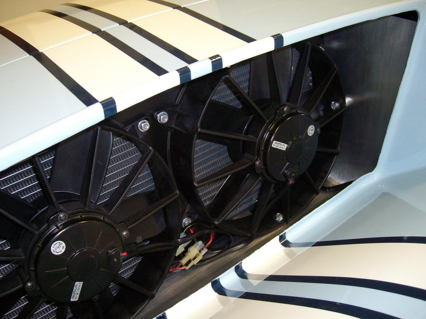

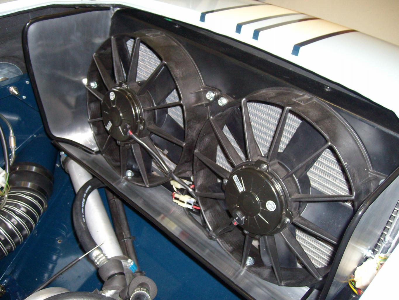

Latest upgrades:

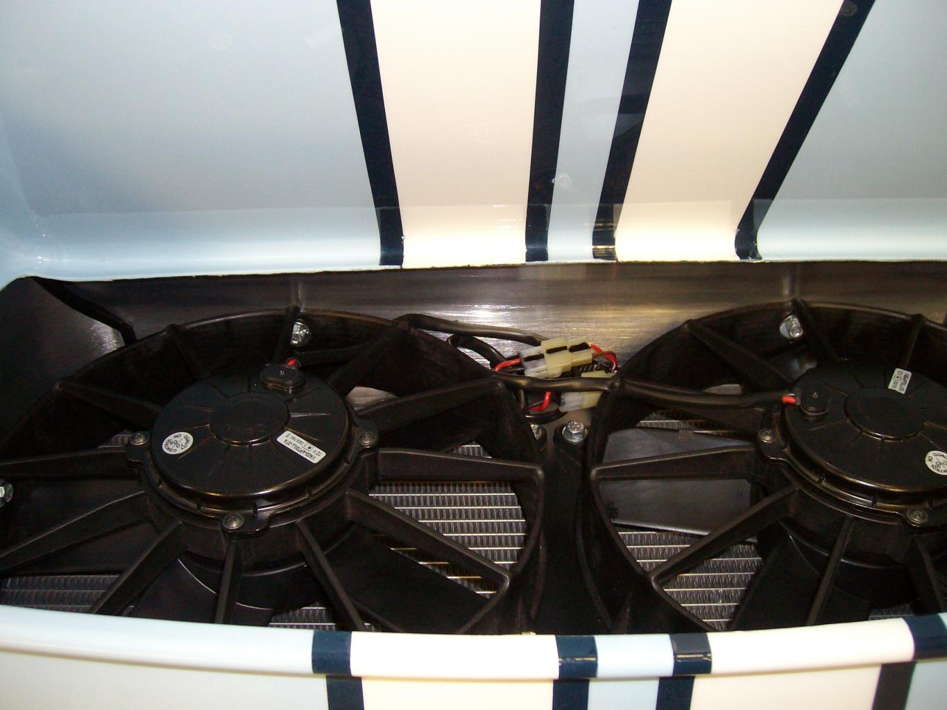

Olthoff supplied radiator to hood panels trimmed, formed to fit and installed by Steve
Steve P2125

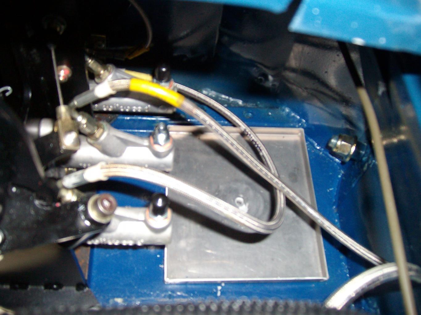

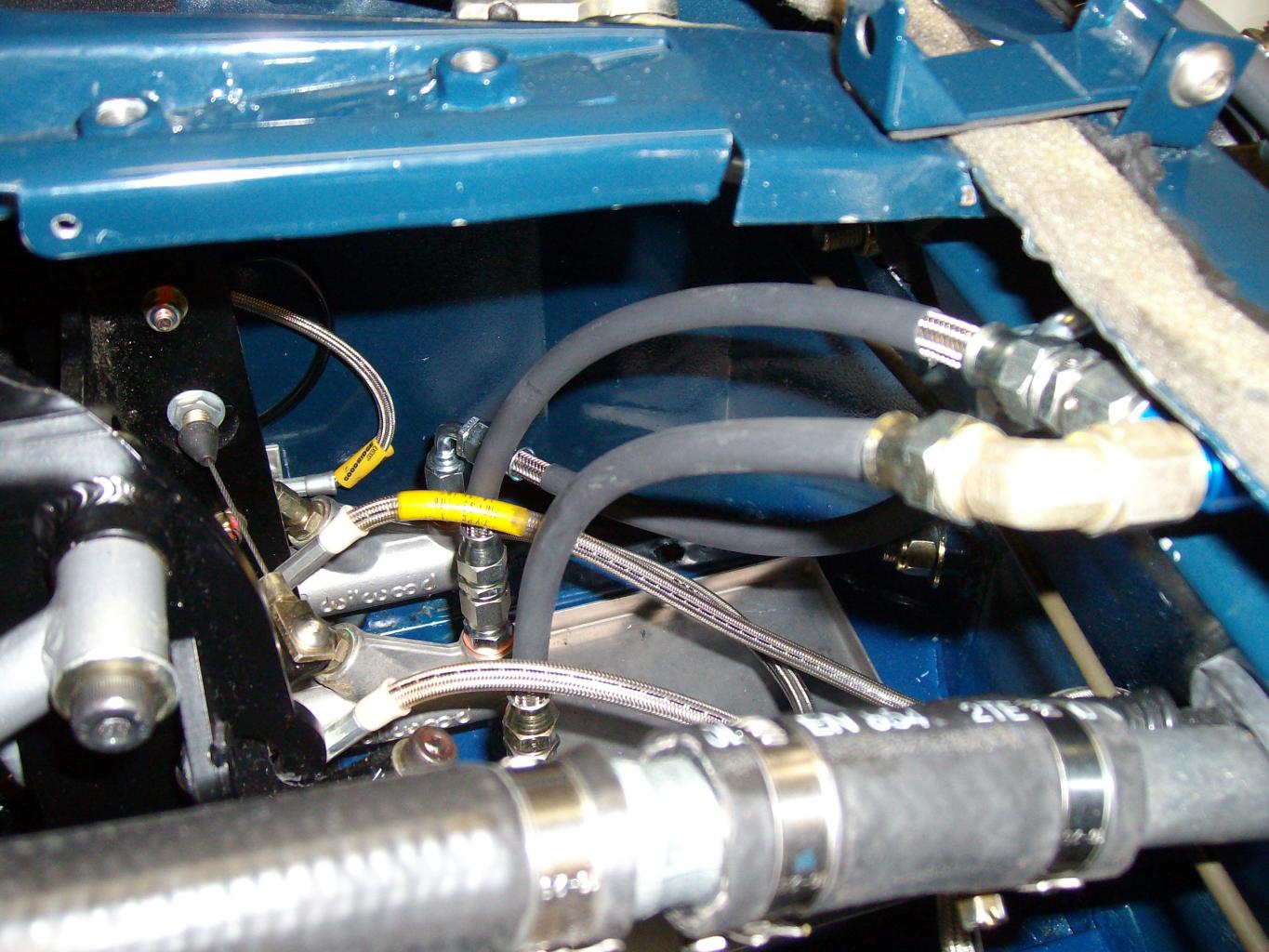

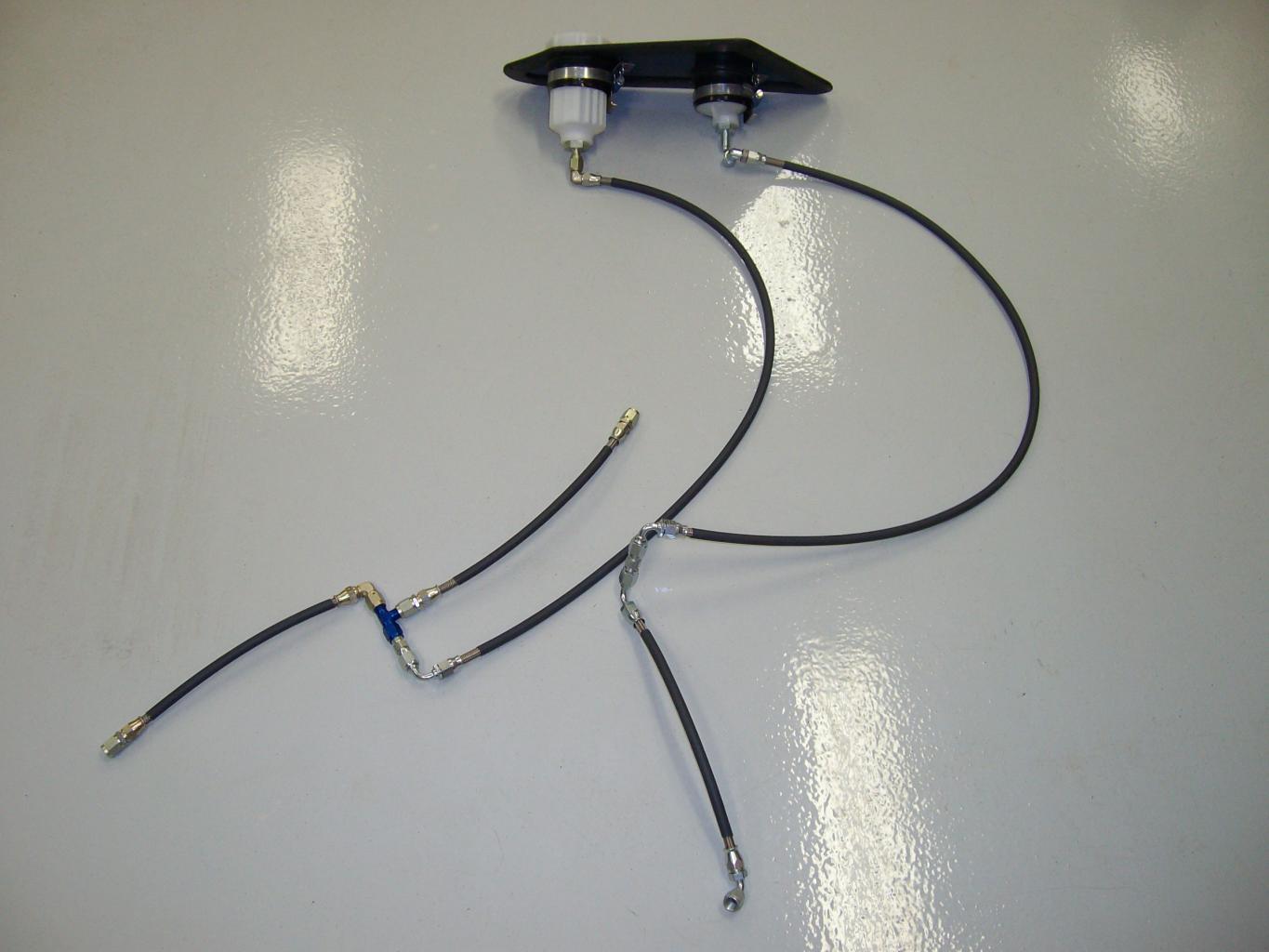

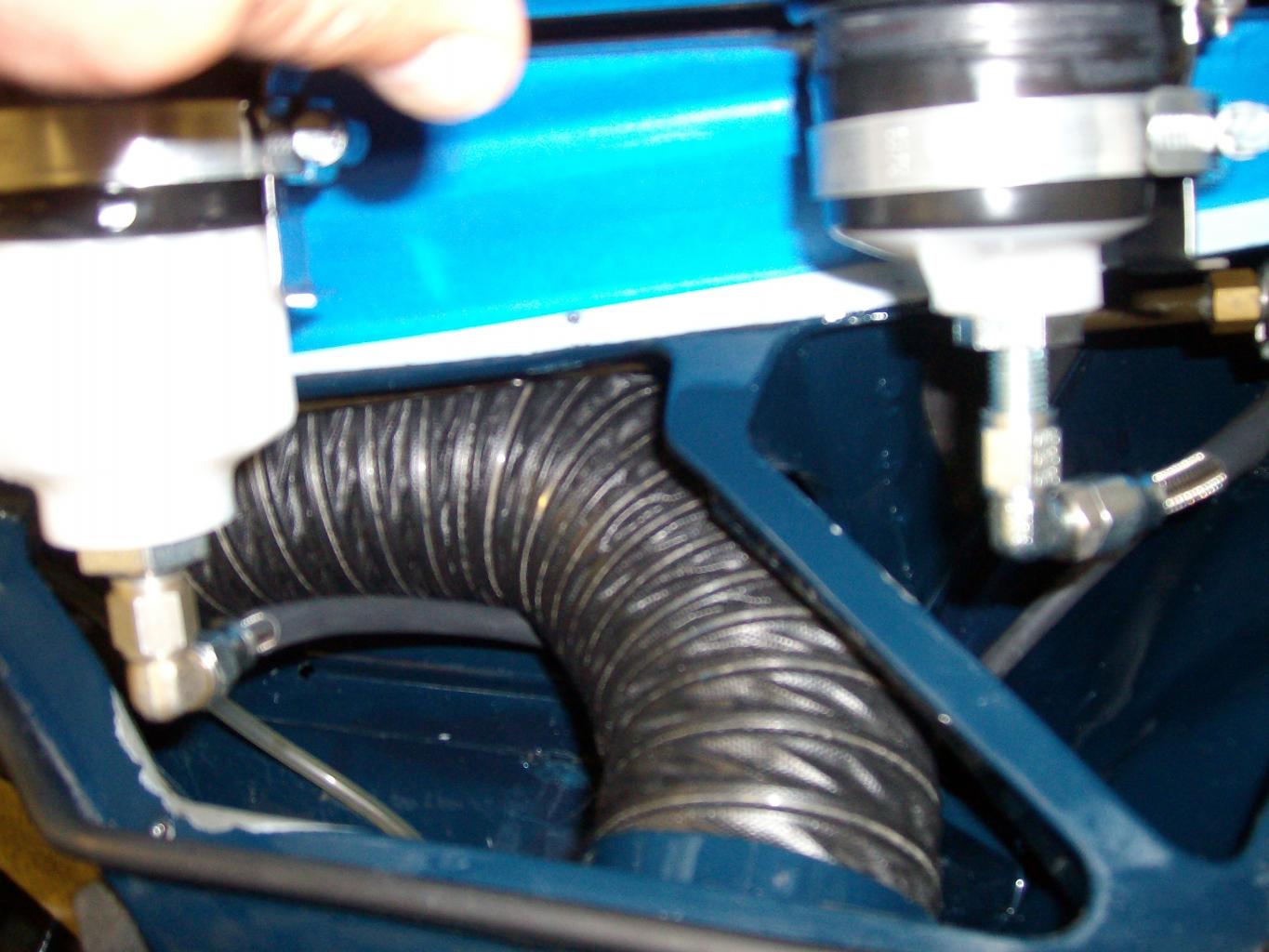

Girling plastic brake and clutch canisters and SS braided lines by Steve
Steve P2125

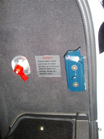

Thanks to Jimmy Mac:

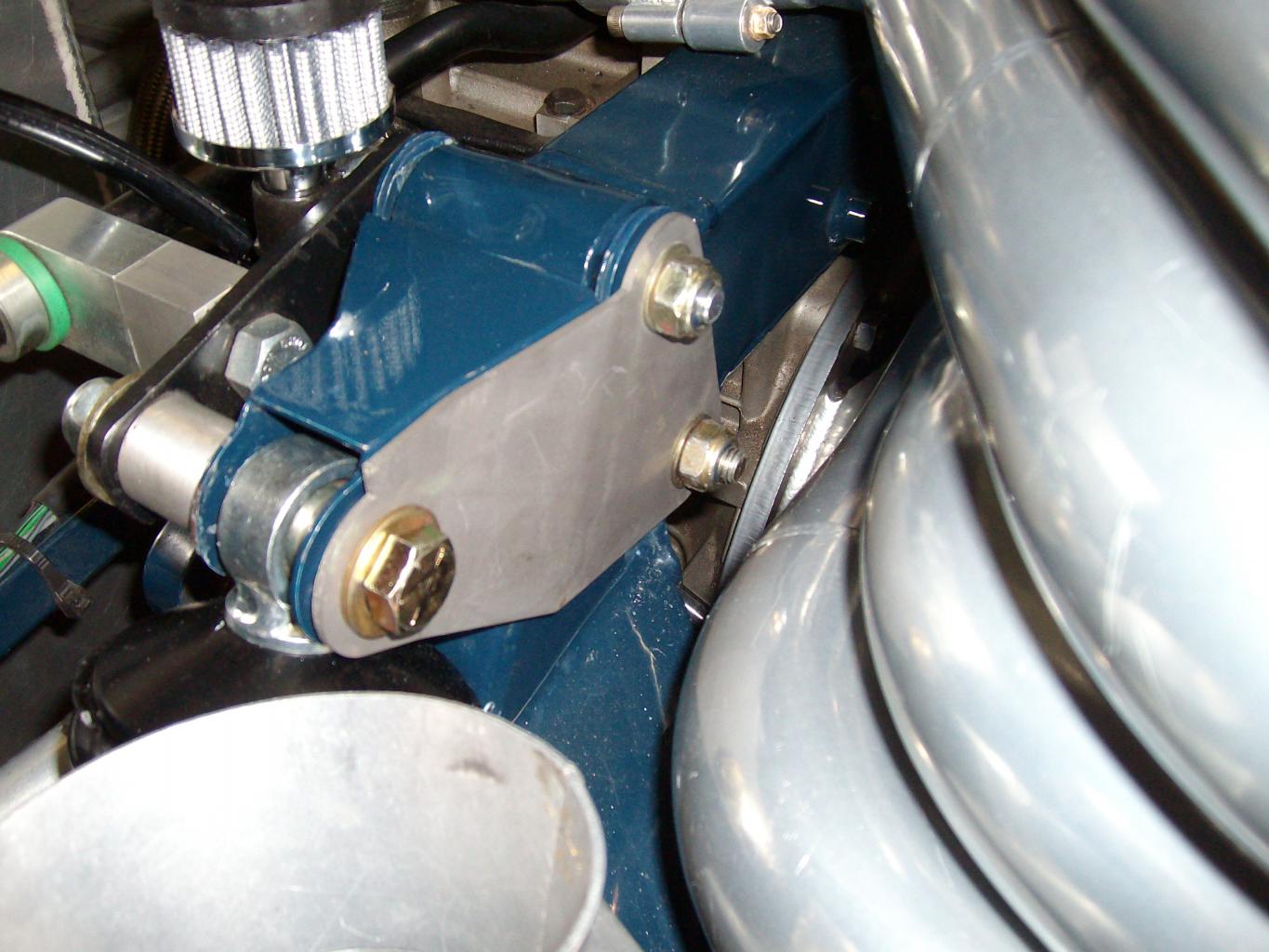

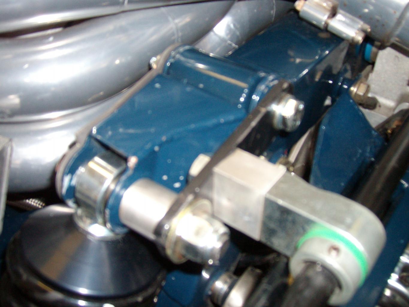

Upper shock mount (front plate) reinforced with Pathfinder kit, rear already reinforced as shown:
Steve C P2125 (MK11 FE)
