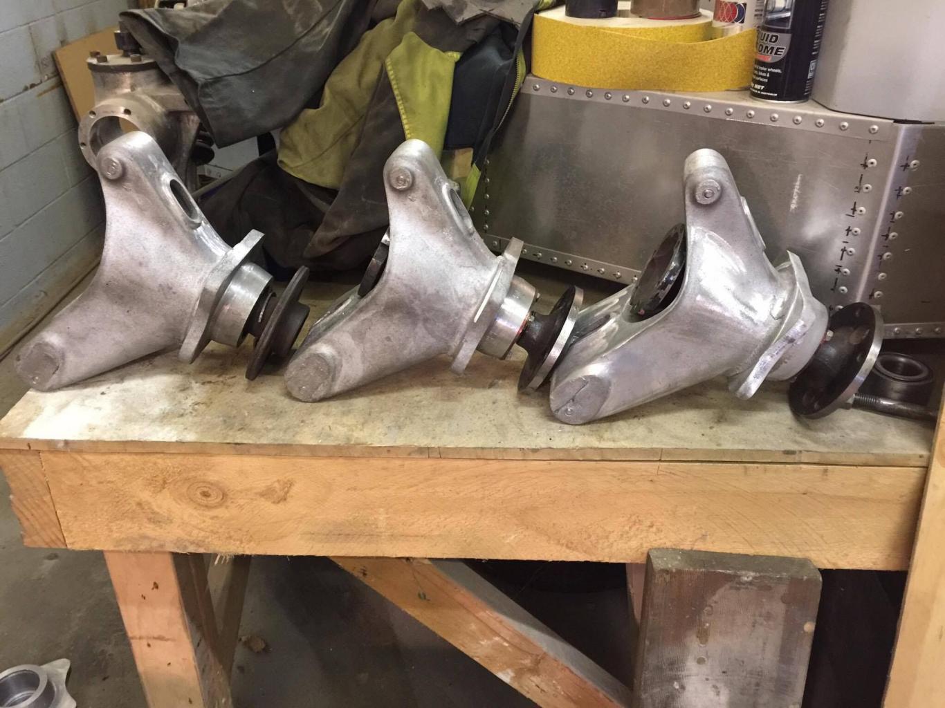

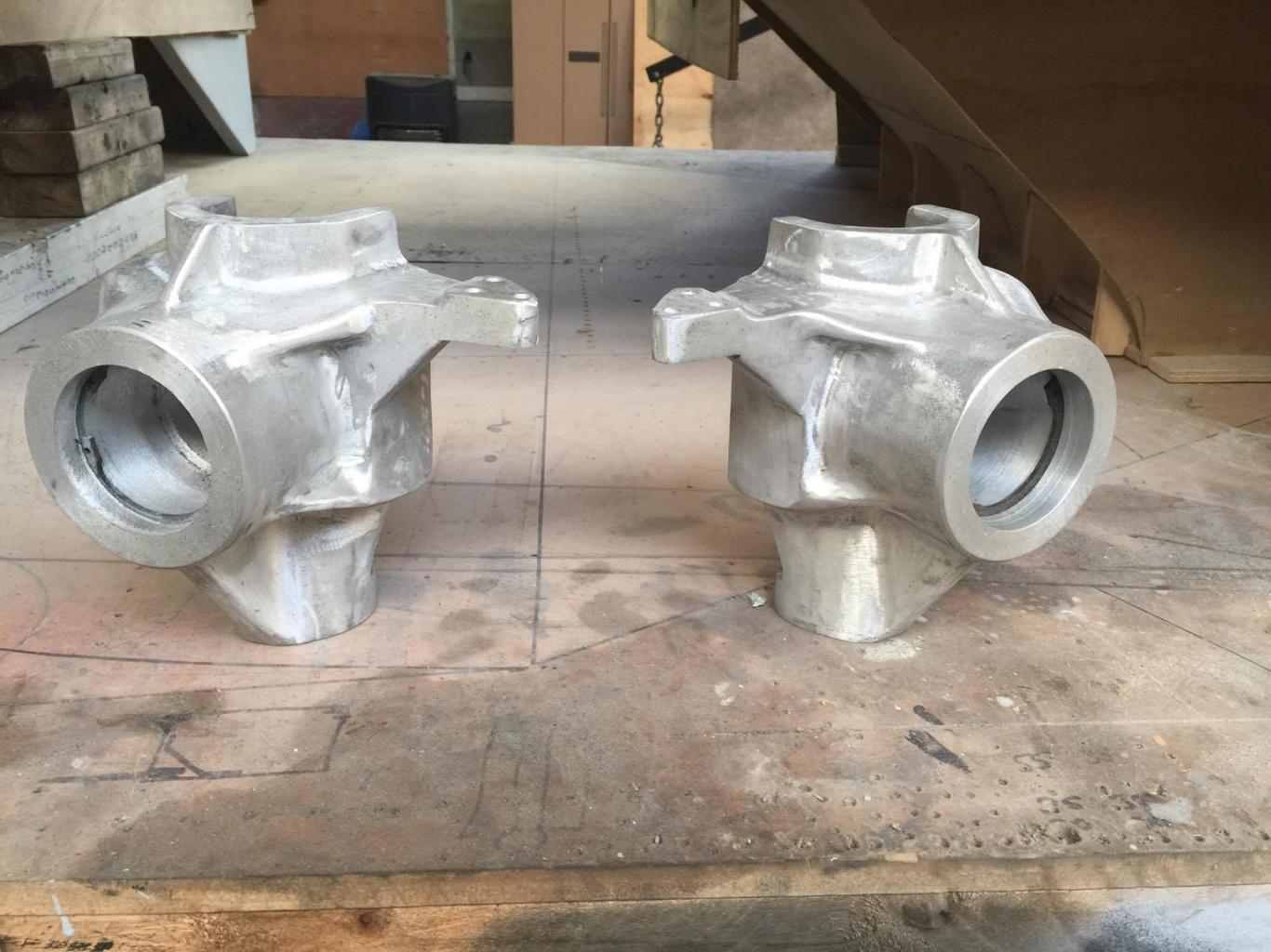

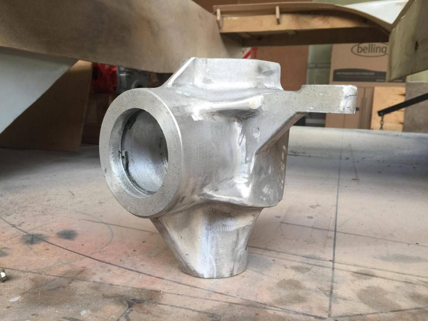

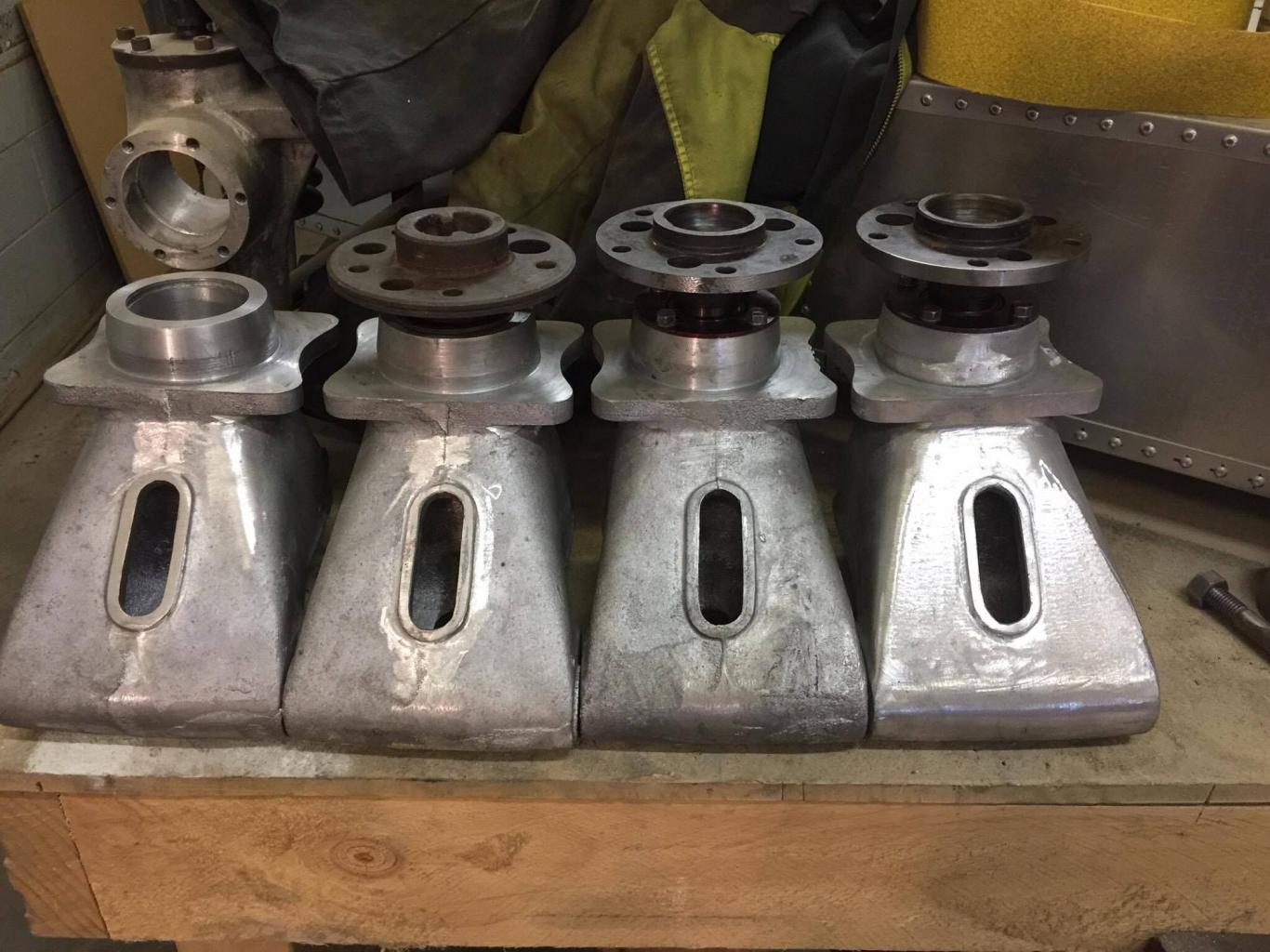

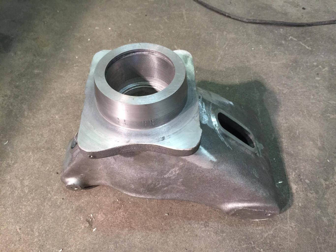

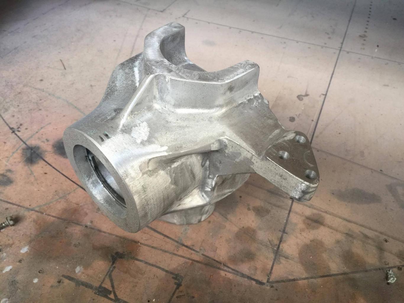

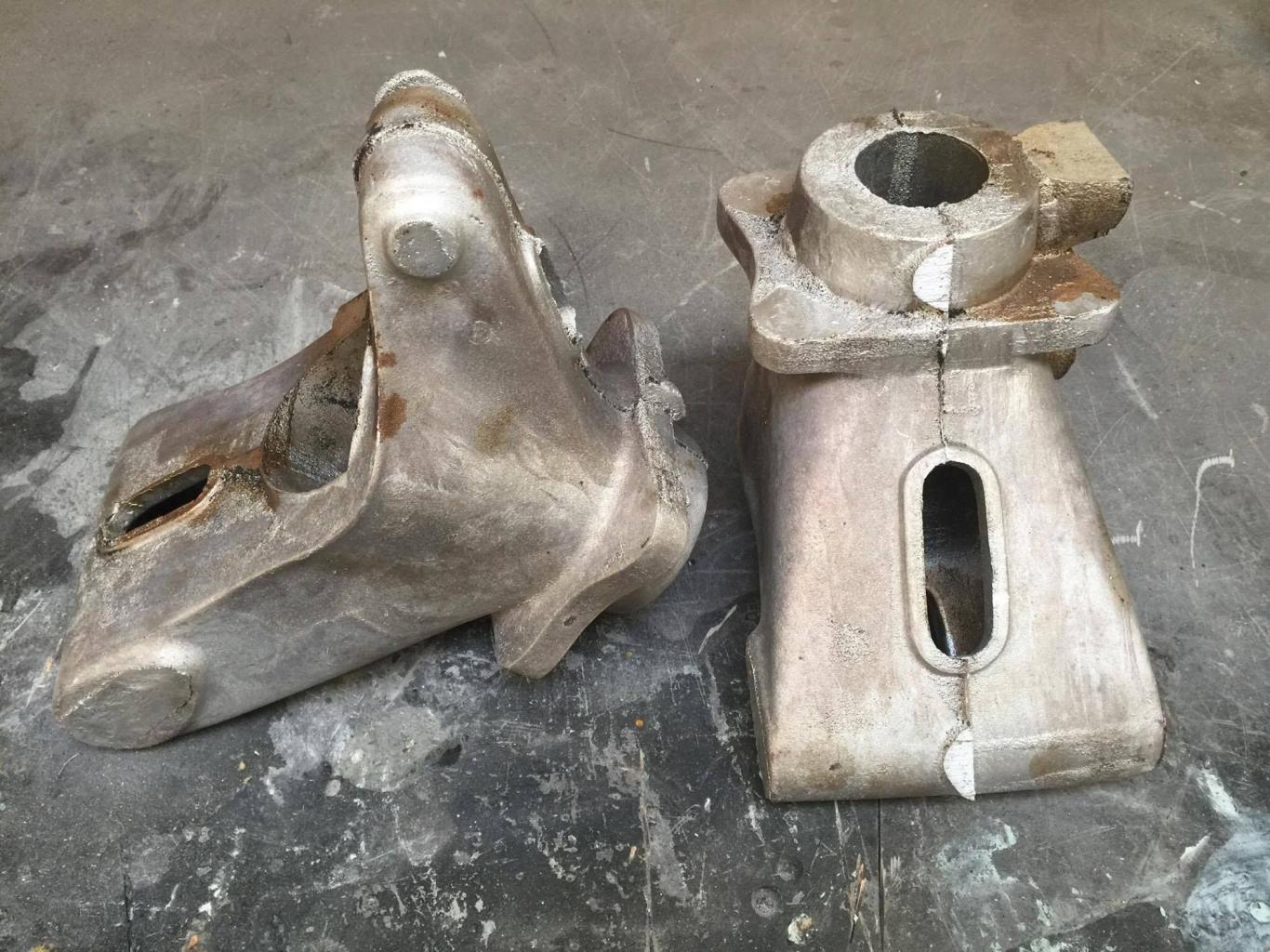

Hey guys, I think its time I started a thread for the uprights and stuff I'm making for my car and other guys that have seen my bits and pieces. I started way back in 09 when I made rear/front uprights for my M20 project. Along with transaxle I have had uprights cast and John has got 2 sets of me and Rod brace is getting a full set made now. The rears are a close representation of a M8F/M20 and the fronts started the same way but with Rods I have made them so both Lug and Radial calipers can be used the rears will have the same set up. I attach some photos of the rears and I will get some fronts up soon. I'm also making Replica M8 wheels.

Not really, they are a copy of M8 McLaren ones, The fronts are nothing like the proper GT40 ones, That said neither are most of the Kit car ones available on the market. The RCR ones are milled from billet, very nice but not authentic looking, DRB do cast ones that are very good as well
6061 then heat treated to T5. It is the same material that Albins and Holinger use for there Cases. I did use 5008 for the first set I made for myself but they were solid not hollow core. The reason I used that was it was age hardening and didn't require heat treatment. I changed after talking to the foundry guys who advised me that the 6061 was far better for more complexed castings.

They do use a special process that was explained to me a few years back when I first got them to cast my first T/A case that deals with porosity it was too complicated for my limited brain power but needless to say I have never had a porosity issue. These guys are the company that casts all of Holinger and Albins cases, so they know their stuff. The Main Guys are Steve and Tom Morrison. They owned a company in Australia that developed most of the Holinger patterns, V8 Super car Trannys, suspension, and injection manifolds for HDT. Cambrian Engineering bought them out about 4yrs ago and Steve and Tom came with the deal. Tom personally makes the molds and pours my stuff, Steve (the Dad) is a pattern maker and has helped me heaps with getting my patterns to a good standard.

I'm going to try to post some Photos so hope they turn out. Ok they did come out. the 4 together are Johns and a set for a friend of Johns. The Raw rear ones are for Rod and the front ones are also for Rod They just need the Bearings and Axles pressed in and the top mount plate. I will post some pictures of the other things I'm doing as well
