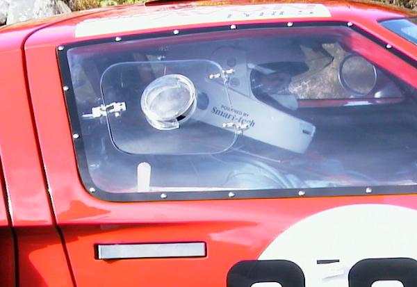

As fitted to Roy Smart's Mk1 GTD
Thanks, Paul. Those look easy enough to install! I like the idea of putting them in the "flip out" windows--I can take those off and drill them out with a lot less fuss than removing both side windows and their approximately 500 screws apiece-- ;-)
Malcolm
To fit these vents, use the hole saw as Jasper suggests and then the vents do just pop in. They have a lip on the inner side which hooks them onto the window material. Suggest you tape the window when drilling the hole in case you slip with the drill!

Thanks to everyone who contributed to this thread. I bought a set of the vents from Wicks Aircraft (Aircraft Spruce never responded to my inquiries). I installed them both in my rectangular "flip out" windows yesterday. It took all of 20 minutes and I never even had to remove the windows from the car. I taped the windows as suggested, measured and marked the center spot, drilled a small pilot hole, then cut the hole using a 3 1/4" hole saw in my electric drill. As suggested in the installation instructions I drilled partway through from the outside, then taped the inside and drilled the rest of the way through from there. I cleaned off any excess "flash" from the hole (there wasn't much at all) with a small file, then used a hair dryer to heat the snap vent a bit, just to make it more flexible, and "snapped" them in. I didn't get to drive the car to check out the effects, but every bit's got to help--
