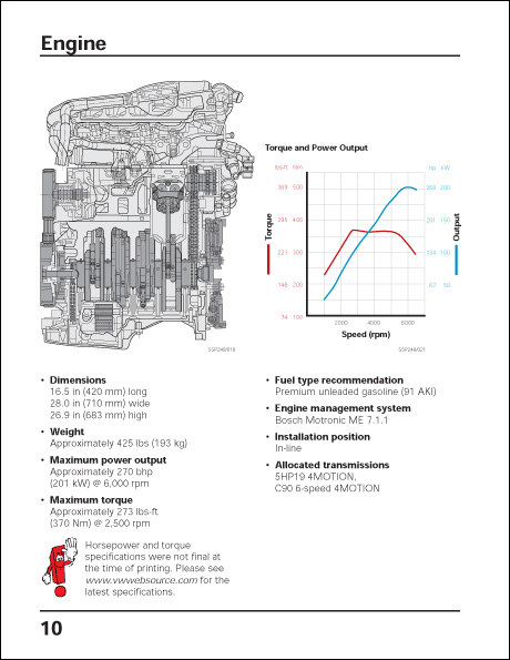

A post from a Volkswagen forum that gives us dimensions of the W8:
W8 Specs that vw are not telling us
04-11-2009, 02:13 PM #2
Firestarter
Hi,
Here are some approx. fitting dimensions for the W8:
700mm wide (from Cylinder Head Covers)
500mm deep (Front Pulleys to rear Crank Case)
600mm high (Top Cover to Oil Pan)
Tuning Options: Chip Tuning (Wetterauer), Custom Valve and Piston rework,
Custom Cams, Custom Air Intake, Custom Exhaust (Audi mod).
No Turbo or Charger recommendation!(note: that is, for its original installation in a Volkswagen Passat -Les)
