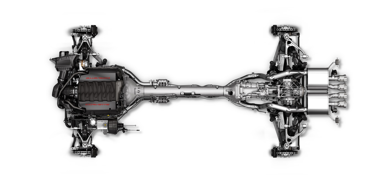

Okay, but with a reeeally short engine (like, a turbocompounded rotary from a Mazda), the new transaxle from the latest Corvette looks awfully good . . .
Sigh . . . .
They are changing the transaxle set-up in the C7 Corvettes? I had not seen this yet. I guess need to find more info.
Only issue I see from this pic would be how wide it is.
RebecaLynn:
Autoblog.com reports in its article 2014 Chevrolet Corvette Stingray: Everything there is to know [w/video]: "
. . . the all-new seven-speed manual is a Tremec unit, and it incorporates rev-matching for both downshifts and upshifts (it's also defeatable via a steering-wheel paddle). We've seen rev-matching tech before, but generally such systems only goose the throttle on downshifts. This system is predictive, too, in that it "sees" which gate the gearshift lever is going and adjusts its response in anticipation. Engineers are particularly proud of the fact that they've gotten cylinder deactivation to play nice with the manual transmission (it might be the industry's first such application), as apparently it's much harder to get variable displacement technology to play without a torque converter to smooth out transitions.
Here is a view of the entire C7 Corvette Stingray drivetrain, viewed from the top. Perhaps it will help you gauge how wide the transmission is.
full
The Corvette transaxle has the transmission gearing in front of the axles thereby making the overall length of the unit plus V8 too long for the SLC.
