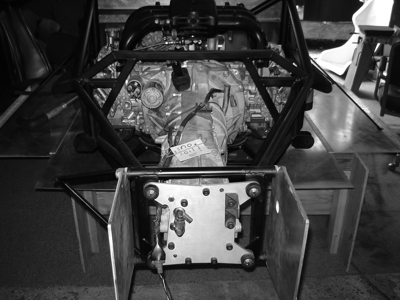

One note on the Subaru box. It has a shaft within a shaft going to a center diff that is attached to the box. To use it in a mid engined application requires a special internally splined part made by Bremar. - the Bremar Automotion setup removes the center diff (this makes the box shorter by approx 6" and lighter) and redirects all of the torque previously
going through the center diff back to the front axle/differential. I got it from these guys -

Then I made a plate that seals off the end of the transaxle and also serves as a mount.

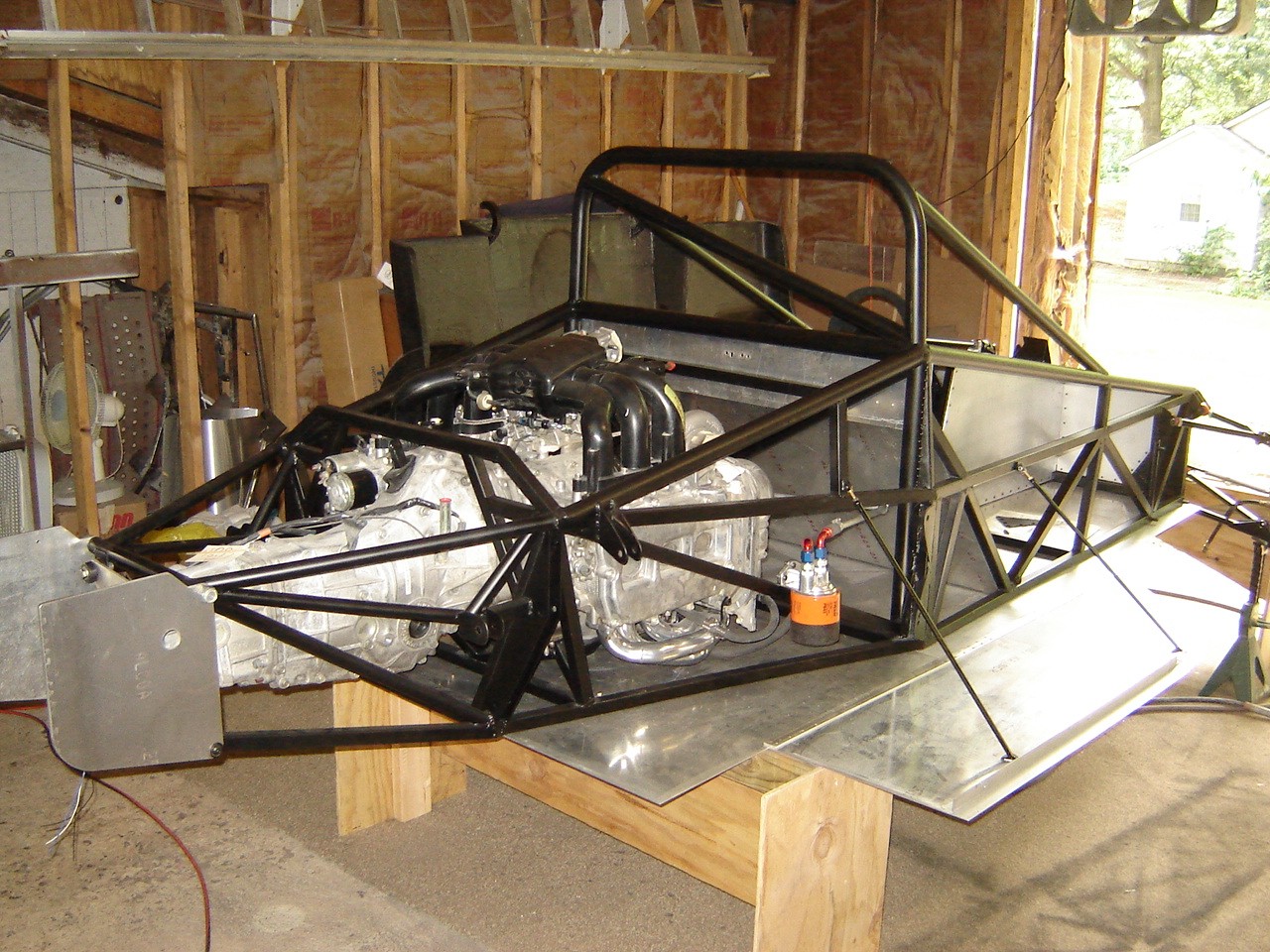

Subaru drivetrain
The 6 cyl Subaru engine is only 3/4 in longer than the 4 cyl and mates to the 4 cyl gearbox.

Re: Subaru drivetrain

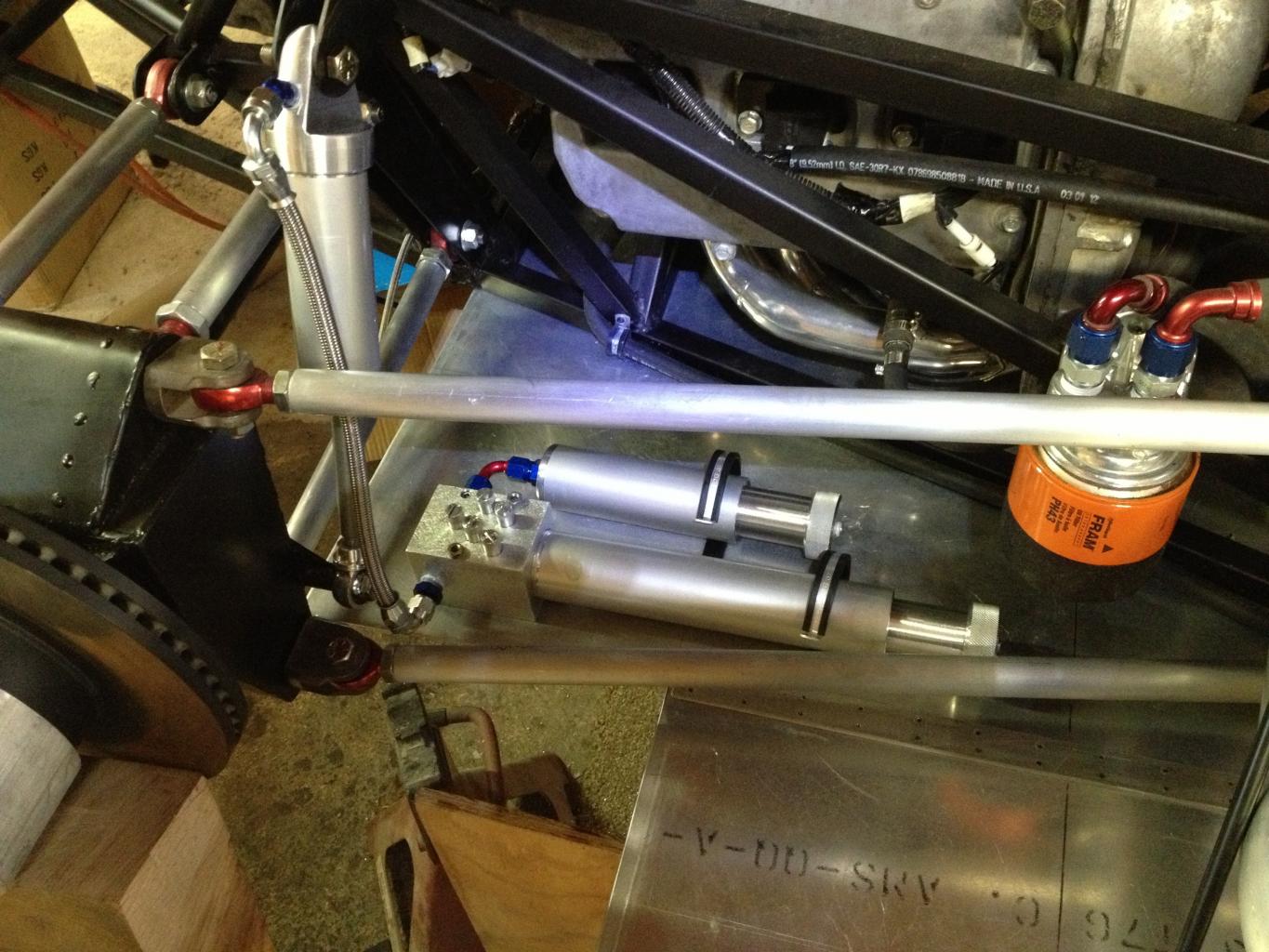

open 2 seat track day car, tube frame, mid engined 3.0 6 cyl turbo Subi. Carbon bodywork. Gas spring suspension units - adjustable spring rate, ride height and 5 way adjustable damping.
Expect it to weigh ~1800 lb. w/ 440whp - will know soon as it should run next week.
