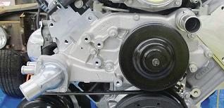

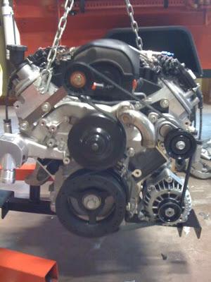

LS3 & LS7 Pumps Below left two
As you can see those that come from the factory seal off the out let and weld on at sharp 90 deg. You can see that makes 2 sharp 90 deg bends right next each other. They are just on one side or the other of the pulley.
The way the factory center right

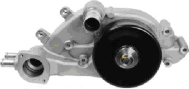

I found that the truck engine has no sharp bend in the fluid, if they just cut the outlet and rotate the direction needed. The piping would be behind the belts. And would increase the flow of water help to reduce the over heating problem. This pump is less than $60.00 from RockAuto.
Truck pump is far right.
When I build mine I would use the 5.3L truck pump.

Unfortunately the truck pump has the wrong belt offset. The pulley sticks out much farther and will contact the aluminum firewall crossbeam. You can only use the Corvette offset (short) drive setup..
