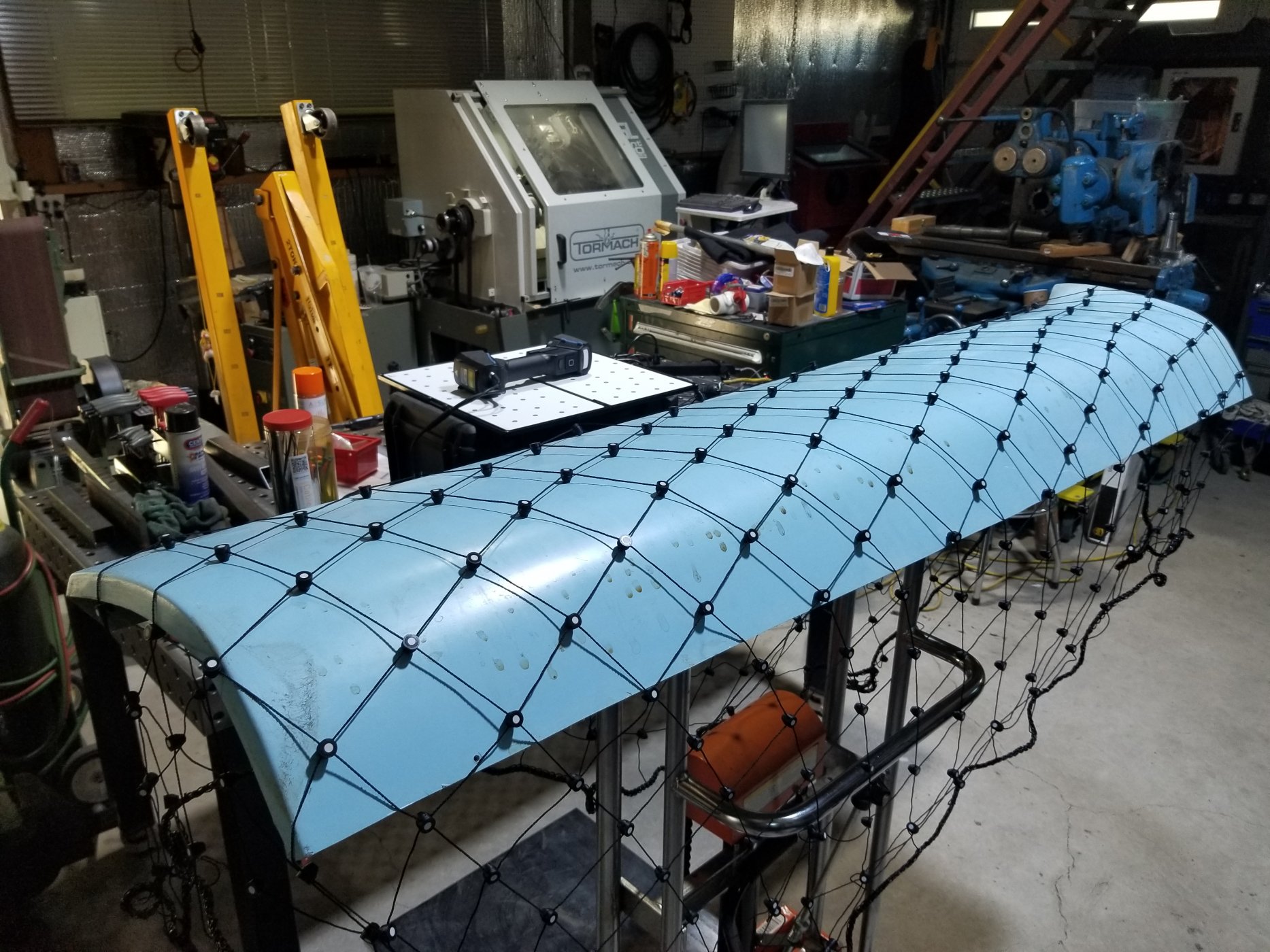

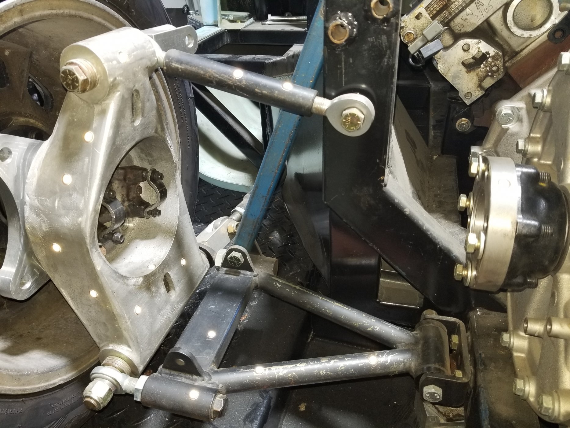

Since I'll end up building my own tanks I scanned the tank body panels. The net draped over the panel has targets for the laser scanner. You can also see them on the suspension parts.

Hello Ryan, I bought this net from a German company Called Aesub. It was around 600 bucks. It does speed up the process but depending on the scan there
is a little more cleanup because of the net grid. Kind of a trade off.

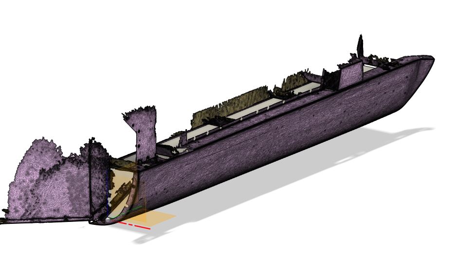

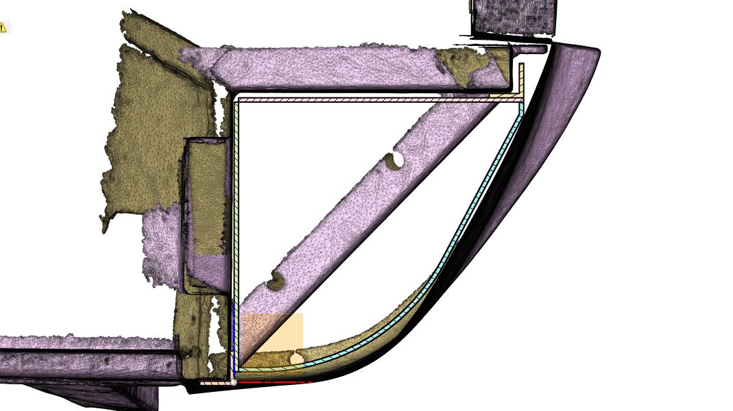

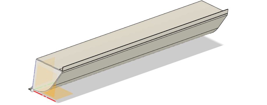

These pictures show first the left side sill area where the tank resides. I ended up scanning on the car to account for any springback of the panel. In the end there wasn't much. Then I scanned the chassis. Put them together in a model. Determine by cross section what space there was and finally designed the basic tank. I was given dimensions that were close but it would have been a disaster had I built the tanks and found out the panel wouldn't fit over them.
