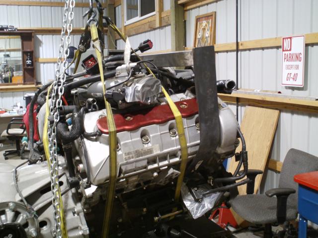

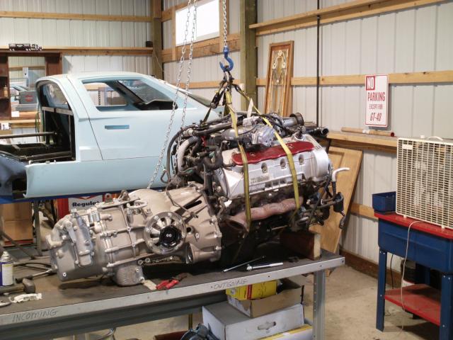

This DRB #83. The engine is a 4.6 supercharged Cobra. The tranny is the Ricardo. I should be fitting the engine /tranny in a couple of weeks.
Pete

That's right Randy. Finally get to work on this beast. I decided early on I could make this combo work. The DRB chassis was designed to handle up to the 5.4 non supercharged. I accepted the fact I was going to need to modify the chassis. I'll also be able to move the engine/tranny forward about three inches. I'm fabbing an engine lift bar as we speak to aid in the install.

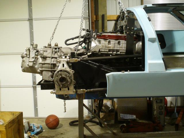

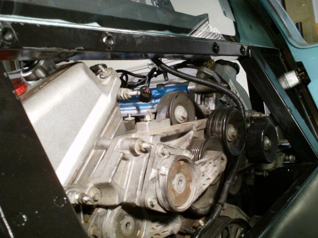

Okay, so here's the first stab trial fit. The variable is the Ricardo at this stage. I need and have two inches of clearance to set her in. I will need to move a cross beam as assumed for the bellhousing area.

Pete, are you going with the original 4.6 ECU or a stand alone unit like Electromotive or Fast? Nice that you can put a flat panel on the engine firewall, the modulars are shorter.

Pete, looks like your transaxles output is pretty much right in line with the hubs. You could probably be OK with an inch or two of off-center if it meant not catching your hairdo in the pulleys on the front of the engine....
