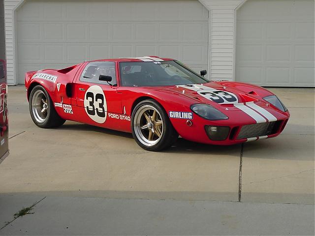

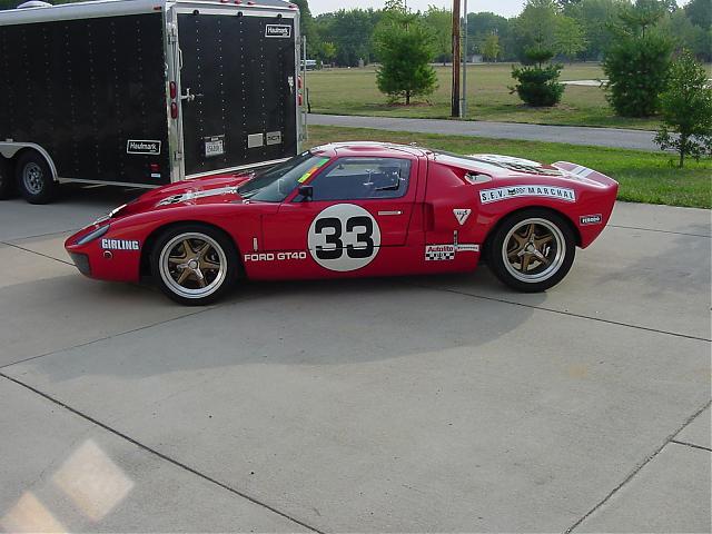

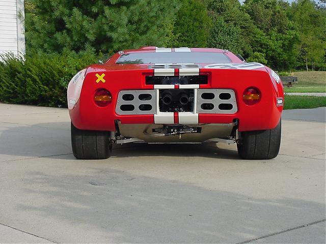

Well, here it is! RCR 33

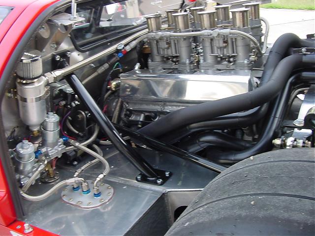

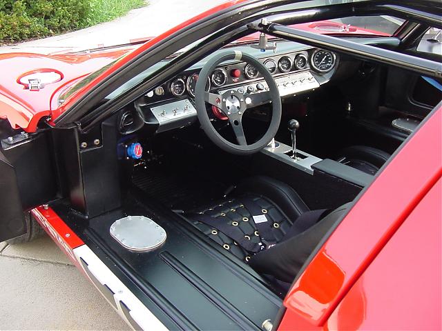

I have been so busy trying to finish the car that I have not had time to update the build thread. The car is mostly complete with just the little stuff to sort out. I wanted to share some pictures with those that have been asking and to say thanks to all of you who have been such a huge help on this project. If any of you have any questions, I would be happy to answer them. Here is the run down on the car.

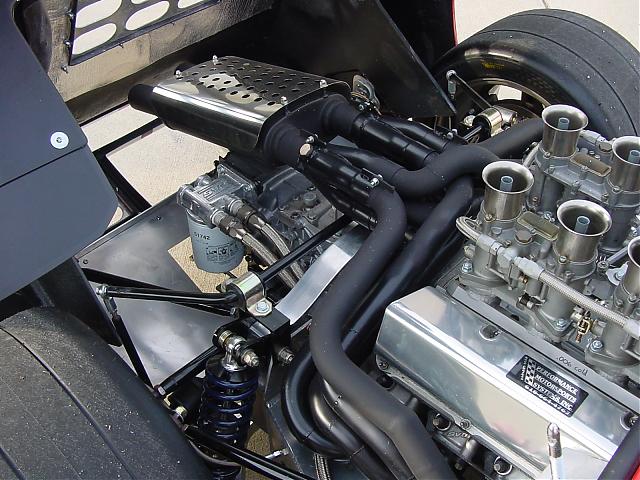

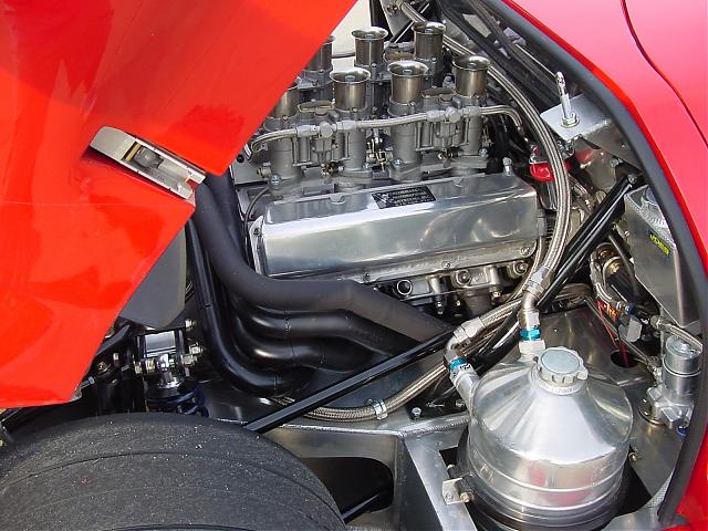

The engine is an aluminum block, 8.7 deck 302 dry sump stroked to 380.
Heads - Yates with titanium valve train, spraybars in the covers
induction- custom 3 piece intake with 48 webers w/ 46mm chokes
rotating assembly - billet crank, crower billet rods, custom diamond pistons, 10.7 to 1 compression
Clutch - Mcloed Magnum Forse 8 inch dual disk with billit aluminum flywheel
ZF transmission
3 fuel tanks (2- 15 gal. 1- 3 gal. swirl pot)
Dual swaybars, dual adjustable shocks
Full roll cage
Tons of other stuff that is top secret!:D

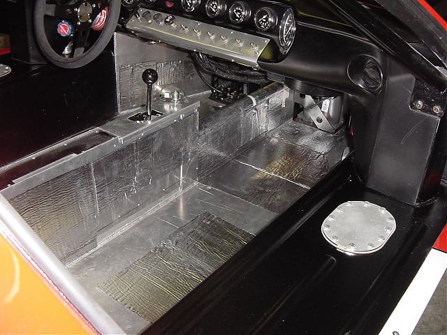

More detail on the center console (tunnel), body latches and rear upper hood pins please!!! :D

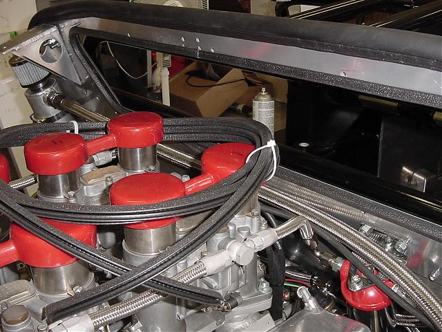

That is incredible. Absolutely incredible!! I would like more information about the bulkhead window. It looks like a rubber seal??? How do the shoulder harnesses attach? More pics of the inside pleeeeeeeeeeeeeeeeease!!

Neat, very neat, especially the engine bay.....:)

Bill, the seat belts wrap around the rool bar on the inside. The rear window has a self gripping edging from McMaster-carr pressed on the firewall and the carpet. The window is on the inside then the frame. Here is a few pictures.
Randy the latches and rear bonnet latches came from Fran. They are nice peices but very expensive. Fran didn't even make a dollar on the transaction. The center console is detailed in the following pictures. It holds a series of switches that allow me to lock out my timing or set a curve or retard the computer 1 - 4 deg.
