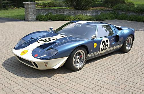

1966 GT40/1017 was a light Blue like the Gulfs but it was more like Cambridge Blue. In fact when Scalextric release a model of it the younger people called it Gulf colours!! FAV team colours were for the 1965 season Linden Green. I quite like transfering the early MKII colours scheme of white body but with a dark satin Blue bonnet. If you want a different colour scheme try the unique tri colour bands of GT40/1080. Or if you want to be real 1966 try all over Silver like the MKI in the GT40 brochure.

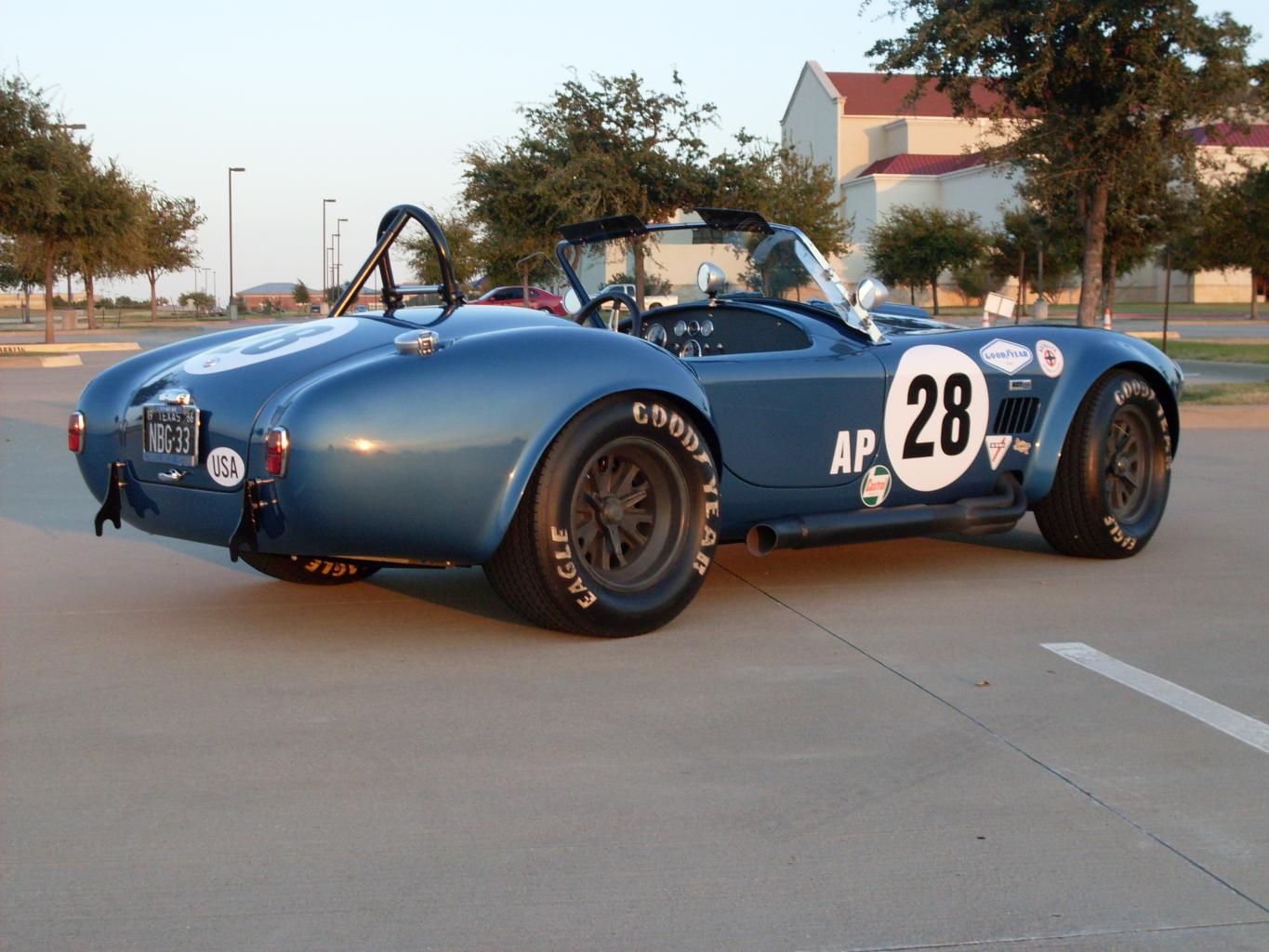

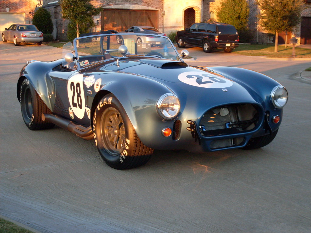

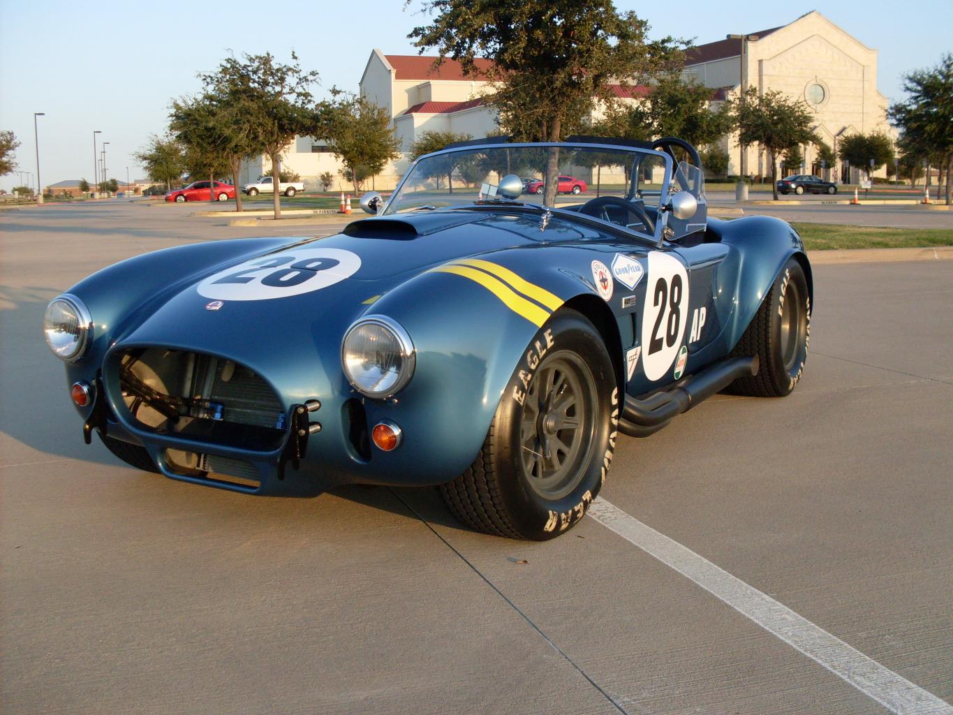

Bob,
The guardsman blue on your left sample from Du Pont is the color that was on my Cobra and I agree it looks like a tint of green in the sample but looks pretty good on the car.
