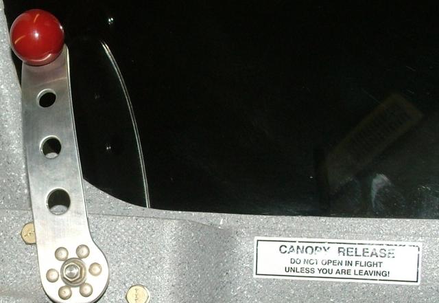

Zolatone is a type of textured speckle paint that is used on the inside of fiberglass boats and aircraft. the speckles help hide the rough glass surface and can be applied on fiber glass without primer. here how it looks painted on the fiberglass weave of the inside of an aircraft canopy frame. Zolatone
