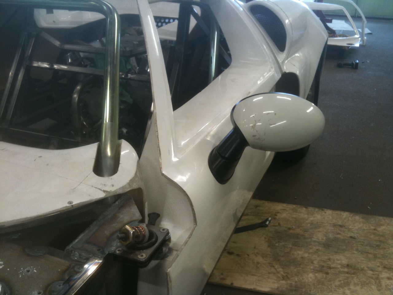

Mini Cooper

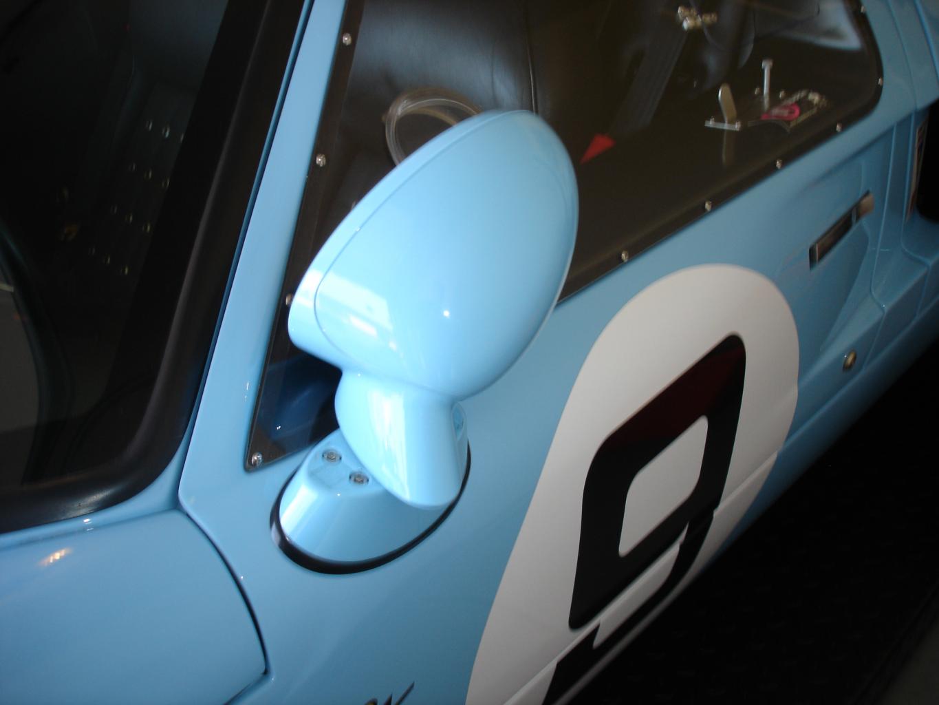

vitaloni california
fit perfect with a little upward angled base ( rear bolt onto window, fron bolt onto door)

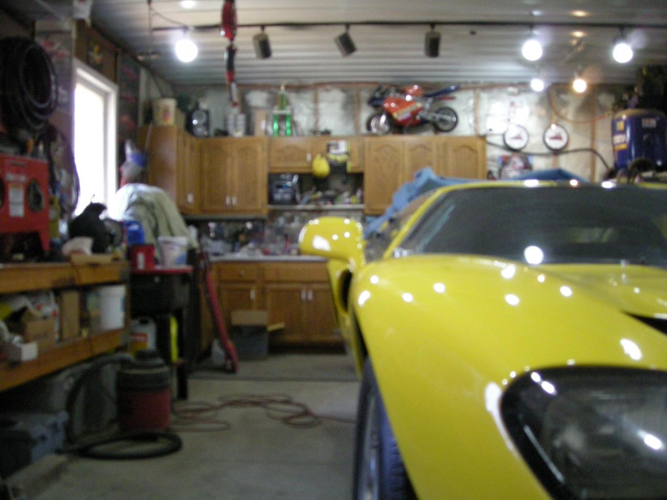

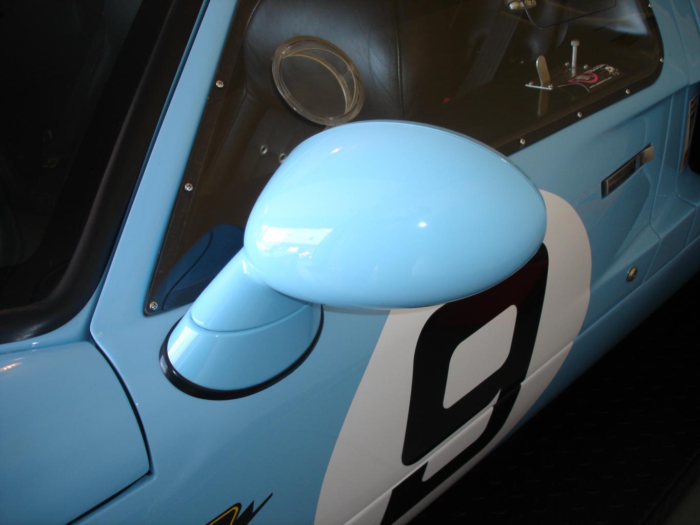

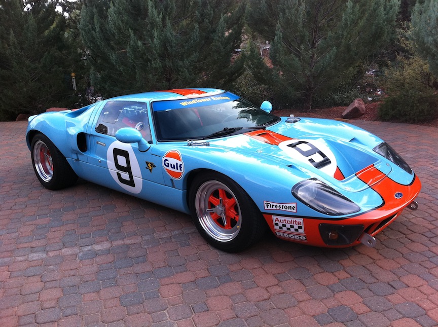

My car originally came to me with CF racing mirrors that mounted to the corners of the side door windows using the window mounting holes and set screws. Effective but not very original. I'm now using original (on some cars I believe) Raydot with convex glass in them.
These are from a dodge stealth or Mitsubishi 3000 GT power and work great
Bob

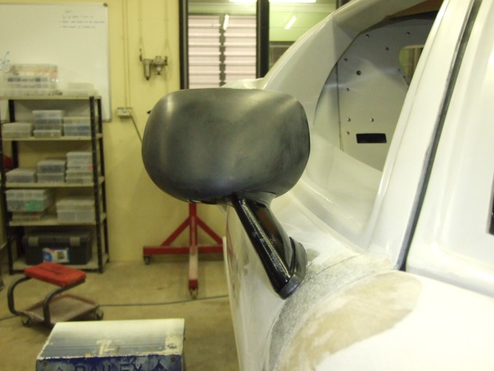

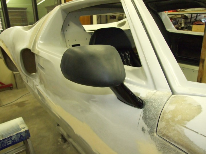

Early RX7 mirrors mounted slightly different to Bill's

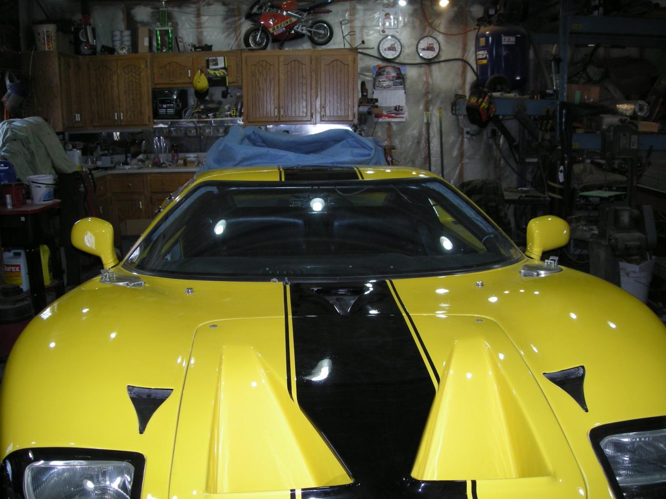

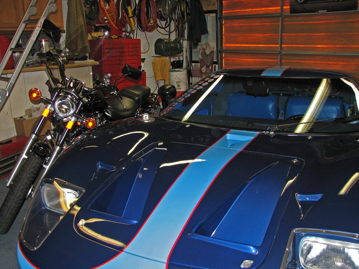

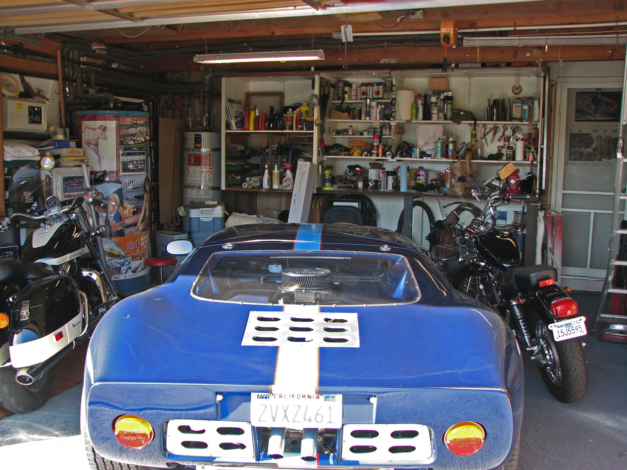

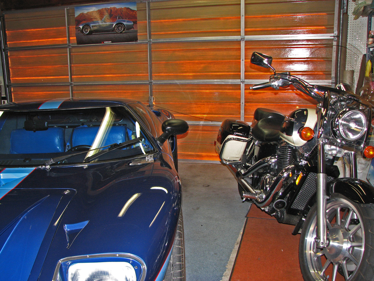

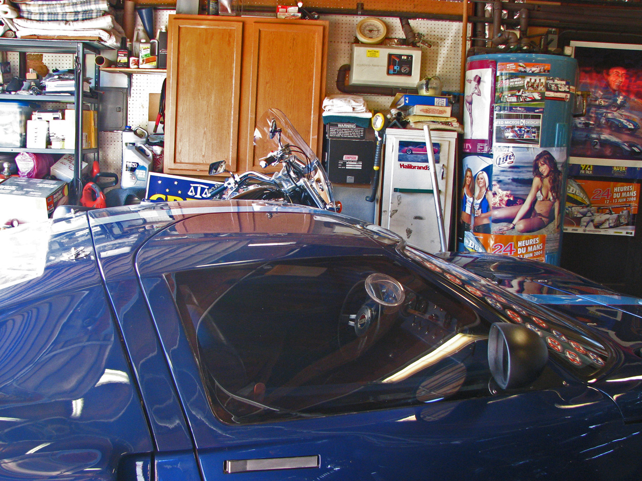

A friend needed a place to store he and his wifes bikes for the weekend. When they were parked alongside each other it gave a great perspective on just how low the 40 is when compared with what else is on the road! The pictures also show what Chrysler Cross Fire mirriors look like, mounted on the lower front corner of the window.

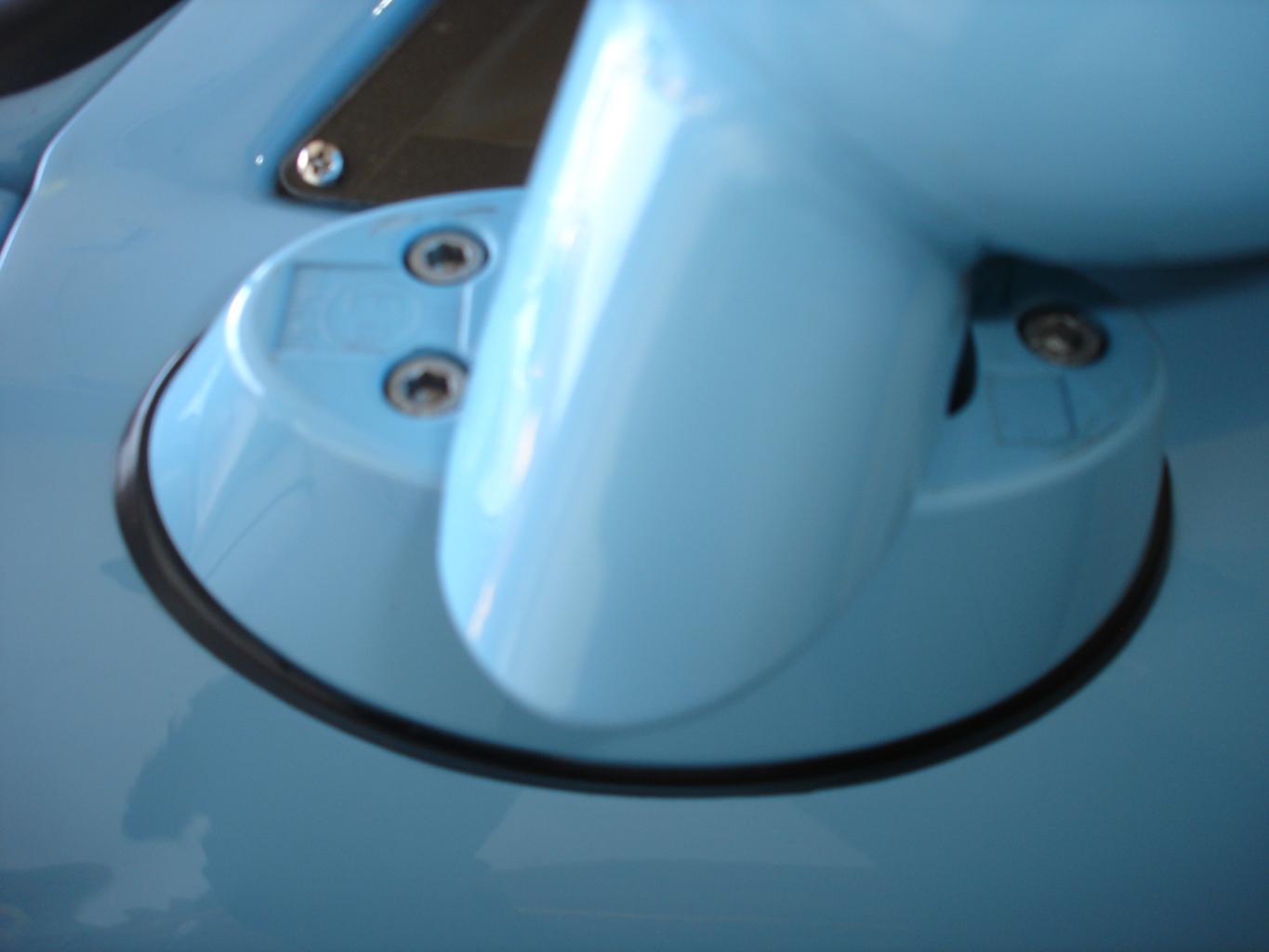

I bought a set of Mini Cooper mirrors (inspired by your car), could you post a few close-up pix of the mounting position on the door, perhaps from a few angles, so i can see roughly where to start positioning them? What controller knob do you use?
As requested. Mirror power controller & basic wiring is off the mini cooper as well.

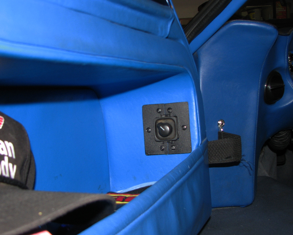

Personally recommend you do a hybrid switch from another manufacturer. The Crossfire one is designed to mount into the centre console, so unless you can butcher a console then it may be easier to get a nother mirror switch. Just a thought.
If you want to see why, I can post pictures of the Crossfire switch (which I have a new one of). I have reverted to a mirror switch used in the Fiesta.
Brett

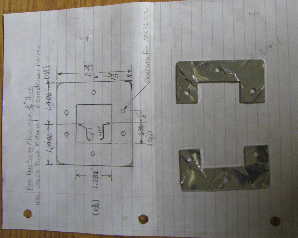

Mounting the CrossFire switch is no big deal. Make a split plate to fit in the grooves on the switch and mount in the drvers door. see attached.

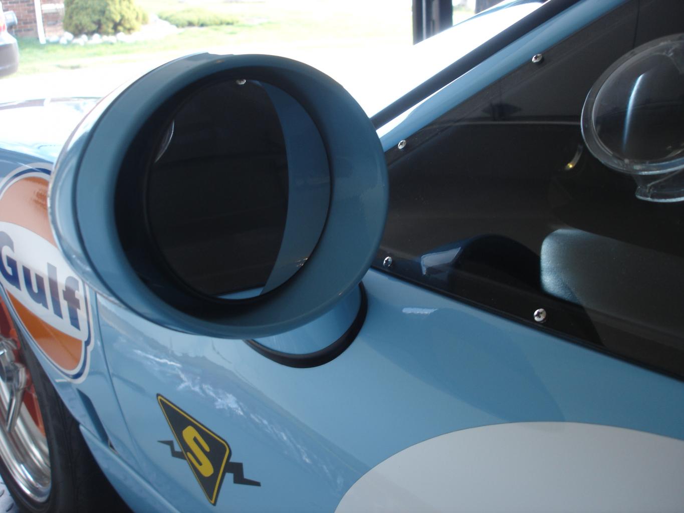

I located mine in a bone yard. They are electric ones and should give good performance. I have the wide body and there isn't much visibility so went to 120 degree cameras. can you find them?
They have to be reversing cameras so you can orient them to your monitor(backup). The internals and mirrors have to be done away with. I mounted mine to lexan, then mounted to the mounts and got some glass cut and mirrored. That was mounted to the lexan with 2 part epoxy.

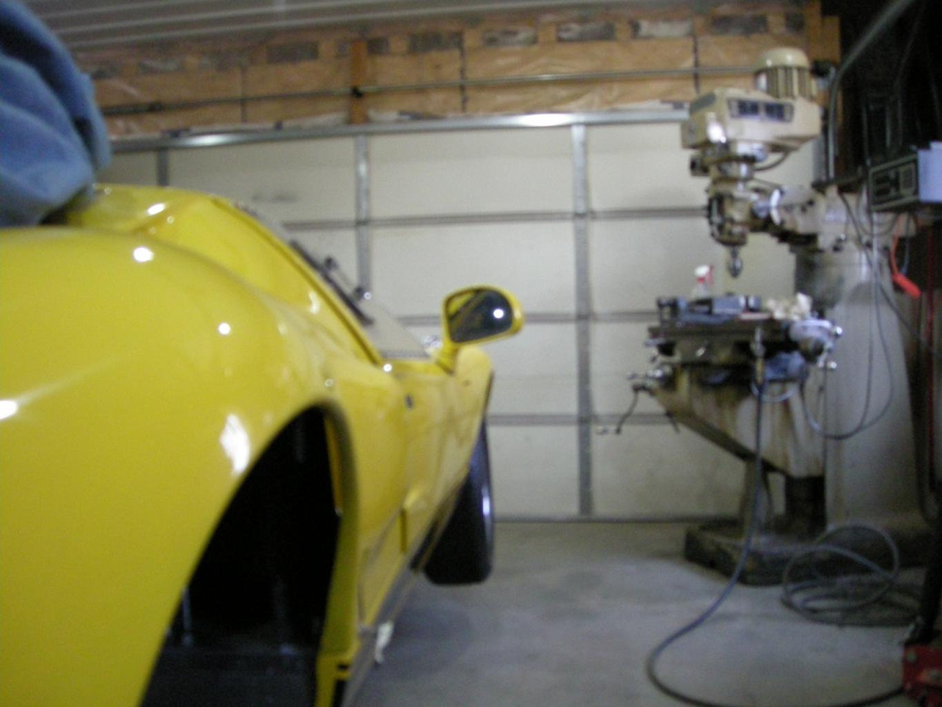

Picked up a set off of a 1992 Mitsubishi 300GT at a local Pick-n-Pull place. Must have over 1000 cars there. Cost about $60 for both power mirrors and the switch (also has an incorporated dimmer dial...may have to hook one up when I get to that point).
