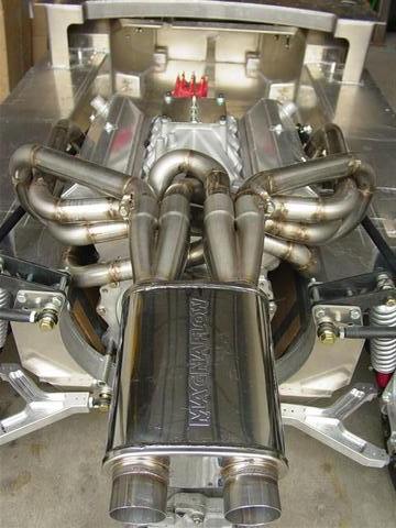

The one that is on my RCR40 is a Magnaflow. Exhaust is 2" tubes. It looks bigger (longer) in the photo and I was assured that it would be loud... Mission acomplished :) I don't have the model number but should not be too hard to find from their site.
[edited, forgot the photo]
Sandy

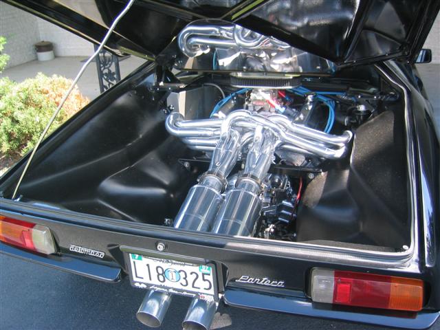

My Pantera has 180 deg. headers with two seperate Magnaflow mufflers. To me,at idle nad cruising speeds,it isn't too loud.At full throttle,it is quite loud.It has an incredible sound!!

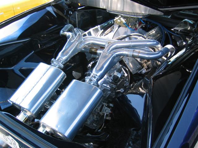

Ron: you are absolutely right about the single muffler masking the crossover sound.I tried several; configurations on my car .A chambered muffler(Flowmaster,etc...) will also mask the crossover sound.
