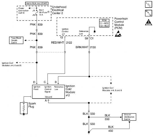

Bill, I tried the corvette coil packs with my electromotive EFI they have built in amplifiers and did not work at higher RPM. The problem you may be having is not in fuel air but timing. After removing the coil packs and using the individual coils I believe I showed you at RA my problem went away. If the Fast system has been using these coil packs then disregard this message. But the coil packs are triggered with a 5V positive pulse from a GM EMS as were most other systems fire the coils by ground. I have electrical diagrams of your coil packs if you need them PM me your email address.

Last night around 6:30 we solved all the problems(I think). But you know about Gremlins!!?? I worked on the car for a day or two trying to fix a pesistant oil leak and a few other minor things, and then took it out to the shop that installed the system. I also roamed around the FAST web site. They make their system for the LS1 Chevy and like to use their coils. Just had to add that feature to my setup, which they had done. The guys at Brad's shop(Atlanta Chassis Dyno) fixed the oil leak at the oil filter. The fitting was an old one and on the 37 degree face there was a flat spot. I guess you have to be careful in buying stuff on Ebay!! So that was cured easily enough.
The first problem to be looked at was the alternator. They found an Electric shop that thought they had the cure. It was over in Monroe, Ga. about 30 miles away. Took it over to them. It is a little town where guys sit around talking in the main bay and one guy does all the work. Can't beat small town living. They, or rather he, tested the alternator and it came up pretty good for a 200 amp unit. He told me that since I had so much power eating equipment(electronics) that the system was trying to charge the alternator to hard and it was overriding the system, as everything was wired properly. What he did, was to convert the alternator to a one wire system. Changed the regulator and that was that. Tested the alternator and it read better than before. Hooked it up to the engine and it worked perfectly. No overheating.
The next problem was the exhaust heating issue. I had a small hand held temp sensor from Harbor Freight that I use for some HHO experiments that I am doing(on hold til the car is finished), and after fire up of about 30 -45 seconds of idling, got temps on the drivers side of 250- 300 degrees. On the passenger side temps of 90- 120. With a good temp sensor at idle after several minutes it was 380 or so vs.150-180. So we redid the butterflys(again). We were getting one set of the butterlys that would not match the others and appeared closed while the others were open. It was also running very rough. Rougher than ever before. Fiddled around with it, but the temps stayed the same. We then pulled the no. 1 plug on the driver's side and observed it firing with the fuel pumps off. Its arc was very weak. The plug was virtually clean as though it had never been fired(it was also the coldest cylinder). We tried an MSD coil he had with no improvement. We tried a few more things to see if it was in the harness, but they checked out O K. Upon closer inspection, we found a piece of metal in the head of the plug. It was sooo small that you could barely see it. Picked it out and reinstalled it. Then one of the fuel pumps would not run. For the next half hour we tracked it down just to find that we were looking at the wrong pump. In checking things someone had caused the wiring to become disconneccted. While the guys were looking at the plug situation I fiddled with the butterflys and got the one bank to open on the baseline. When we connected the fuel pump and started the engine, it ran smoother than it ever had. The temps on the passenger side were reading 280- 300 at idle, and the pipes are starting to turn golden. So I trailered the car and came home. Now I can finish hooking up the few wires that have not been hoked up for a while(accusump, tail lites, oil cooler and other minor things), install the seats and a few other things and I will be on the go(I hope).
