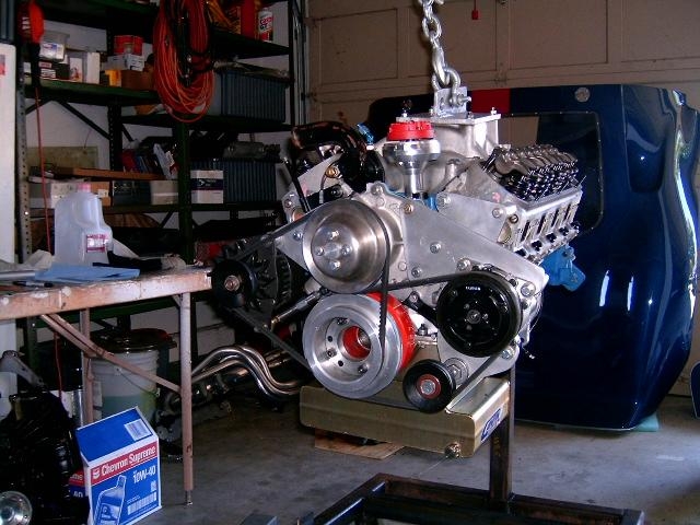

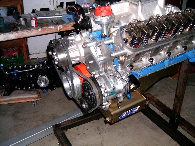

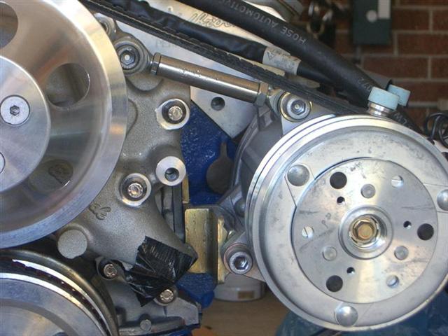

I have over the years collected pics of all sorts of parts and ideas that have been a help to me with my build. Here are some of those pics. Maybe you can find one that will help you.

Thanks Bill and Fran
I have downloaded those great pictures and will use them as a guide for fabricating my setup.

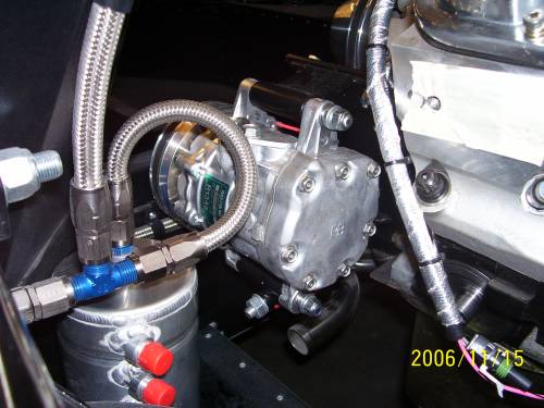

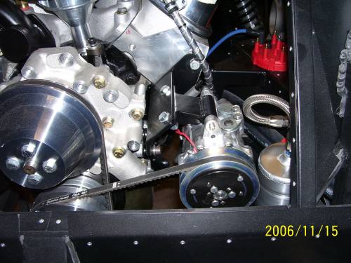

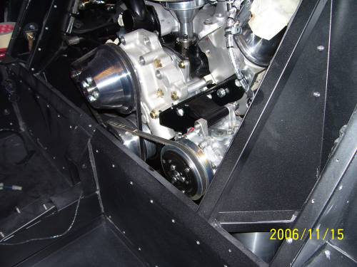

Here are some pic's of my aircon pump set up
Steve
