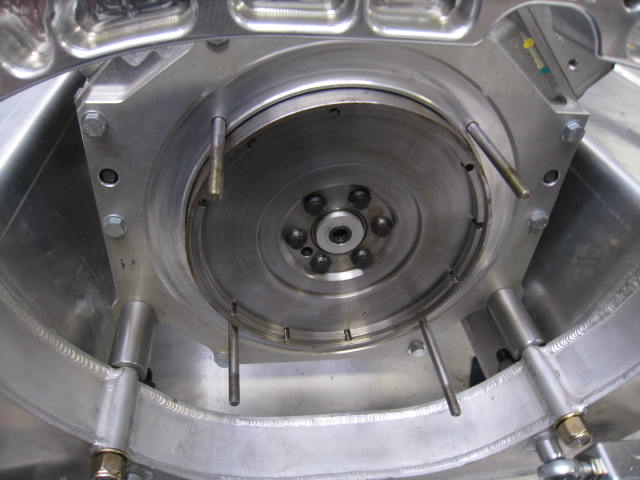

Flywheel should look something like this--( Fran should be able to provide all this info, I would've thought ??)

Give Fran a call for all those parts ( flywheel, clutch, starter) he has done the adaptation already.
