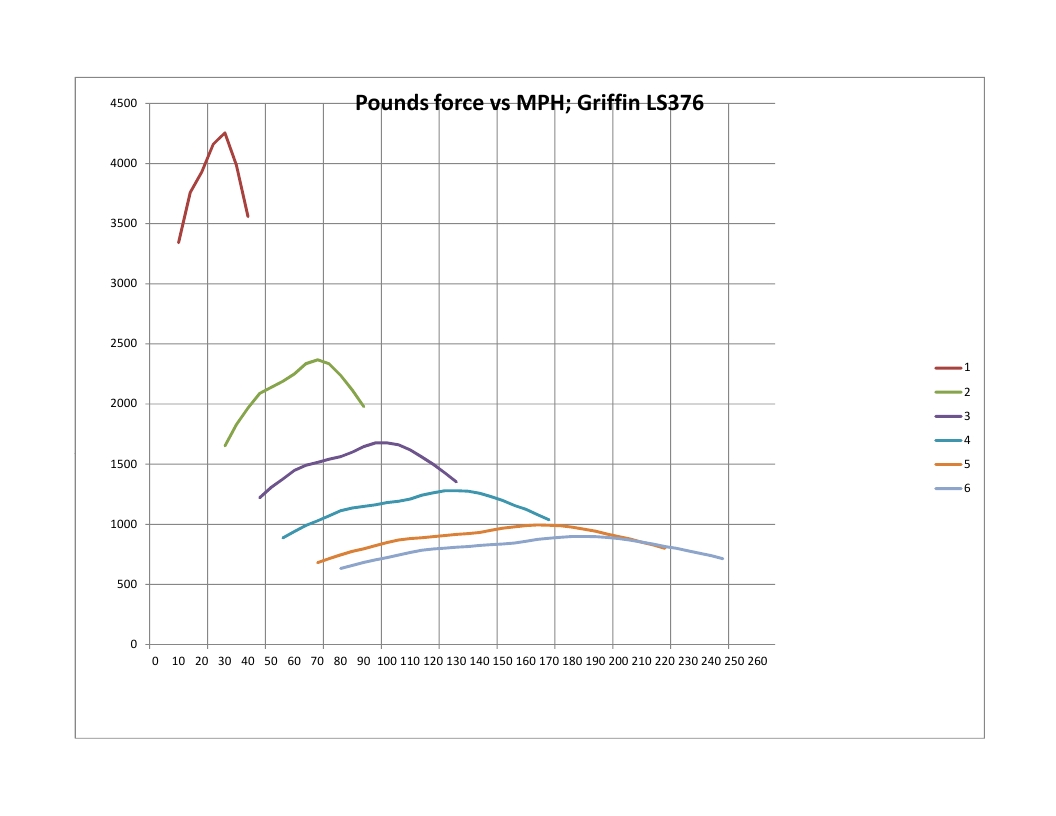

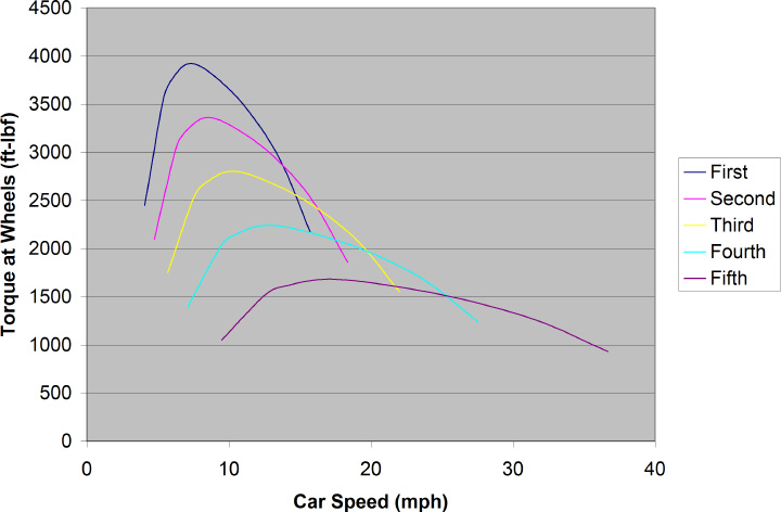

If you want to really understand that you need the torque curve for the engine(s). I would imagine those are around for the popular crate engines. Given that, you can plot max. rear wheel force vs mph in each gear and end up with a very intuitive visual model of how the gear ratios interact. You'll want to do this in Excel or its equivalent. Here's an example of the kind of chart I'm talking about:
(5 gears gets you to 40 mph? It's not my chart....)

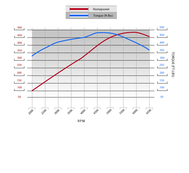

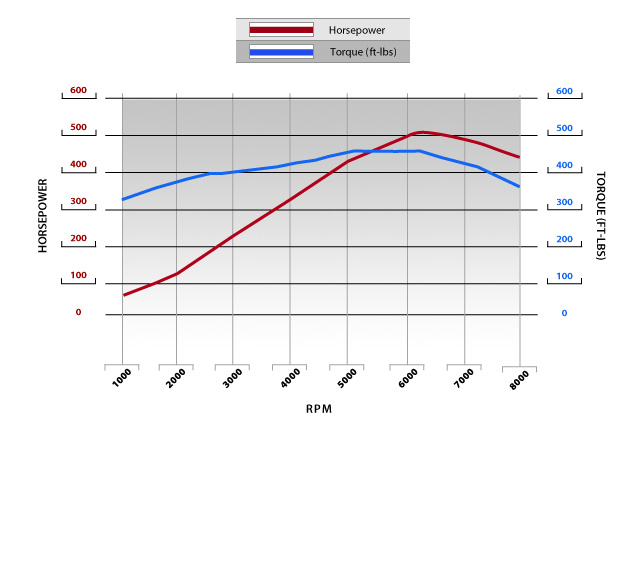

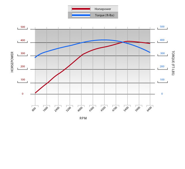

How is this; I found these torque curves for the LS3, LS376/480, and LS7 motors on the GM Performance site.

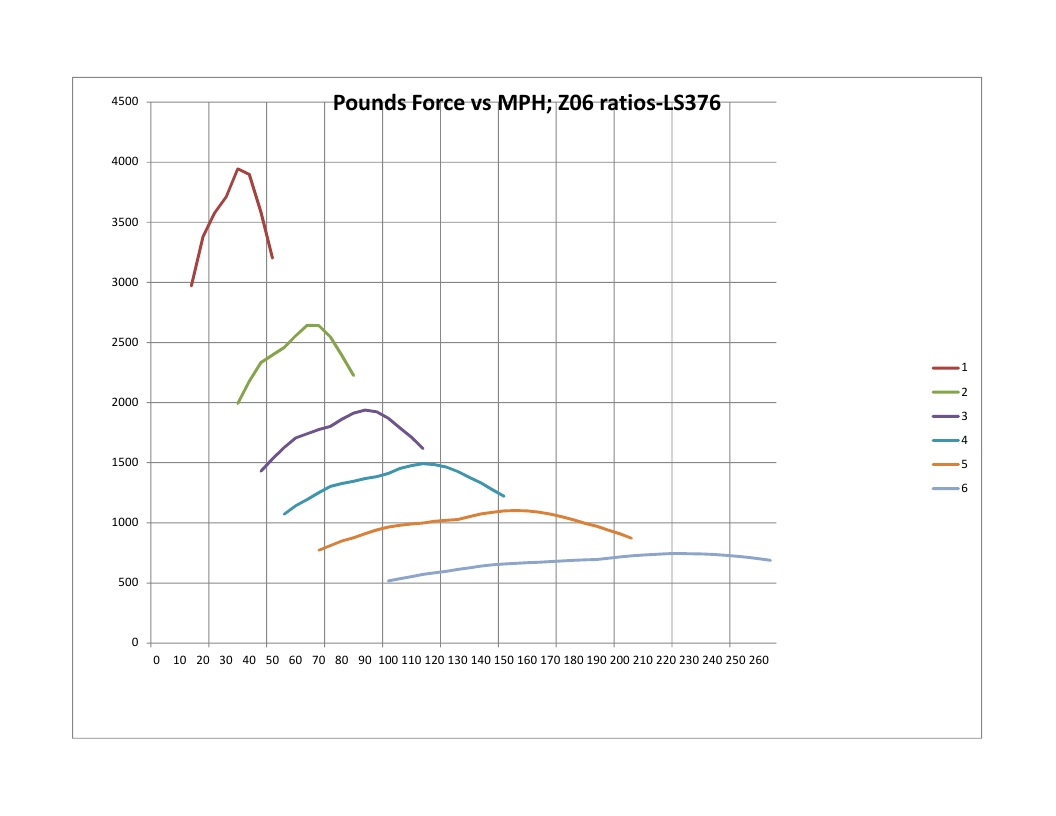

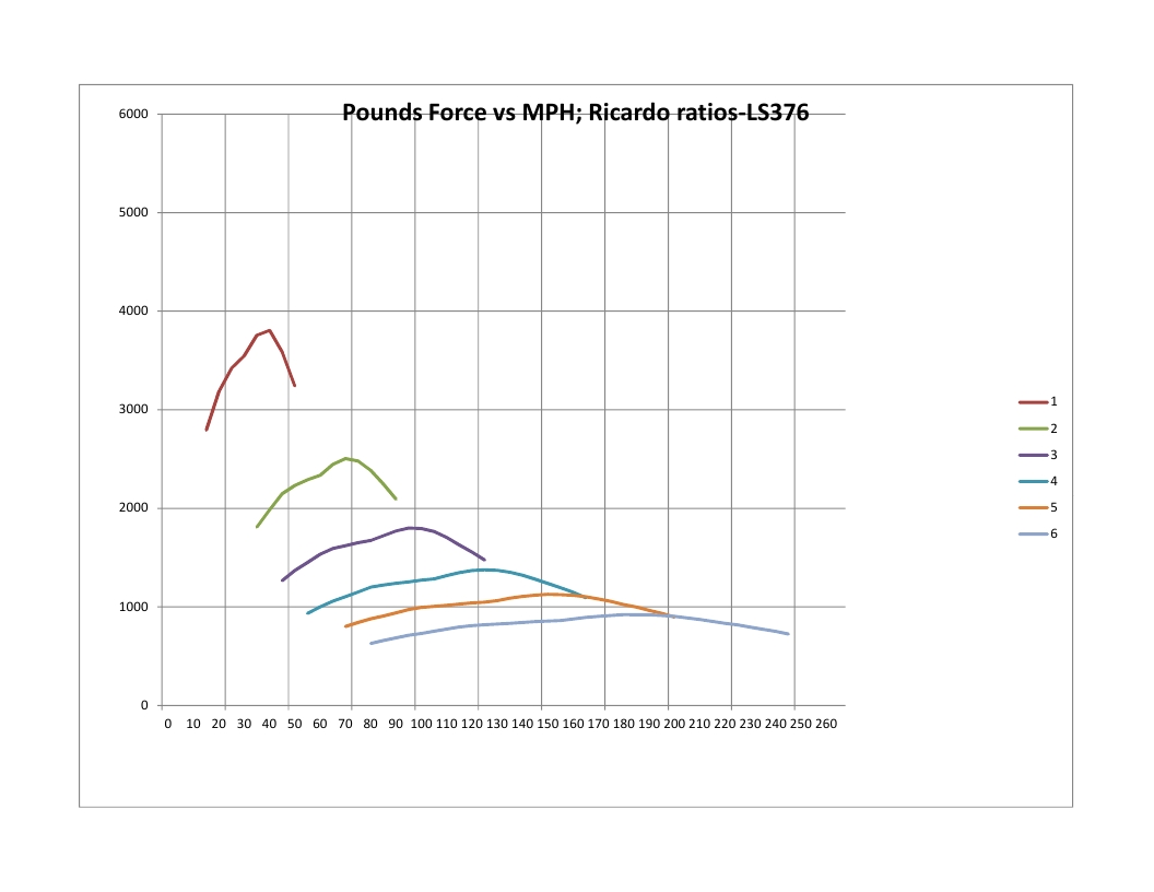

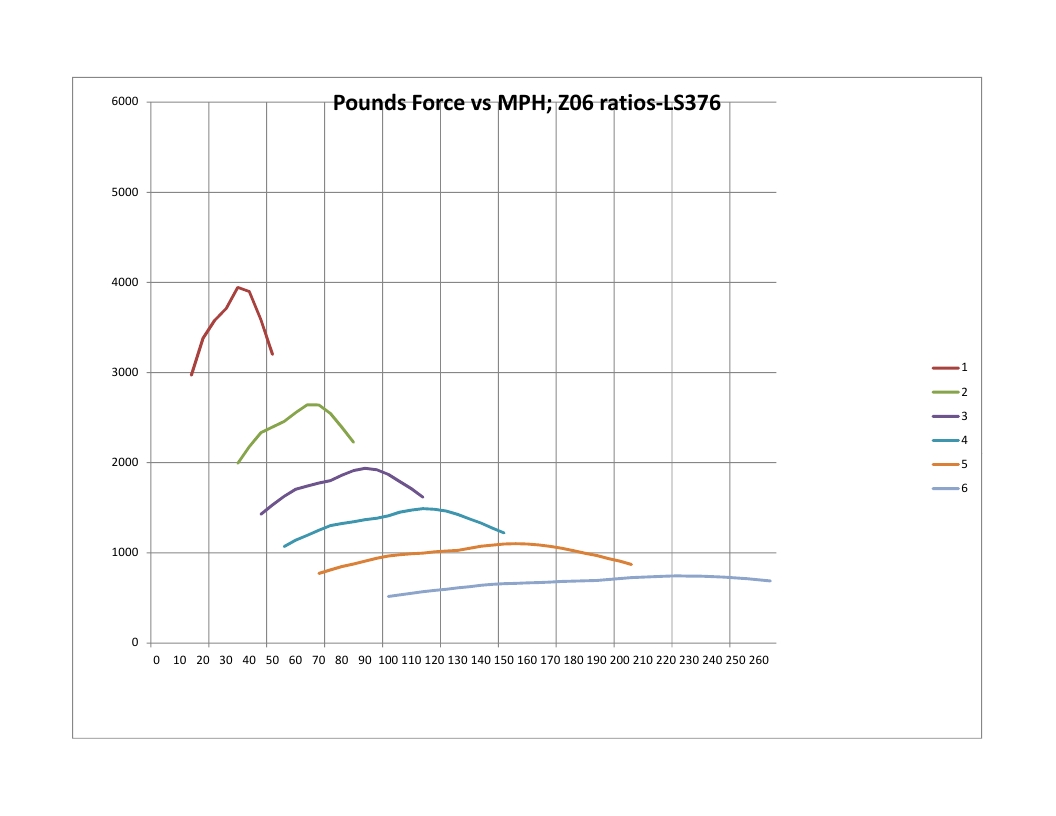

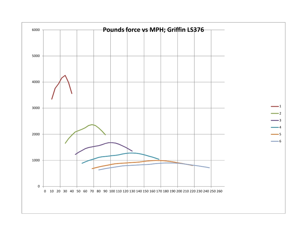

Here are the promised force vs. mph in gears for the three mentioned gear ratio sets, all behind the LS-376 torque curve:

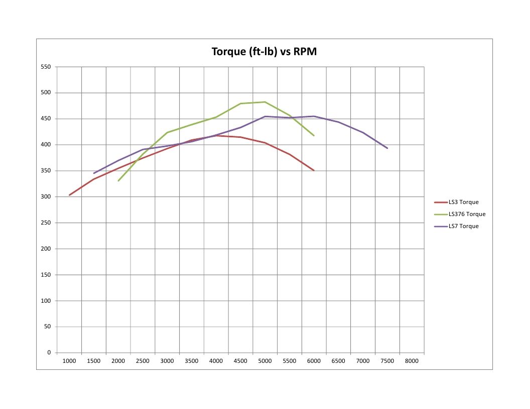

Also just for fun the three engine torque curves "de-marketinged" on the same axes.

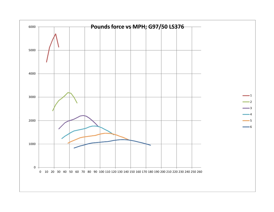

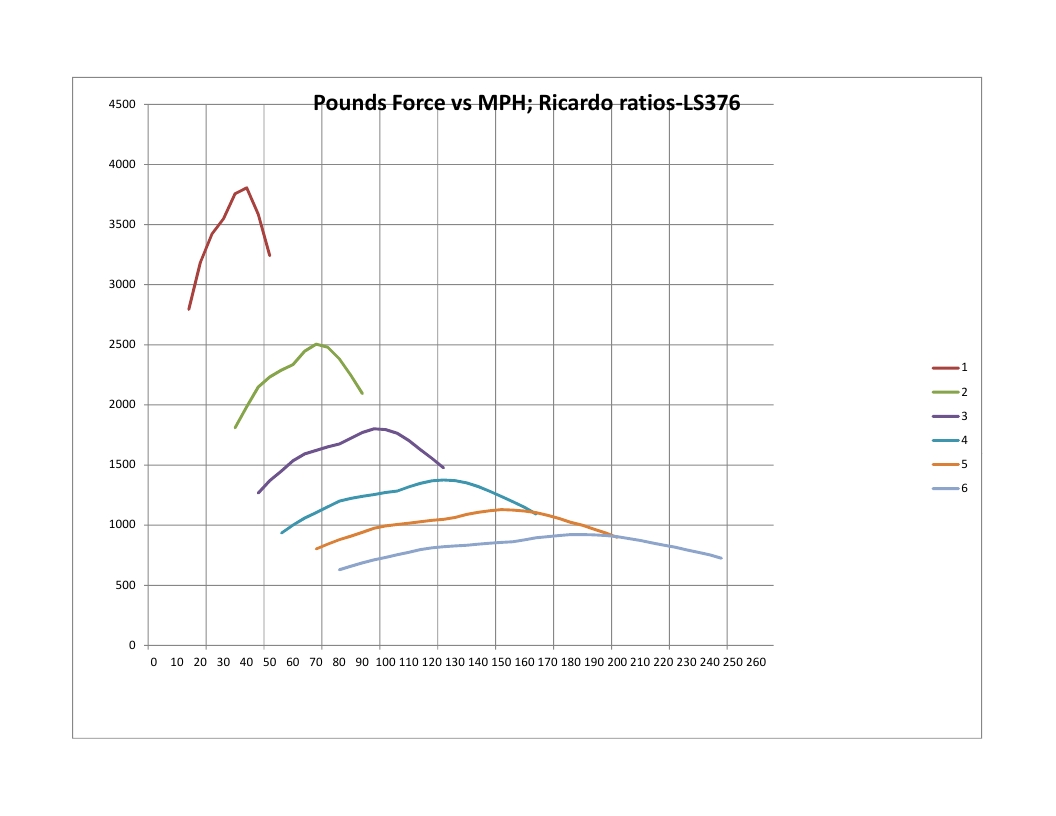

Alan,
Would you do a chart for the G97/50 behind the LS376? Thats what I have and it would be really helpful.
Sure; what are the ratios and tire size or diameter?
BTW the LS376 torque curves stopped at 6,500. Is that the redline for that motor? If not it would make the curves more "realistic" if I had data running all the way to redline.
Ooops, ratios right there in the other spread sheet.... back in a bit...
OK here are all four charts now including the G97/50; I rescaled them all since the P-box raised the bar on stump-pulling, topping out at almost 6,000 lb in first.
