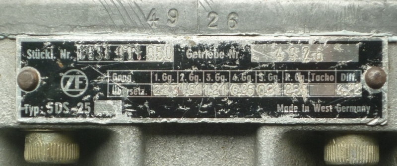

Hello friends,I have a ZF Transmission,and wish to know how can be 100% sure if it belongs to a GT40. With photos from the Identification Plate and from the dissasembled transaxle can be enough to certify it?

My request is whether it has been flipped and suitable for use in a GT40 as an Original Factory part
I have a photo from the ID Plate as shown in attachment
I am accustomed to seeing the dataplate affixed to the shifter box cover. I know on 1980s production gearboxes, it was attached directly to the side of the case on the opposite side of the shifter, which is what you appear to show. However your tag suggests it's a first-generation gearbox. Contrary to what Julian says above, there technically was no /0 version. The original gearbox was just the 5 DS-25. The later versions were 5 DS-25/1 and 5 DS-25/2. There were several different /2 variants with wildly different specifications for the Pantera, Maserati Bora, and BMW M-1.
I believe yours is an original 5 DS-25, which would be configured to run in GT40 orientation. It is a relatively fragile thing, very rare and expensive compared to a more common later version.
What are you wanting to do with it? How about providing more photos to help us identify it positively?

As Mike says it looks to be an early ZF from the ID plate with the shorter 0.84 5th used in early variants and thus it should have the diff oriented for GT40 use.
