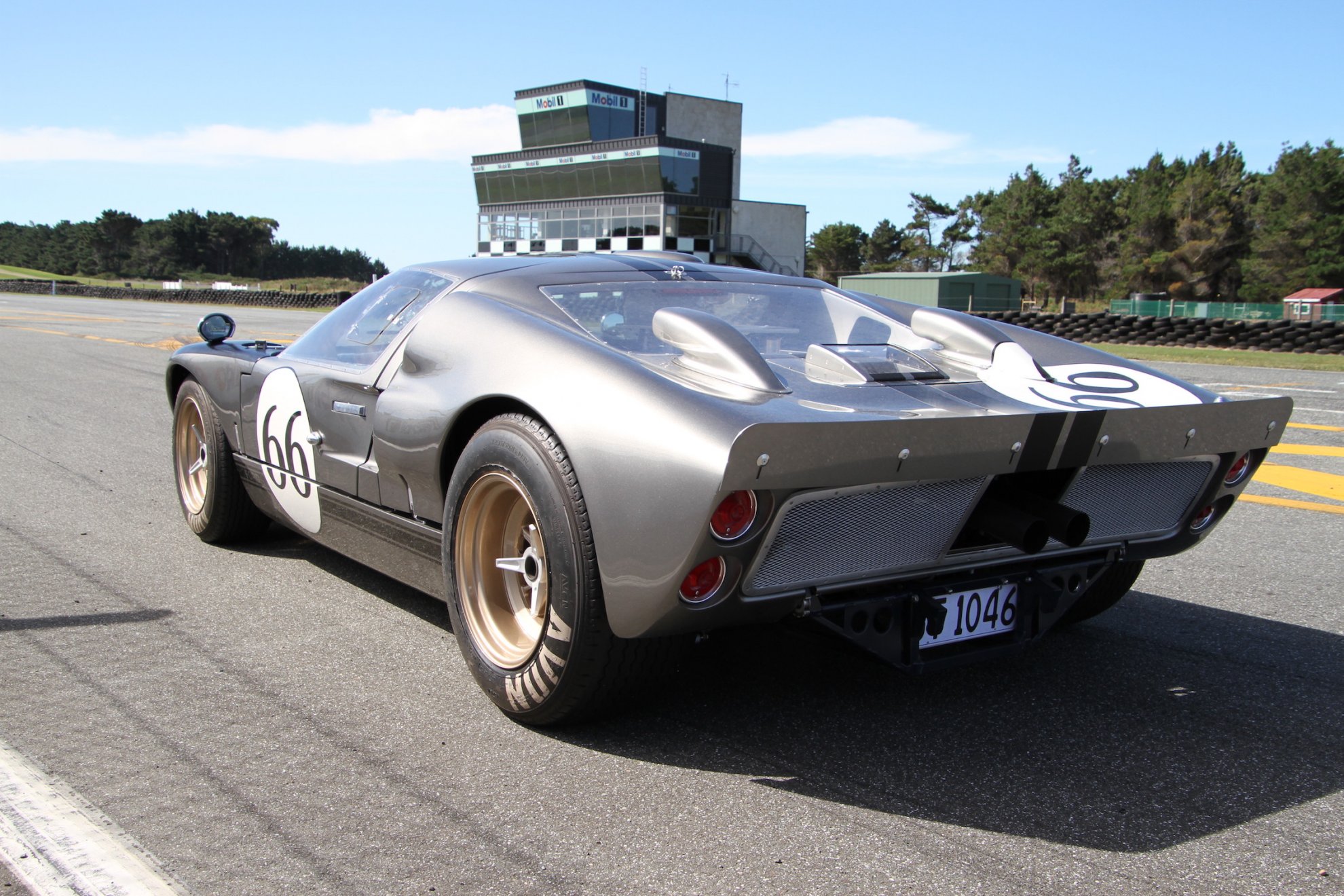

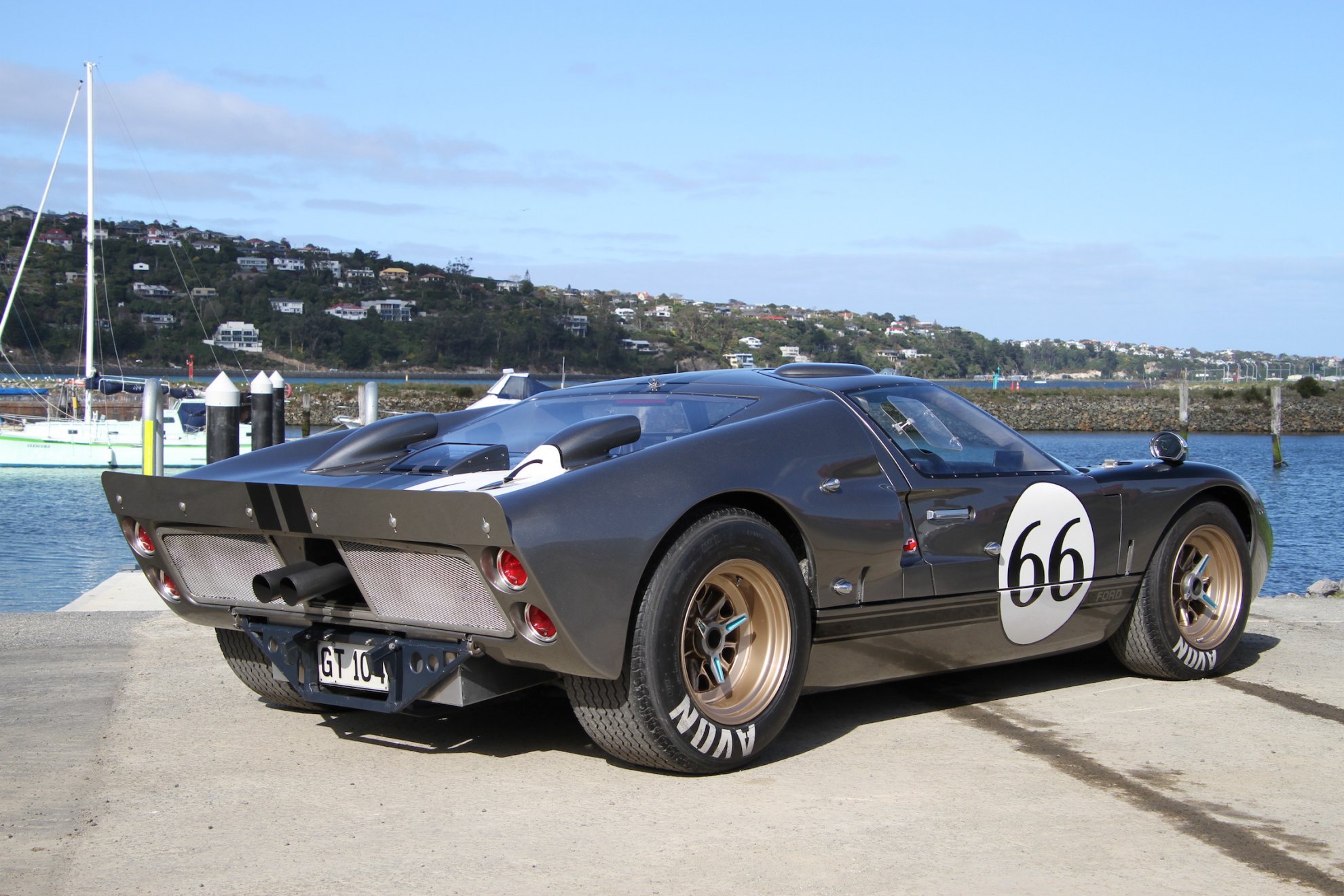

For what it's worth, these are 295 Avons on 12" Image rims.
Andrew
Brian, they look amazing thank you for sharing the photos!! What width are you running on the front? How bulbous are the actual tyres? Do they project past the line of the outer wheel rim?
I'm measuring up for offsets and very mindful I won't want to specify a too aggressive offset for then to have the tyre project past the outer lip and foul the arch.
295’s on 12” rears here too, Avon changed (reduced) their Recommended wheel width a while back as I understand it but the tyre is the same, yes they are fun to fit but they look the nuts...
Brian Stewart
Fronts are 215/60R 15. There is enough "balloon" in both the fronts and the rears to not have the rim proud of the tyre. Paul's photo above shows this well.
