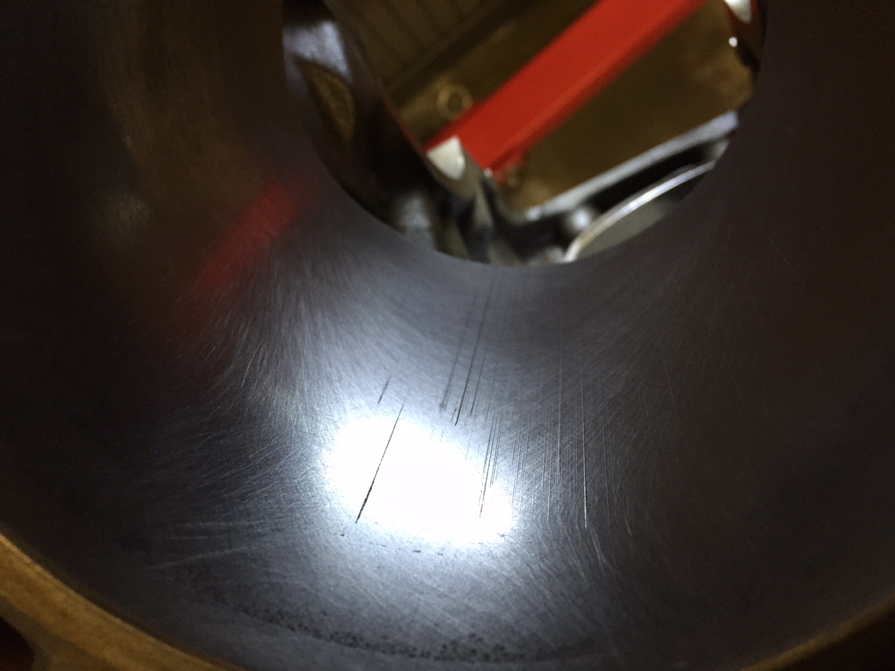

Hi Guys,
Found on 2 cylinders some rather deep scratches which I can feel with my nail.
Also with the dial bore guage, they can be felt with the probe.
Since this block is already 40 overbore, don't want to go for the 60 overbore.
I tried to sand the scratches away with 400 grid and later with 600 grid in a cross pattern movement but they are too deep. 600 grid looks to me too polished for the oil to stick on the grooves.
Could honing with a 240 grid flexhone resolve the scratches ?
Or is this a "game-over" for this block ?
(Block should survive one year normal roadconditions)

Since you're planning on building another engine down the road - I would just ball-hone the cylinders, gap the rings at .015" and call it good...
Unless you've changed your plans that is...
Either way, I have pulled some pretty good running engines apart that had those scars or worse.. Granted a perfect engine would have nothing more than a light cross-hatch hone pattern in them..
Hi Guys,
You will be surprised how sensitive a finger can be to imperfections in a surface. I doubt very much if the scratches are as deep as they "feel" and considering that quite a few of the bores are undersized by a few thou it may pay to have the block honed properly to size, the scratches may well disappear. I know you dont want to spend on this one but you may end up with a healthy little runner out of this if you dont cut corners at this stage.
