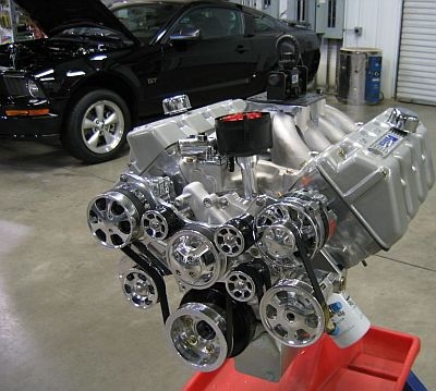

These are the Jon Kaase heads on a 580 inch 429/460 based motor.... Look like a Boss to you? :)

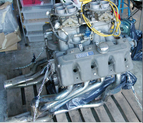

Oh, they got properly developed alright - just not by Ford. You'll find them here in the US from time to time in proper trim and they make a bunch of hp. The ones that originally came in the few cars they were in though, no, those didn't do the motor justice with power output. Those cars are are so valuable now though that owners wouldn't dare lay a finger on the motors. I've been following a Boss 429 build up in a 70 Torino over on Ford Muscle, good stuff. Motor pic follows but they haven't got into the serious development of the engine yet.
