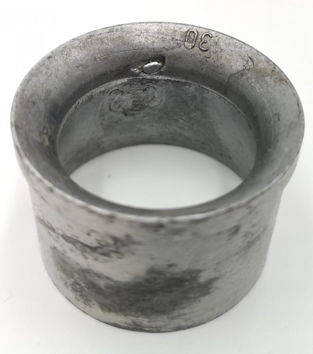

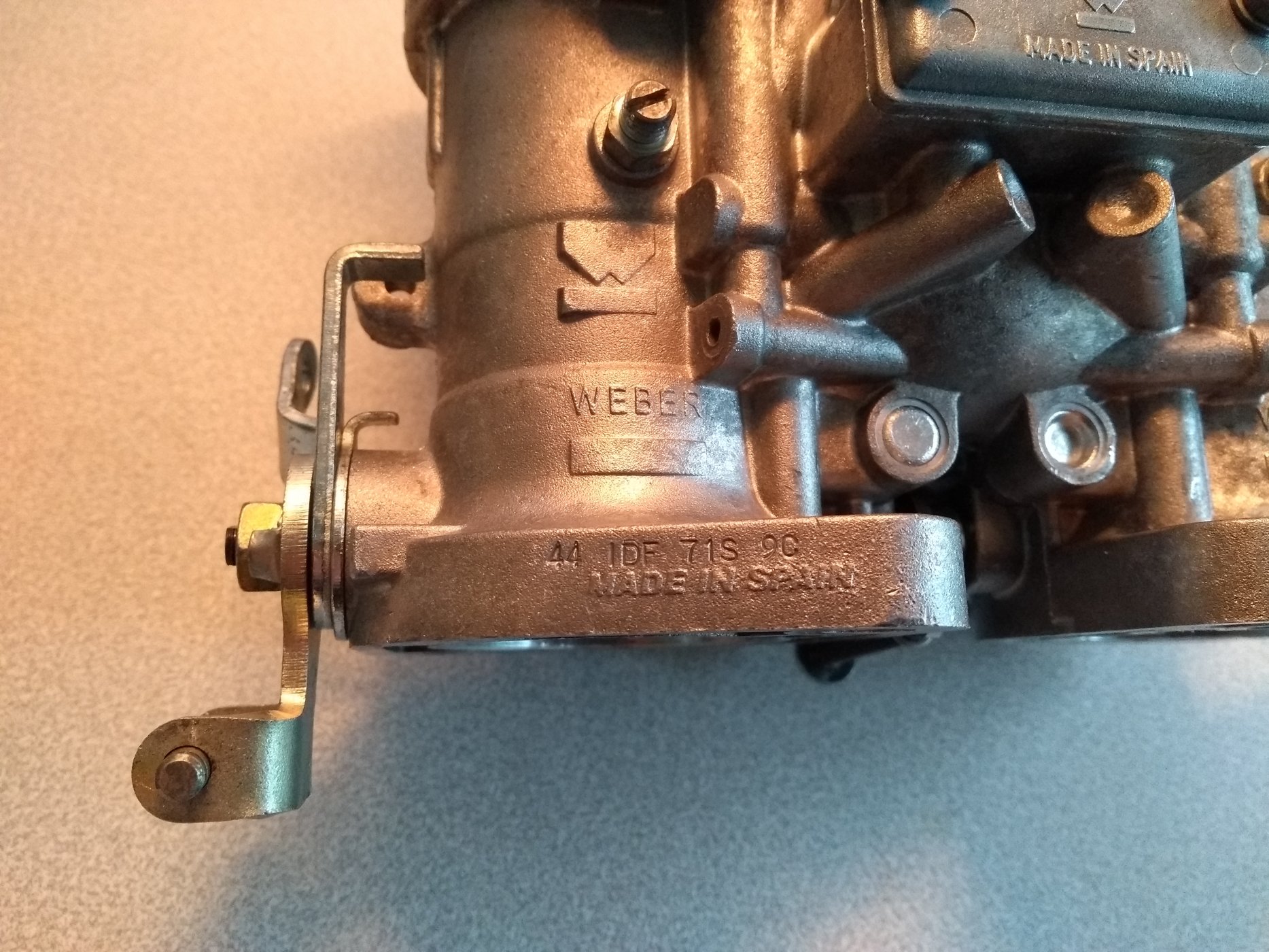

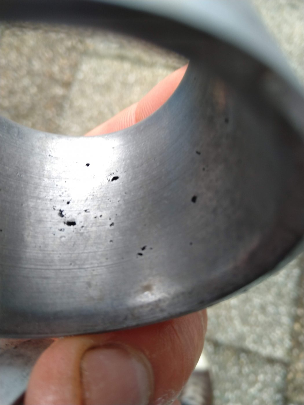

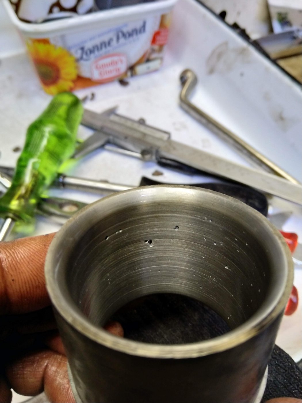

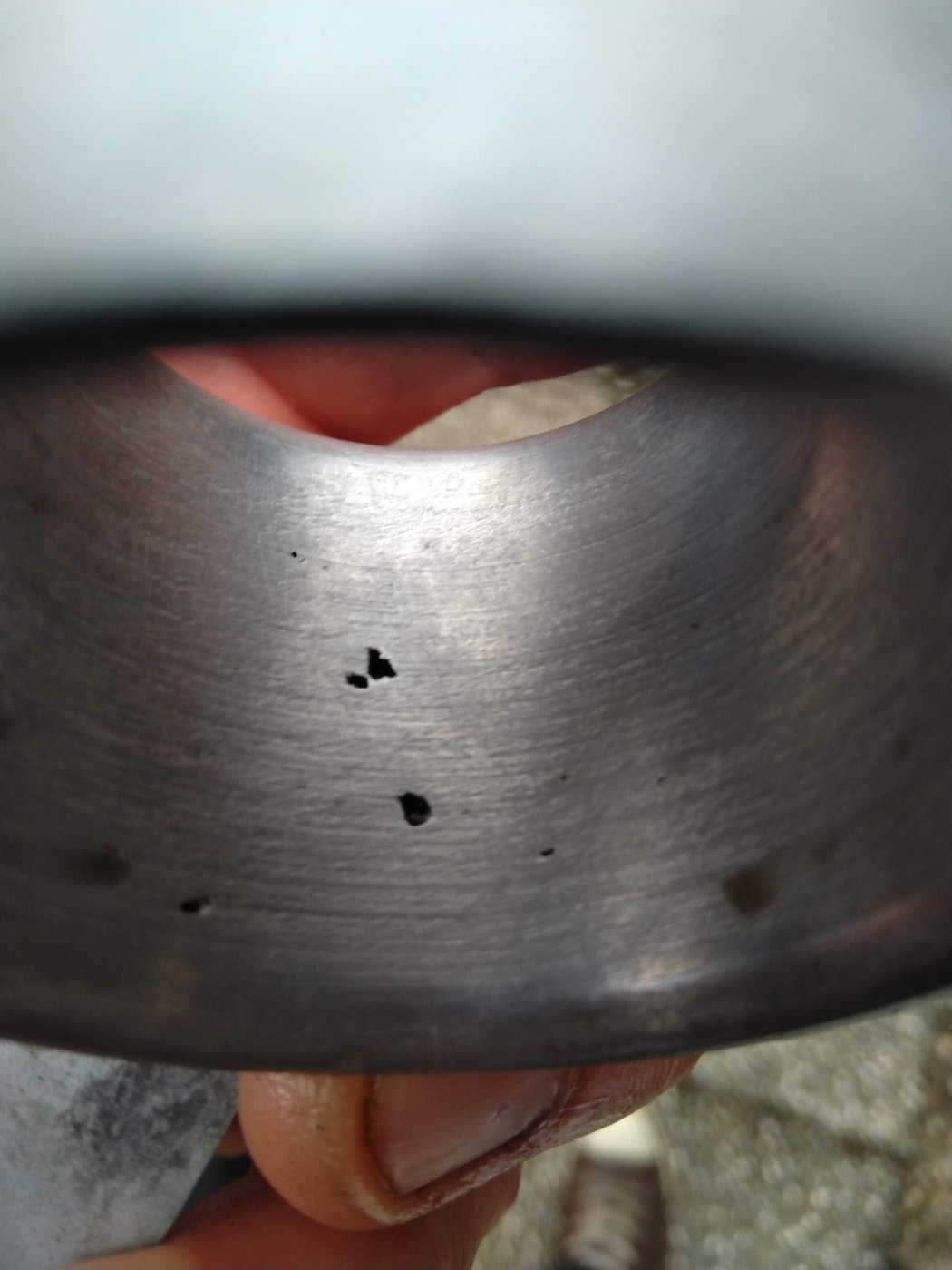

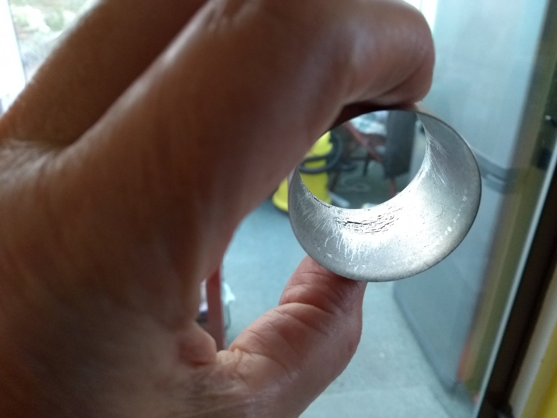

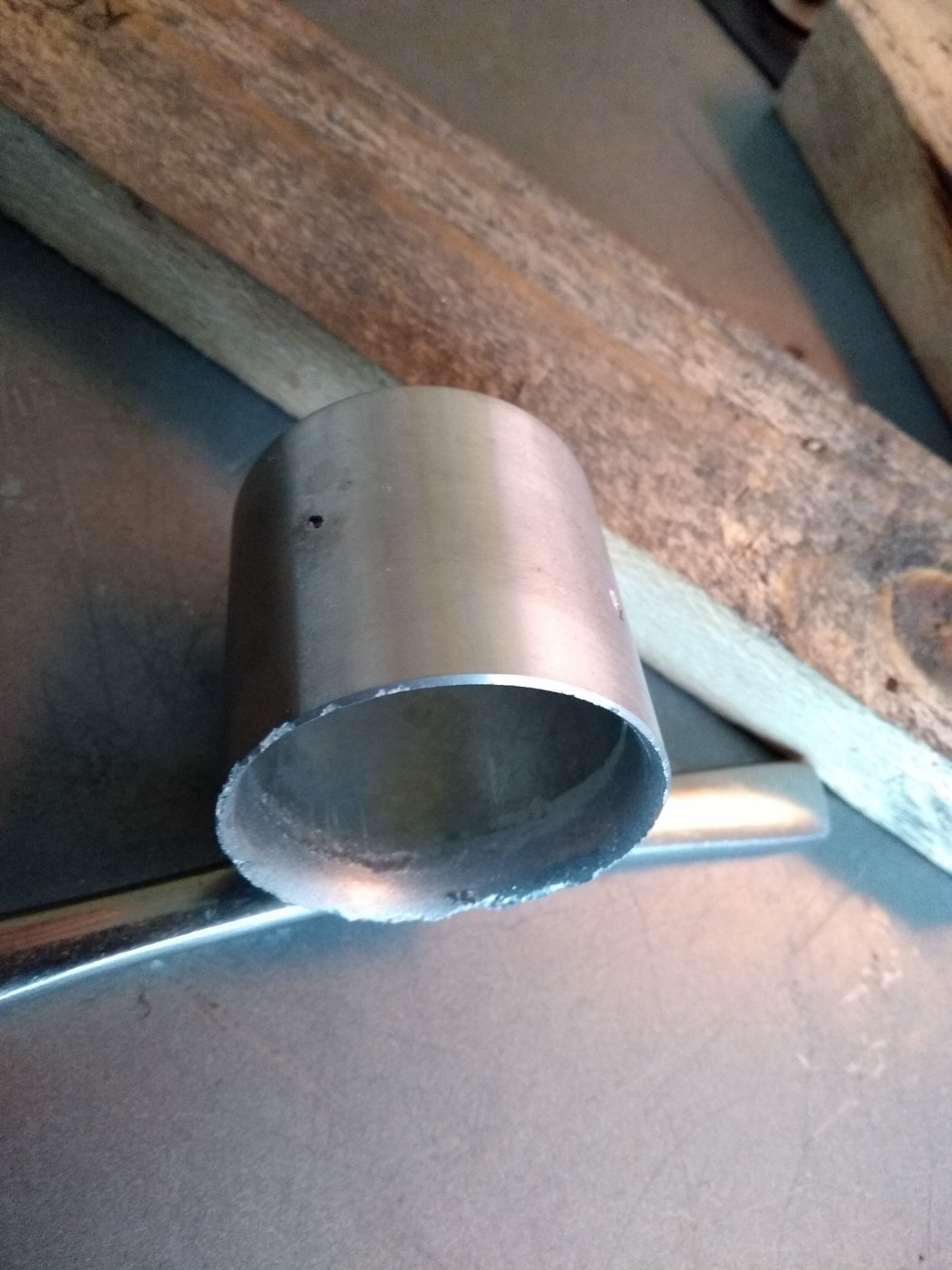

Since the Webers started to be made in Spain the quality has dropped. I recently rebuilt some 44IDFs and was surprised at the quality of some of the castings as they were very rough. Some of the main venturis were so bad that I suggested the owner bought some new ones. When they showed up they were just as bad. I spent a lot of time smoothing out the main and the auxiliary venturis to get them into some sort of shape so they could work correctly and have smooth airflow through them. I, at the same time, did some original Italian 48 IDAs and they were very nicely made. This accounts for the prices of the original Italian carbs being what they are. I know which ones I would want.

Pics of the poorly cast venturis on the 44 IDFs.

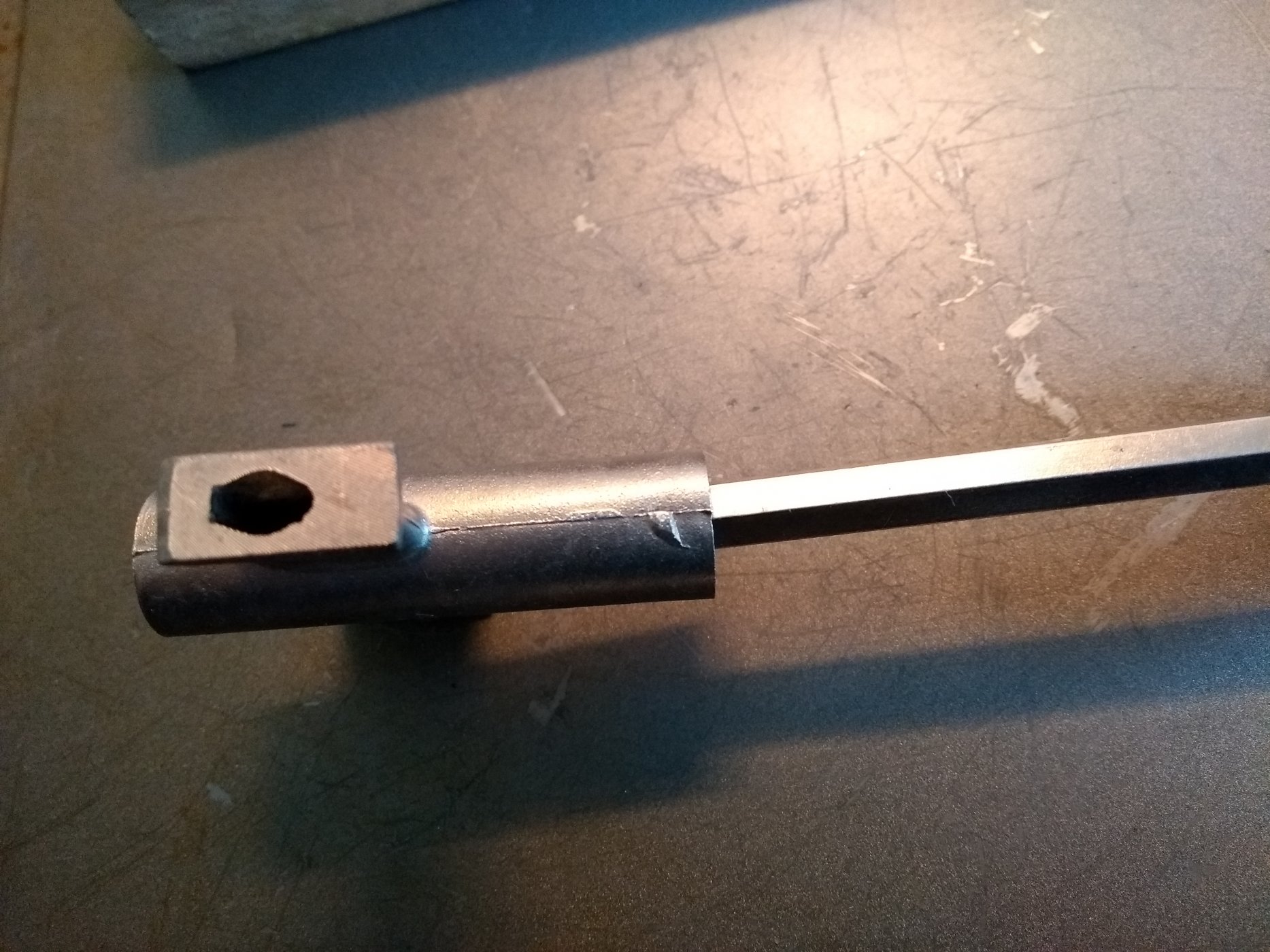

I bought two NOS Bologna ones a while ago as spares and at that time I thought everything looked good and put them away.
Last year I got them out to change out the jets and put better gaskets in, only to find the castings were identical but the top fuel pump jets were made from Mazac with a press fit silicon ring arrangement to locate them into the casting and I was expecting the more original brass nozzle/banjo screw type.
When I checked, the throttle cams were not identical and also pinned in a different orientation on the spindles.
The venturis also had a different fin arrangement.

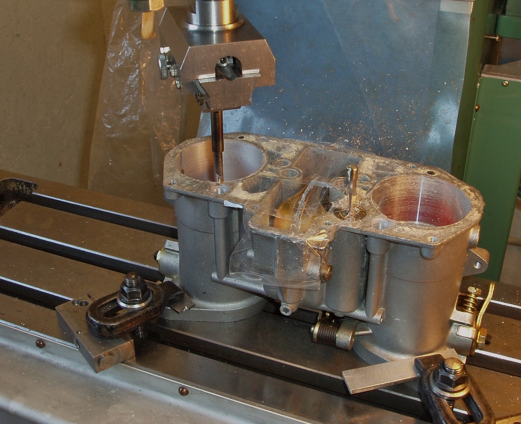

I could go on but anyhow these were dissimilar to my 1970 set so I went about "upgrading" them by fitting old style spindles and boring the tops out to take threaded inserts for the traditional brass pump jets.
So really it's a minefield and I would not recommend buying old used ones either unless you have proof that the internal are good and clean.
